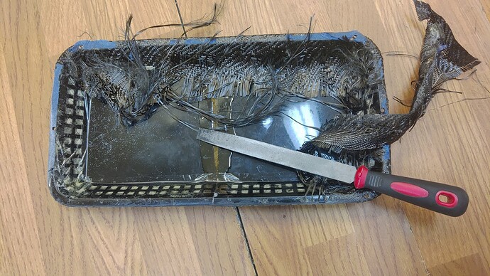

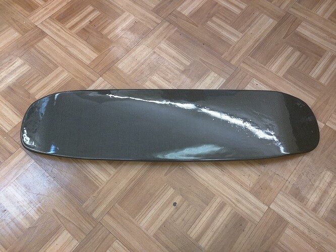

Using acetone to make board tacky to make adhesive stick better. I did this back in 2017 so the board is already done just showing pics of the process.
Took off the excess with a file.
IMG_20170629_201035-ANIMATION
I sanded the epoxy for a second coat.
This is the second coat.

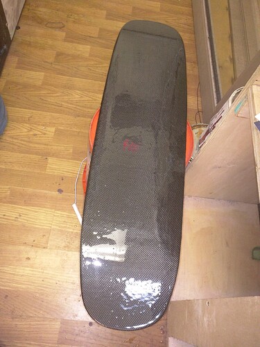

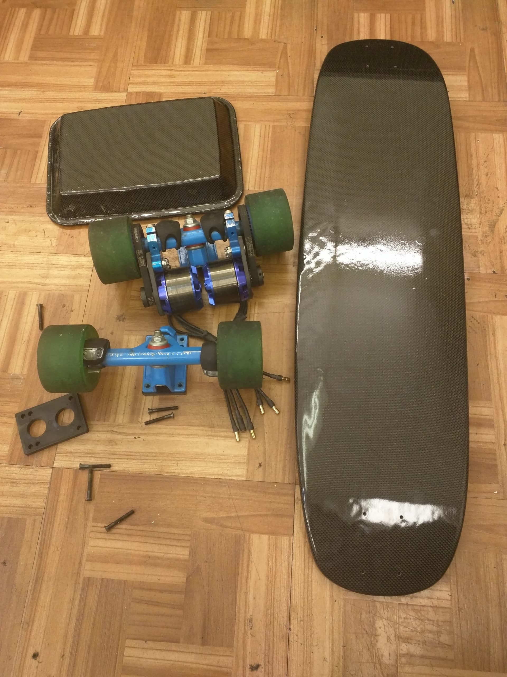

I was going to use this board as an up grade to this setup.
Here are the pics of it when assembled bet never went beyond this point.
IMG_20170903_064340-ANIMATION
I’m curious to know what your truck angles will be once mounted to the tails of the deck.
@monsterbuilder Truck angle seems to be at 17 degrees.
Is that the angle of the deck? If so, what’s the angle of the baseplate itself? Are you using 50’ baseplates?
@monsterbuilder This is what underneath looks like.
Gotcha, didn’t know you were running channels. Your previous picture showed RKP, so I was a bit confused.
17’ might be fine for the rear. You will probably want to use an angled shim for the front to increase the angle.
@monsterbuilder yea, I was just showing the history. Of what I was going to do with this board on another setup. Sorry for the confusion.
Take two Hamburger baskets and cut off the tabs for the enclosure
Then cut off the ends of each one.
Then I tape them together.
Then epoxy the two together to make the enclosure
I put scotch tape around the sides to keep the epoxy from dripping through the basket while layering the carbon fiber.
Spray the basket with upholstery adhesive.
Cut the carbon fiber twill, enough to over cover the basket.
Then nip and tuck as needed.
Take Philip head screw and attach twill covered basket to masked board.
Laminate thin coat over basket and let dry
When dry and cured take out screws and shave off excess on the inside.

Is just one layer of carbon and epoxy strong enough to protect the battery from road debris?
This is 10000000 IQ wow I love it
@dasman I’m not finished coating the enclosure. The 1 layer of carbon fiber is sufficient, the basket itself adds a layer of protection. I’ve done it this way many times it is tough as hell when the process is complete.
