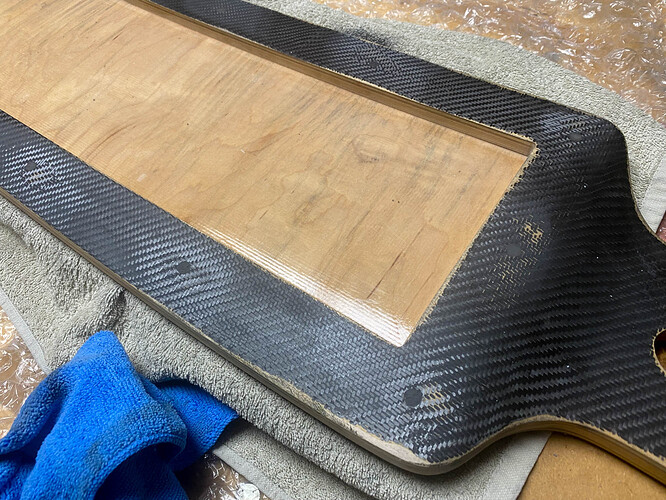

It had a few issues, the deck itself has been shaved a bit so the loop key and charging port could fit in, also the threaded inserts was in bad shape.
I have removed everything, filled it with epoxy, wait to cure and of course level it flush with a lot of sanding…

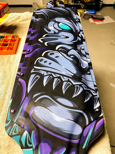

Next step was to apply skin to the deck and enclosure. My first time doing the fabric on enclosure, it came up much better than expected.
Since this is a bottom side of the deck, scratches are inevitable, so I went with matte finish. This is by far the most labor intense part of this journey so far. 320 roughness sandpaper, then 1000 and 2000. last 2 was done by hand.
Threaded inserts are next to be done, I have added one more screw on all sides so the raster of the holes would change. That way I will be drilling into the fresh wood instead of risking to drill into the old holes filled with epoxy. Also I got a little creative using the laser to align the holes better:

With that done, bottom side is finished. Once I am done with the top side, I’ll do a round or two of additional sanding to make it blend better.
