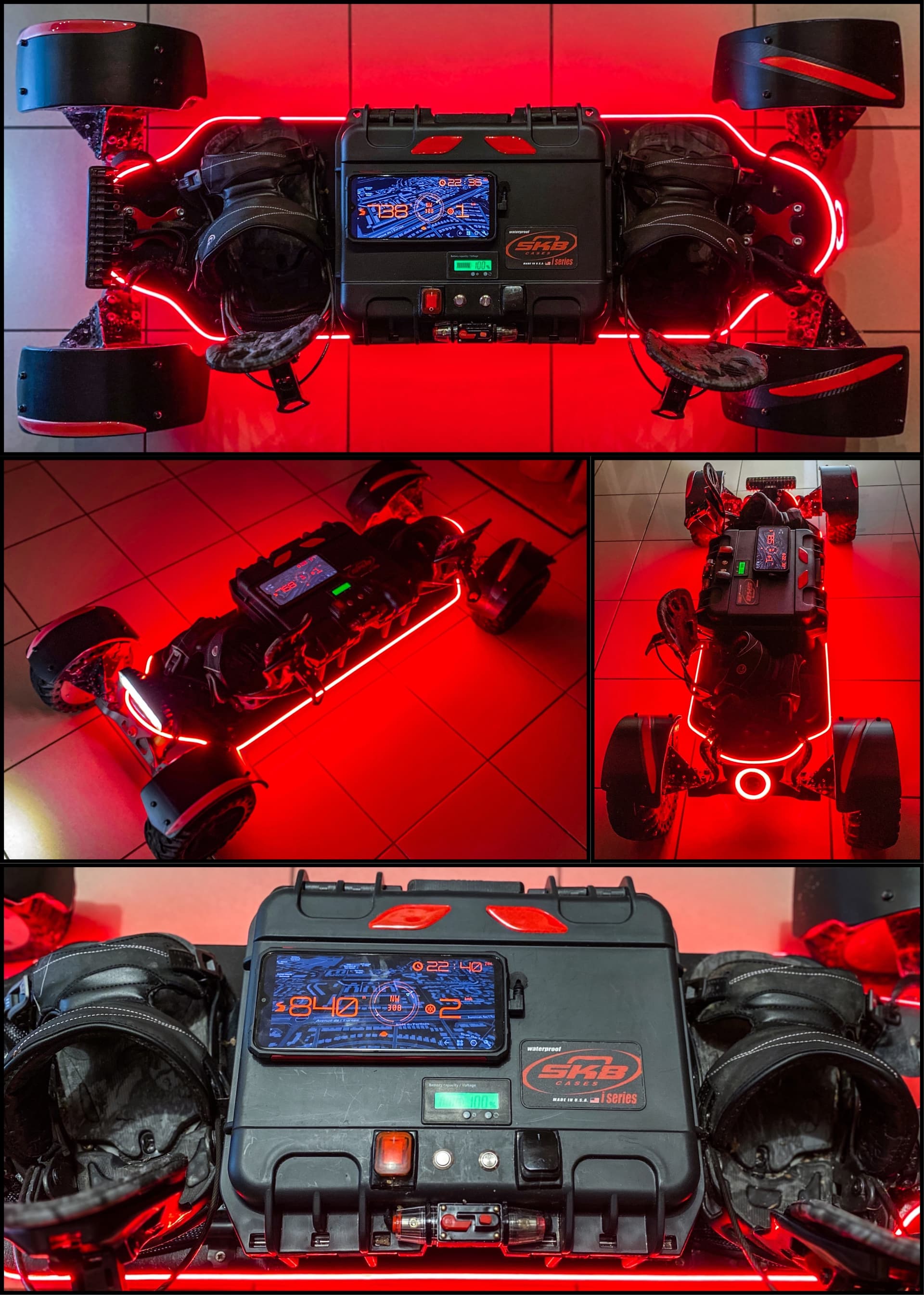

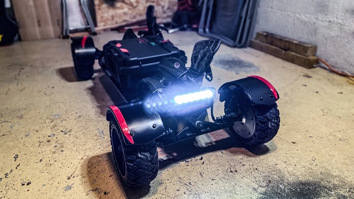

Hi, been making a 4WD e-mountainboard with hardware from offroad hoverboards.
Here are the specs:
Battery 12S (3x4s) Lipo 20Ah
2 hoverboard motherboards (reprogrammed)
4 all terrain hoverboard hub motors (8inches)
Power: 6KWatts in silence :wink:
Lights: front and rear
VMax: 50km/h
Range: 20km
DIY mudguards (PVC tube and metal frame).
Here’s the list of hardware parts:
  • 2 second hand hummer hoverboards: 180€
  • Deck: 120€
  • Batteries: 500€
  • Trucks: 50€
  • Eggshocks: 20€
  • Lights: 20€
  • Plastic Case: 120€
  • Screws etc…: 30€
  • Electric connectors : 15€
  • Cables&switches: 10€
  • Usb flasher: 5€
  • Remote control+receiver: 13€
  • Grip: 4€
  • Jauge and 45V to 12V converter: 5€
  • Batteries Charger: 60€
  • Snowboard Flow straps: 250€
TOTAL: 1400€
HummerBoard MakingOf
First Version ride
Ride with Supra
Offroad ride 2022

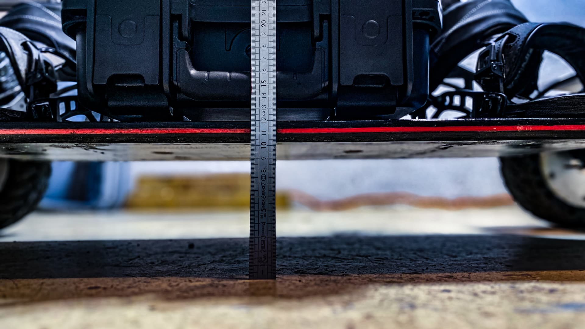

This month was a big transformation/enhancement moment: all batteries and electronics have been put on top of the board, and I lowered the board to gain in stability.
Here’s today’s last ride of the year photo :wink:

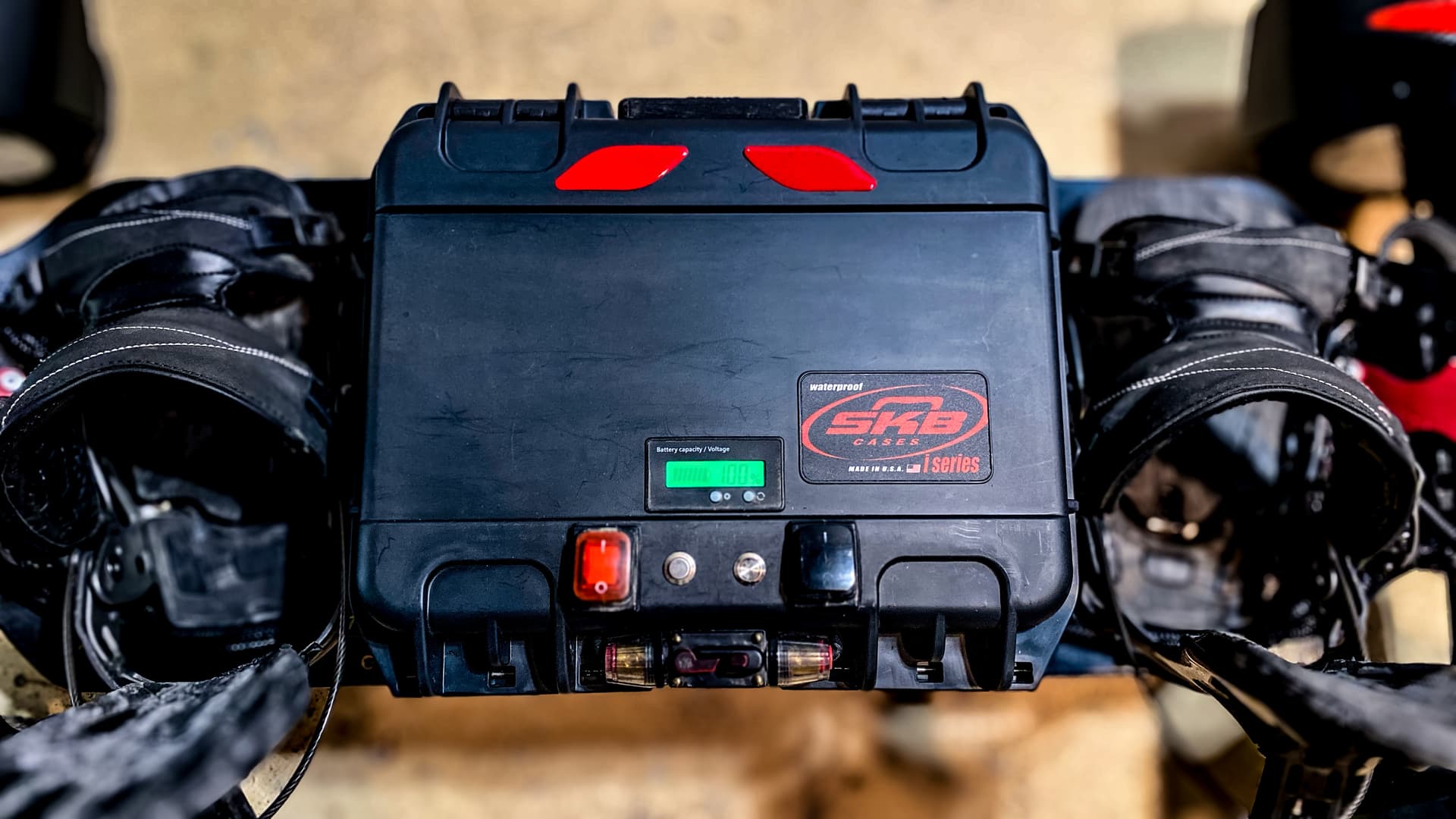

What are the switches and buttons on the case for? Looks pretty clean.
Interesting build with cool aesthetics :call_me_hand:
It should be part of every esk8 race, that’s a fantastic idea.
Switches: master power on, lights, each hoverboard motherboard power on, fuse.
