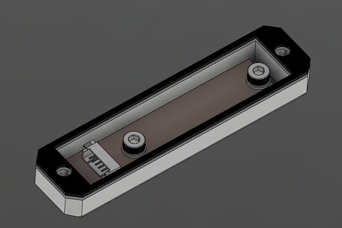

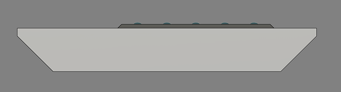

And one for under mount enclosures as well, here’s the skinny (118mm x 16mm x 5mm) designed to go with 5.5mm barrel ports and a Unity power button. I put all the wires in the same region so it’s easier to make holes, and it uses 2x M4 pan heads. Conveniently, this one prints supportless
I will be sticking this along the side of my SS Evo enclosure if I get my hands on a nose LED

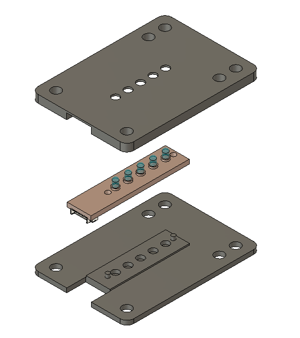

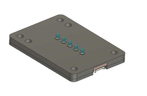

Entry 1: Truck Mounted Voltage Display
Specifications:
Fits new school & old school truck bolt patterns. Uses M5 Socket Head bolts and washers.
L: 80mm
W: 60mm
H: 10mm (w/o gasket)
Mounting Fixture:
Hoyt Voltage Display Design 1.stl (238.4 KB)
Gasket:
Hoyt Voltage Display Design 1 Gasket.stl (63.4 KB)
Note: Can be printed with minimal support, or none, depending on how good your printer is at bridging.

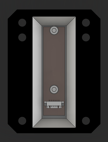

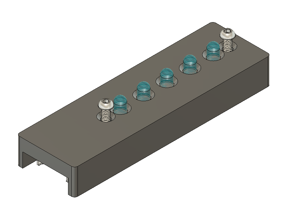

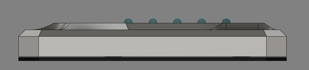

Entry 2: External Enclosure Mount / Case Mounted Voltage Display
Specifications:
Fits / can be mounted to any flat surface. Utilizes two M3 screws to mount the housing to your vehicle/device. Included in the design are two receptacles for M3 heat-set inserts, I use these all the time, and they’re an excellent solution for mounting 3D printed parts. This design minimizes the height for mounting in order to keep the whole design close to the enclosure.
L: 75mm
W: 18mm
H: 11mm (w/o gasket)
Mounting Fixture:
Hoyt Voltage Display Design 2.stl (913.5 KB)
Gasket:
Hoyt Voltage Display Design 2 Gasket.stl (22.7 KB)

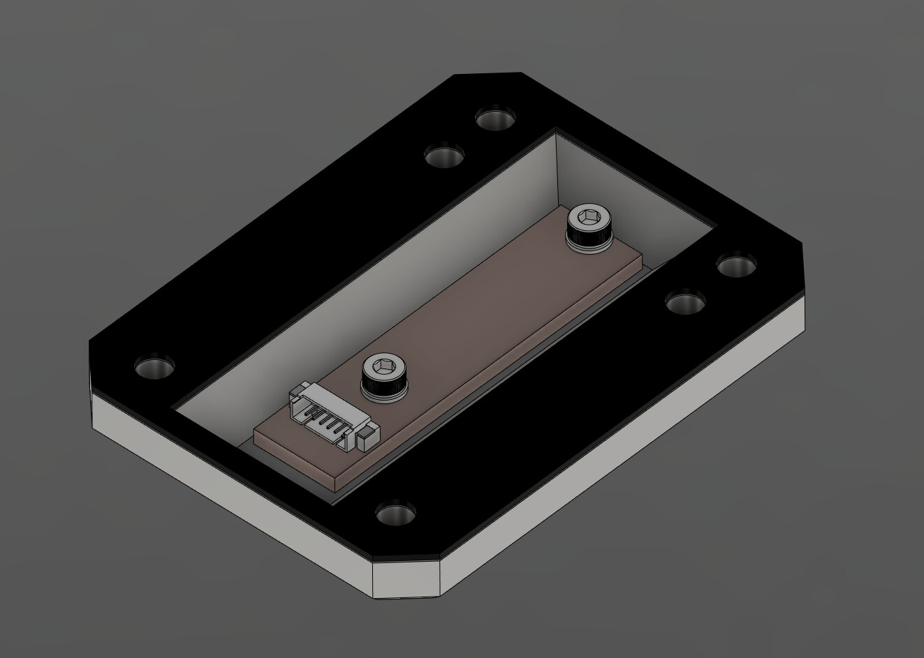

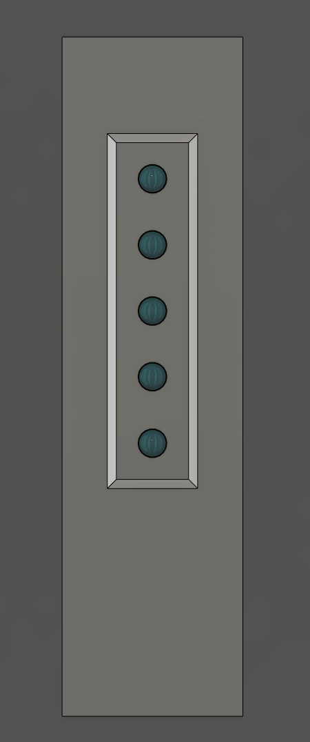

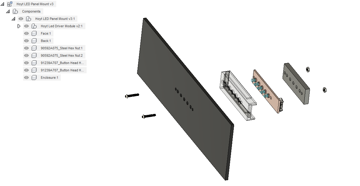

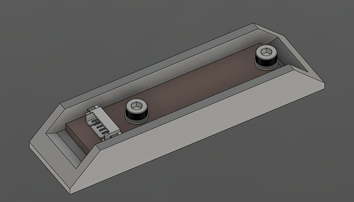

Entry 3: Internal Enclosure Mount / Case Mounted Voltage Display
Specifications:
In comparison with the other enclosure mount, this mounting fixture mounts to the inside of the enclosure. My intent is for this to be glued into the enclosure using either silicon or hot glue. Because of this, there are no screw mounting locations. In order to install, simply cut a rectangular hole for the raised area to fit through, and glue the fixture into the enclosure. In case of damage, the 3D printed fixture may be permanently mounted into the enclosure, and discarded, with the voltage indicator being removable.
L: 75mm
W: 20mm
H: 12mm (incl raised portion)
Cutout Hole size:
L: 40mm
W: 10mm
Mounting Fixture:
Hoyt Voltage Display Design 3.stl (114.3 KB)
Note: Can be printed with minimal support.
Oh, that last one is super cool!
