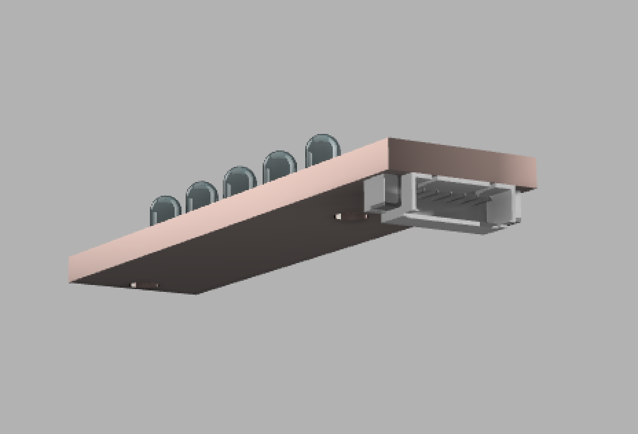

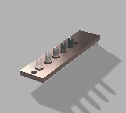

Here you go folks
Dimensions are accurate, photos are not quite (moved connector back where it should be)
connector is JST GH 1.25mm
PCB in rose gold as per Hoyt standards of course :stuck_out_tongue:
Hoyt Led Driver Module .f3z (492.9 KB)
Hoyt Led Driver Module.step (650.2 KB)
