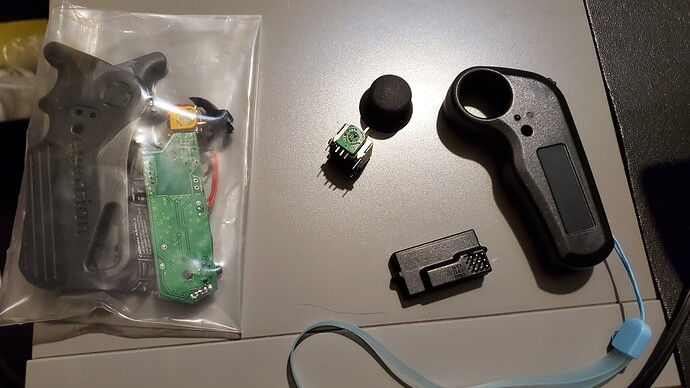

I have a dissected but functional enertion Nano x remote and a winning remote. I believe the receiver goes to the winning remote but I’m not 100% positive so I’ll send both just to be safe. Only thing missing is the cable but I may have an extra laying in the bottom of the box of parts. Pm me your info.

Thanks @Venom121212 for the remote! It’ll be a big help, I appreciate it A LOT.

@Venom121212 Got the remote!

@Venom121212 It was indeed not the taken apart remote, got it working pretty quickly :slight_smile: Thanks so much!!!
