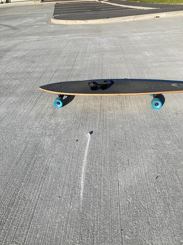

Honestly? Don’t overcomplicate it. A physical brake is always better than an electrical one. Case in point:
(Not my pic)
Just chock it up with something small when you’re parked, and remove it when you’re ready to go.
Just put your remote there :grin:
