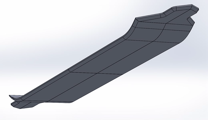

I just got 165 of the exact same cells and debating making a 20s6p pack for my raceboard but idk.

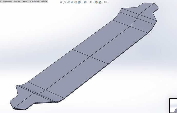

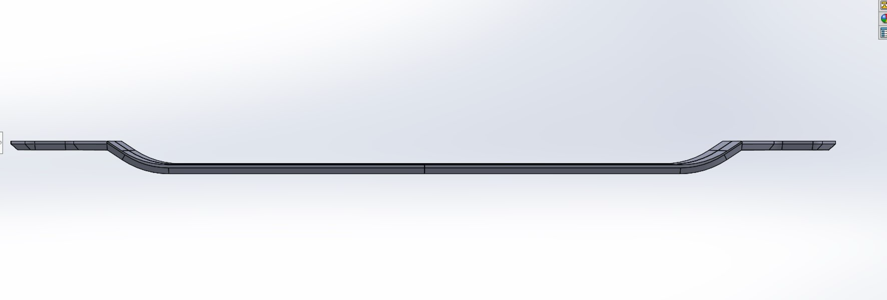

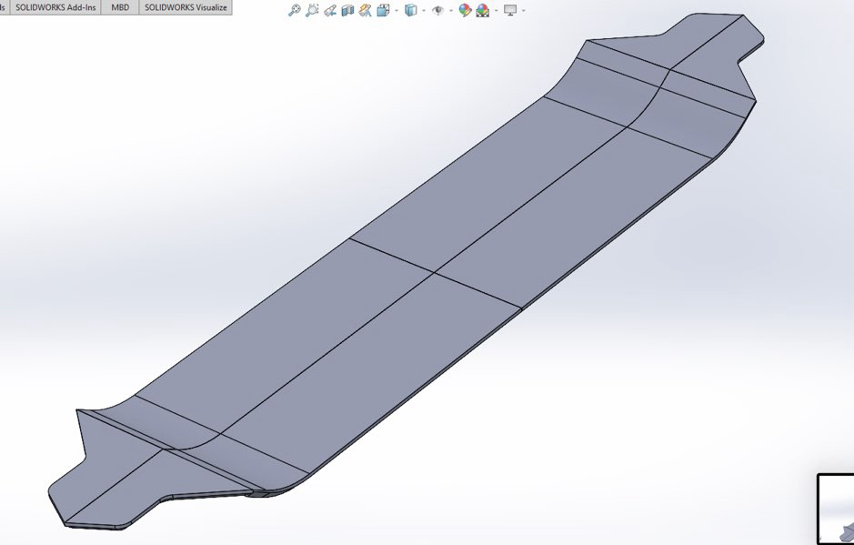

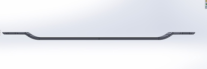

I want a set so bad, I want to design a custom drop deck and utilize the flat profile version of the dualities.
I started just goofing around with a design but it’s not a serious design yet.
I’m debating what material to make it out of.
Maybe Carbon fiber or Aluminum I want it to be rigid enough to be acceptable for higher speeds but also capable of short track racing / general cruising.

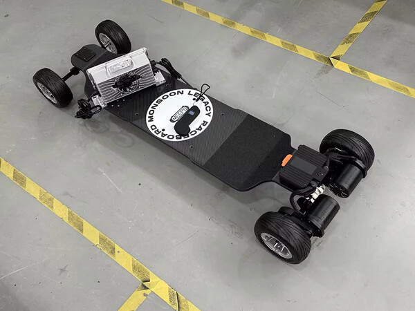

Looks a lot like an MLR deck. Might be able to save yourself the trouble of fabrication (if that’s not something you’re looking forward to)
@tuckjohn I actually tried the MLR and I didn’t like it. Idk what it was but I felt like it was missing something. It kind of felt dead in a way. Maybe I needed more time on it. To be fair it’s one of the only drop deck designs I’ve been on. Maybe I just didn’t like how it felt it being a drop deck but idk. Just another idea I’m bouncing off the wall
I’m probably more interested in the fabrication than anything. I’d love to build a deck press and experiment with strange designs.

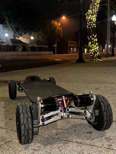

Been working on building this cruiser for quite awhile but it’s so heavy I wish I put a smaller battery in it.
What size? Sorry derailing here but too curious not to ask lol
12s10p @dskate

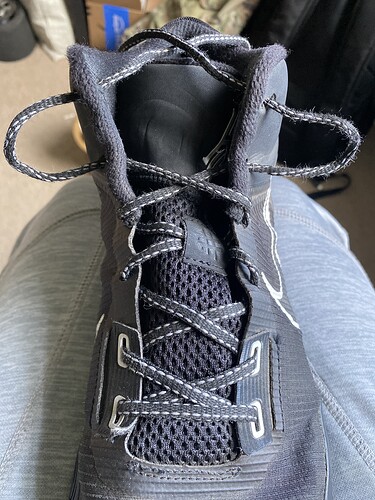

Found that my toeside turns improved with some somewhat uncomfortable shoe tightening. While not pleasant, i can now toeside turn more effectively. Even though my feet were screaming at trying to hold on. I’ll be sore tomorrow for sure.

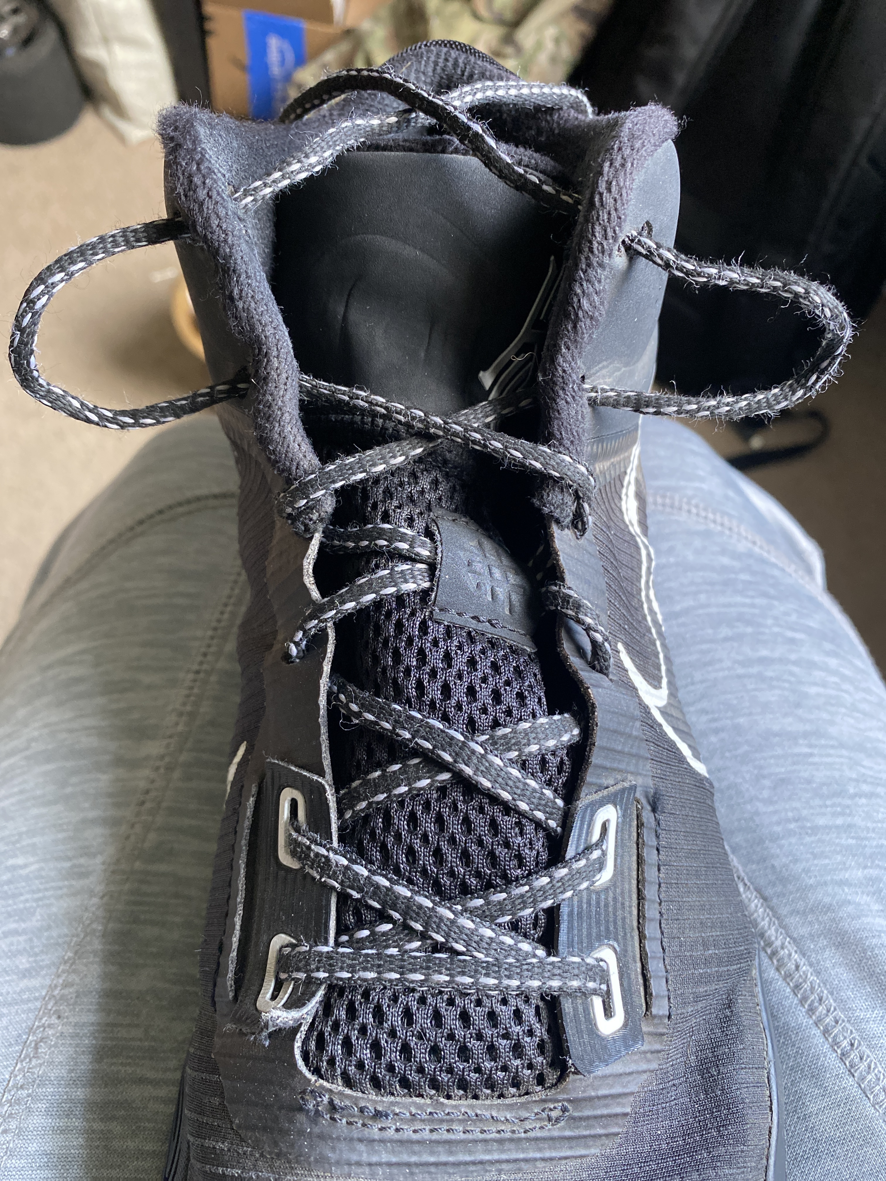

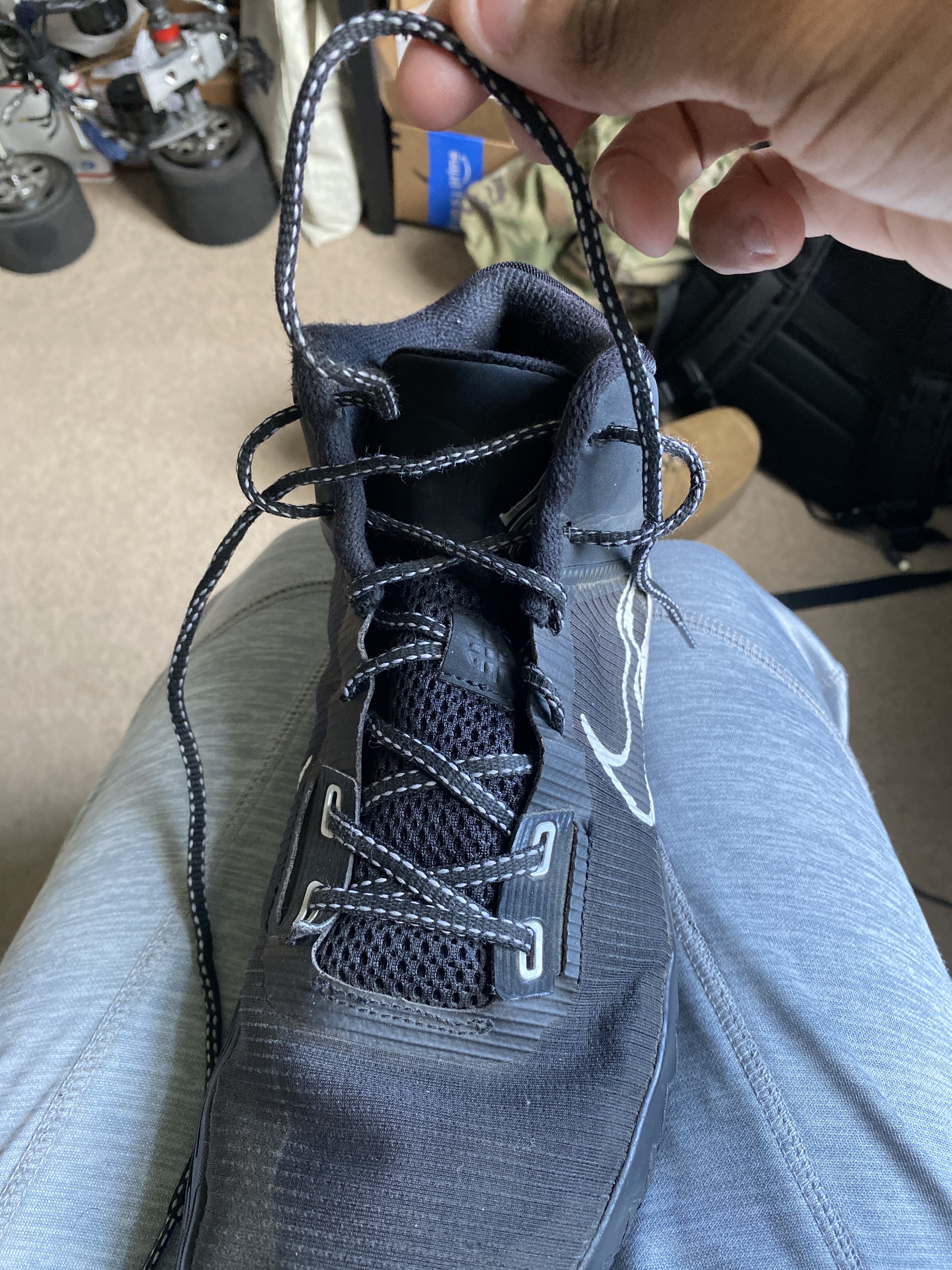

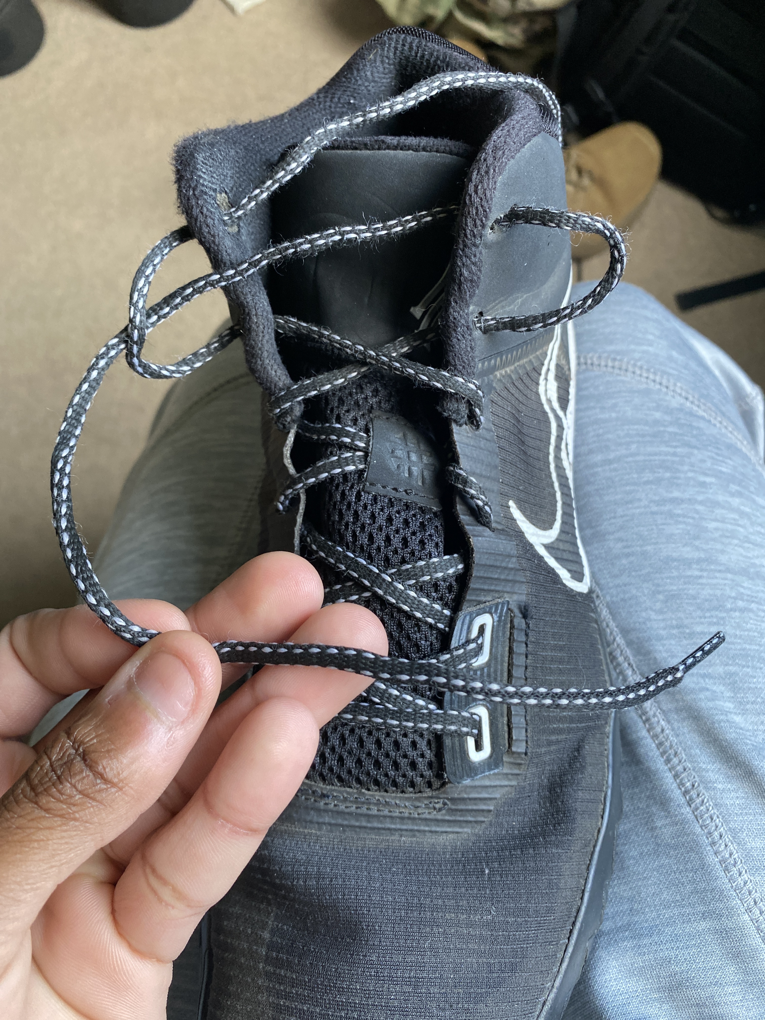

tomorrow i can post a pic of how my shoes are tightened so that my feet don’t shift in my shoe. it may be how you have it already tho
Hey look, I’ve got it handy:
ahh the esk8Jesus special :joy:
this is how i tie my shoes. i then pass the opposite lace through the hole and tighten to whatever feels comfortable.

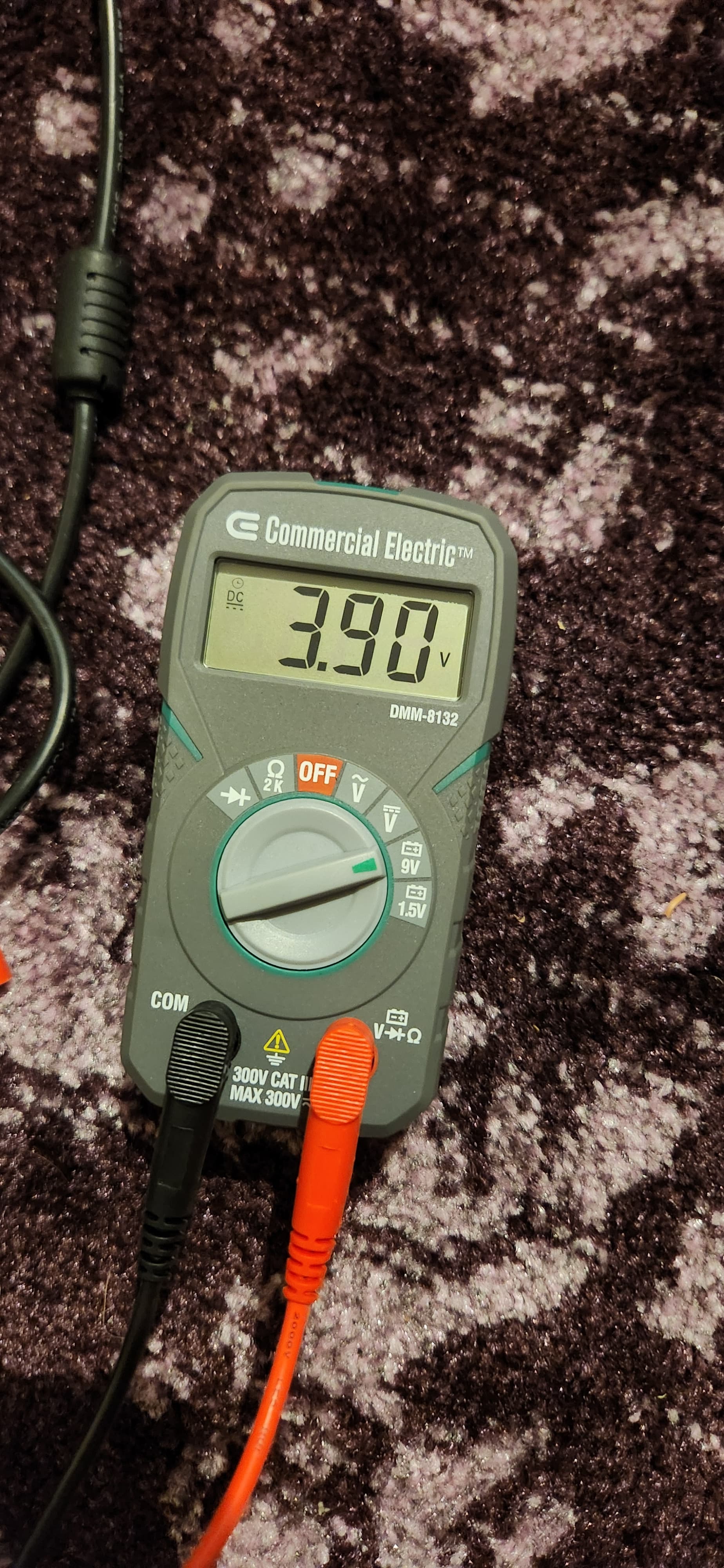

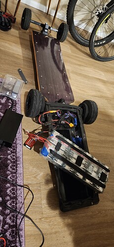

Thought i was down on power or lost a P group.
So pulled everything apart and with the help of @tuckjohn and @HAIRYMANJACK i was able to test all the P groups.
Most were 4.02.
Three were at 4.04
And one was at 3.90. So found the culprit.
But since its essentially only 0.1 off, gonna keep running it.

Went to hang with a @tuckjohn to get some help with a possible soldering issue.
We tore into the board and found a broken connection to my power button. And a possible weak connector on an XT90.
So he soldered the wires back to the button and that was good.
Then we cut the old XT90 off the DV6. And Tucker got that soldered back on.
What we both missed was that it was reversed polarity.
So of couse I put the board back together and turned it on.
And we got all the angry pixies fired up for a light show.
We tore the board back apart amid sparks and probably some molten nickel. Uncoupled the power from the battery and took a couple minutes to chill.
Then Tucker said oh fuck I know what I did. I didnt check if it was reversed!
The antispark switch was completely annihilated melted in half and partially vaporized. DV6 was dead.
So long story short I need a new battery and speed controller.
Tucker was kind enough to help fund some of the 18s6p battery order. And he bought me lunch!
