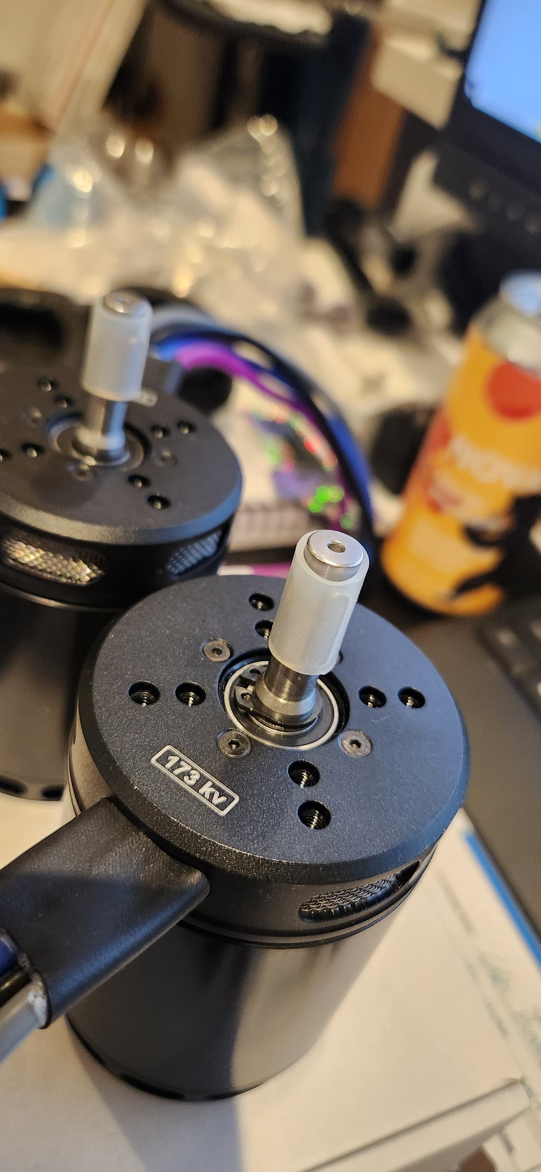

173kv motors ordered from SkyArtPower.
6384s!
Spoke with chat (Artem i assume) and he told me the motors will be able to handle the 18s build but i may have heat issues with the 5.5:1 gearing. And i might have iron losses when it gets hot out. So looks like this build will definitely be on the race side once its on the 18s battery. Should be ok for group rides and commuting if i go easy on it. But definitely going to be more race oriented.

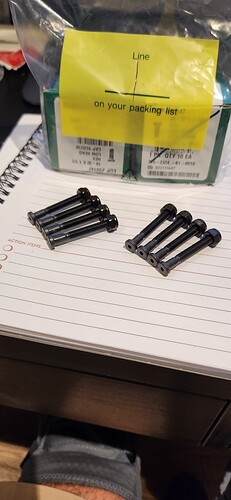

Hardware is here.
Went full send and got some 1.5 inch, 10-32 hardware from Mcmaster-Carr. 140,000psi Tensile strength. Long story short… yea that’ll do.
18-8 stainless lock nuts. Black oxide coated. They didnt have alloy steel which was odd. But these should be plenty strong.

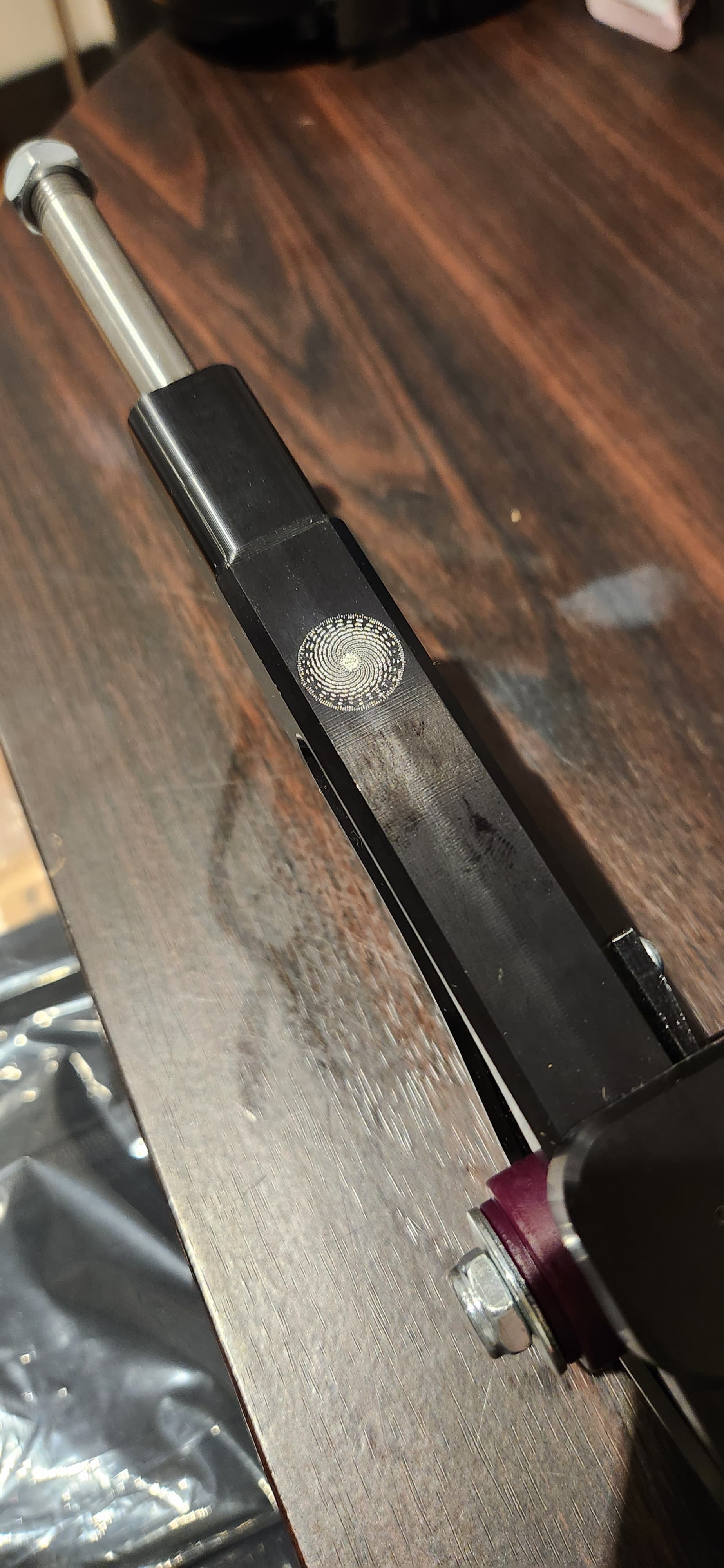

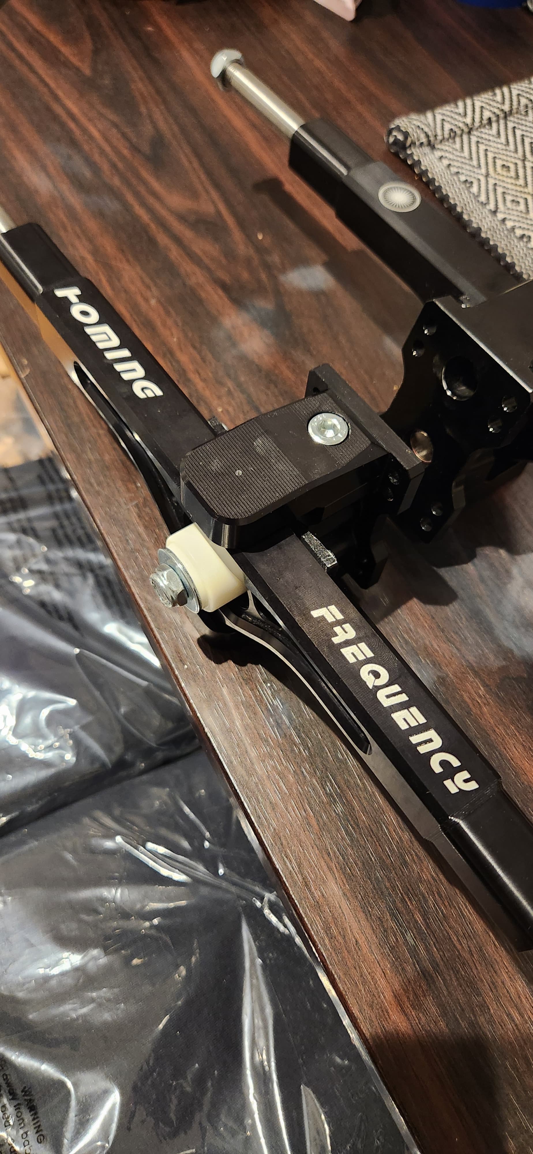

Laser beams are awesome
Thanks @HAIRYMANJACK for the laser engraving on the trucks.
Homing Frequency on the front truck. Il lbe running the hangers flipped for a lower ride height. I can thank @tuckjohn for the Duality trucks tips.
The rear hanger got a special treatment too.
These symbols are Cymatics of 2 different frequency in water. Finding these and getting the correct ones was a bit challenging but i found a couple good ones.
One is 432hz.
One is 528hz
These frequencies are supposed to have a restorative or anti-Stress / Healing effect. Ive used 528hz for helping to sleep or meditate at night and calm the ocean that is my ADD mind. ALLTHETHOUGHTSALLTHETIME!!!
So I figured why not etch the frequency into the parts somehow. Maybe it helps the rider feel more in tune with the board or reduce fatigue an extraordinarily low amount. Or maybe it just gives the feeling of good vibes while riding which is always welcome.
