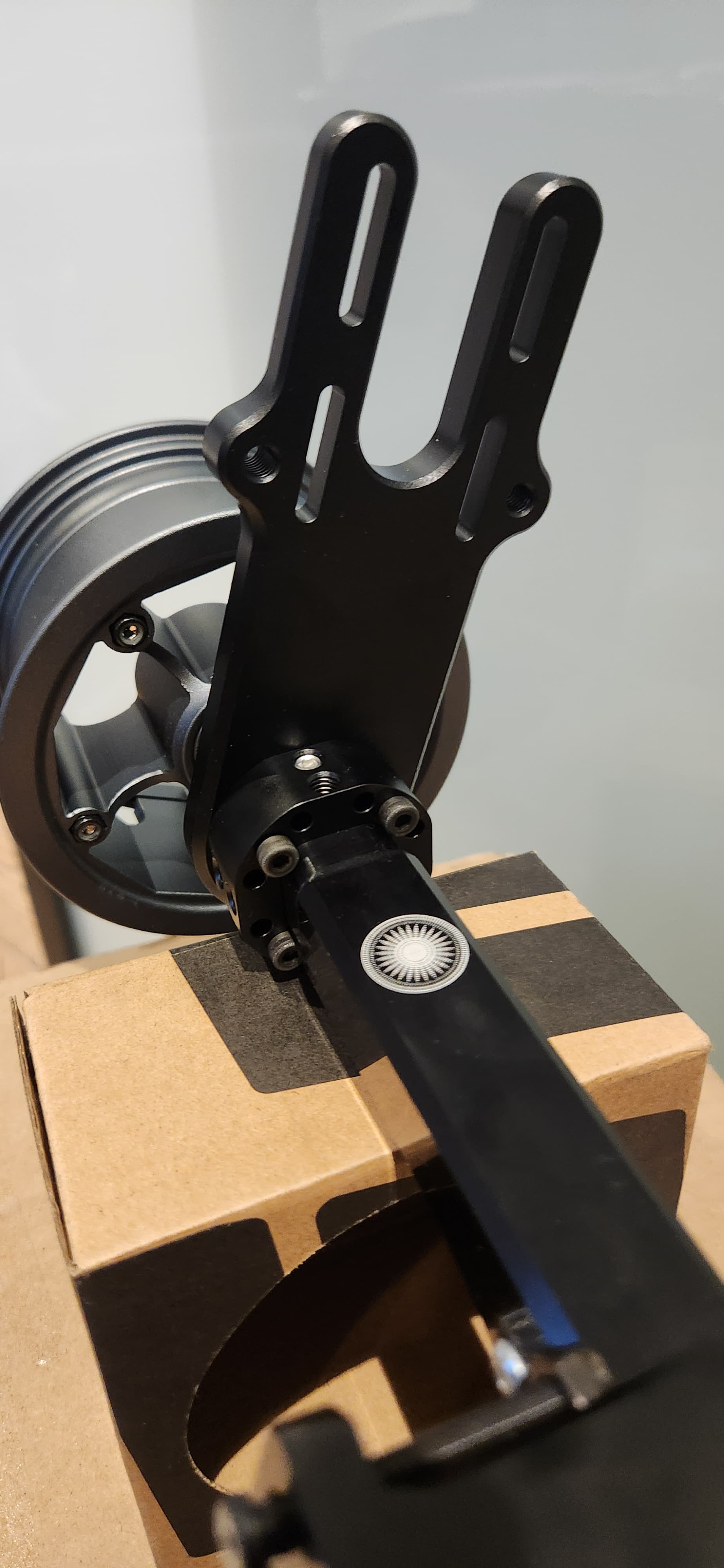

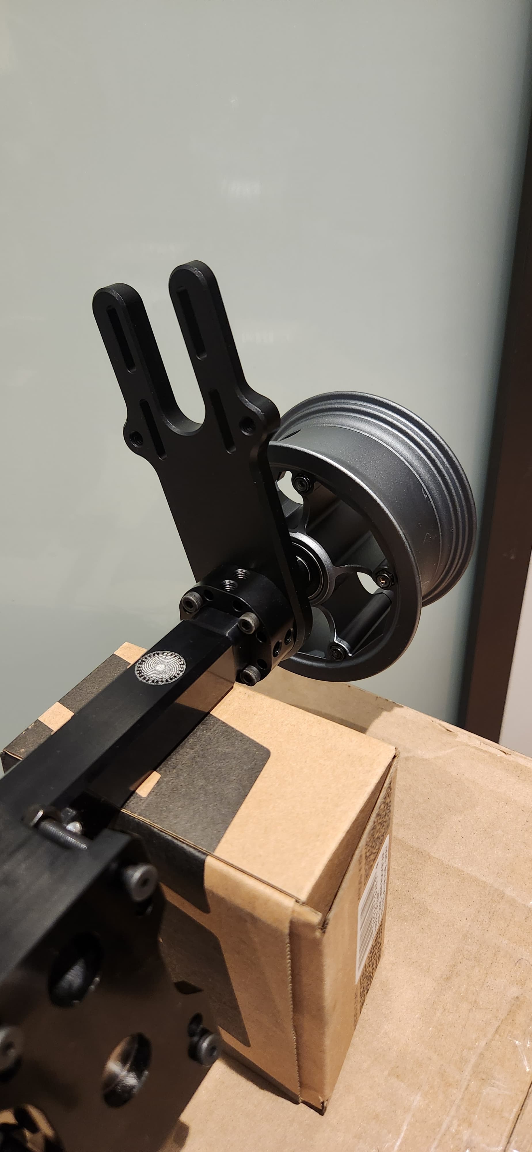

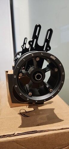

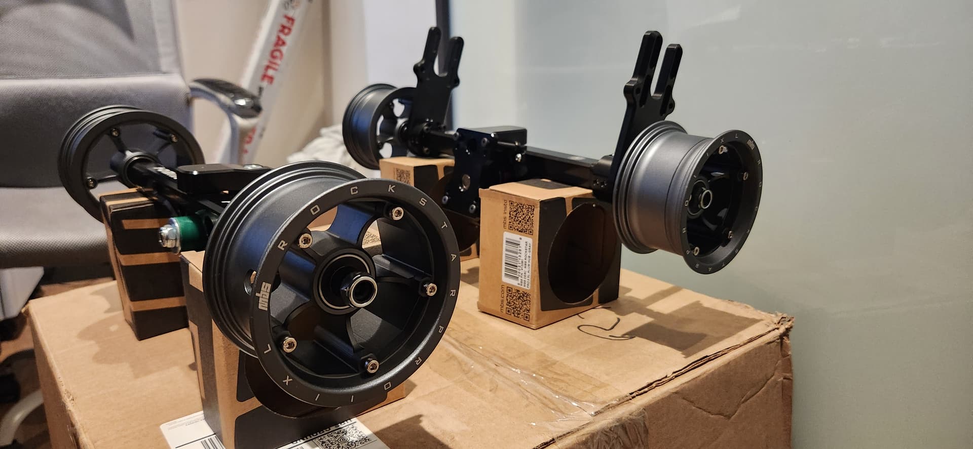

I am absolutely drooling. Wow this wheel color is SICK!
These Motor mounts are also super sick. Light but Beefy. Probably the Thickest mounts I have seen. Cant wait for the deck to come in!
Looks fast already🏁
It feels fast.
Cant wait for the deck!!!
The wheels are so nice in person. Ever so slightly green. Love em.
Fucking massively stoked.

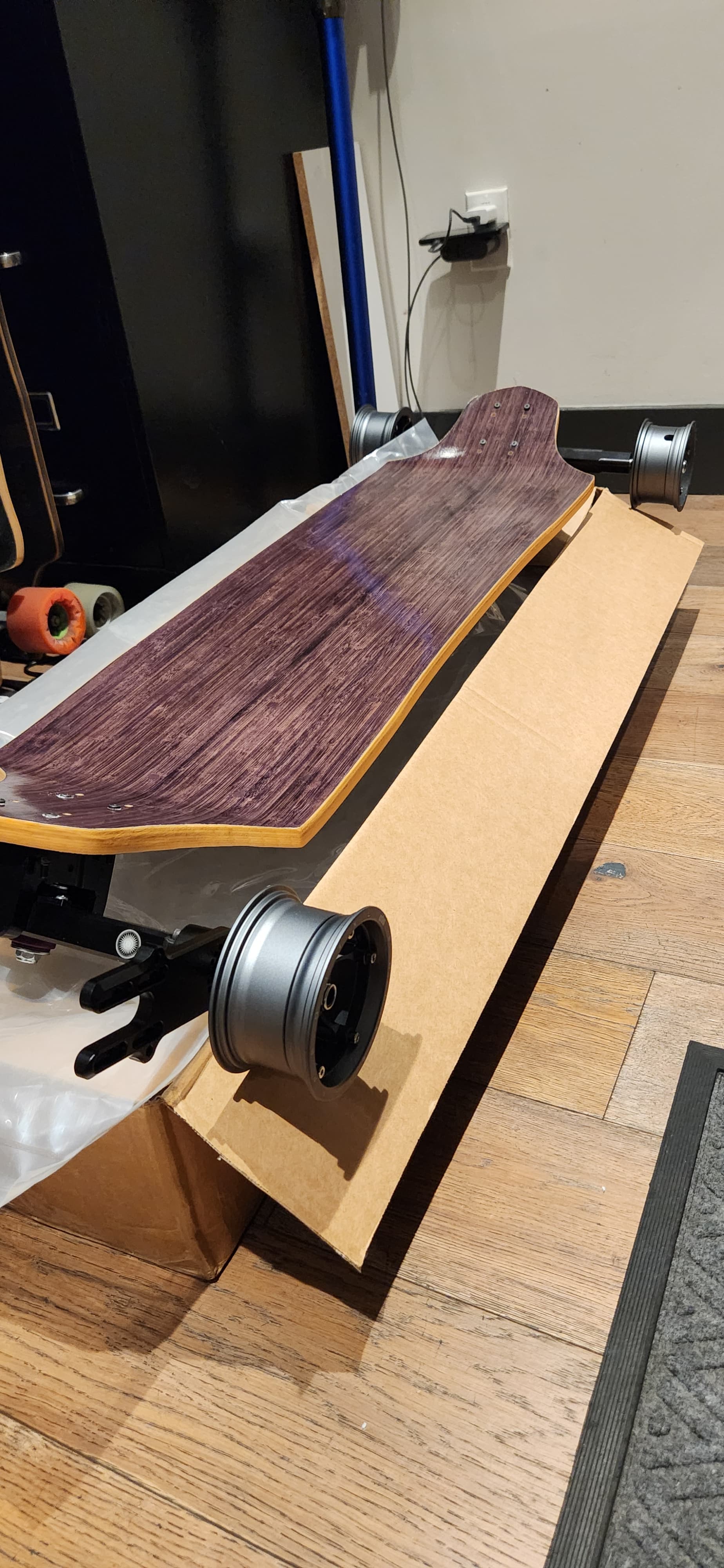

Just nneed to slap on some tires and i have an official rolling chassis.
diabolical laughter

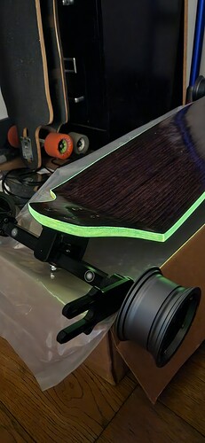

Build is coming along nicely… Looks like your rear baseplate is on backwards, fat end should be towards the rear.

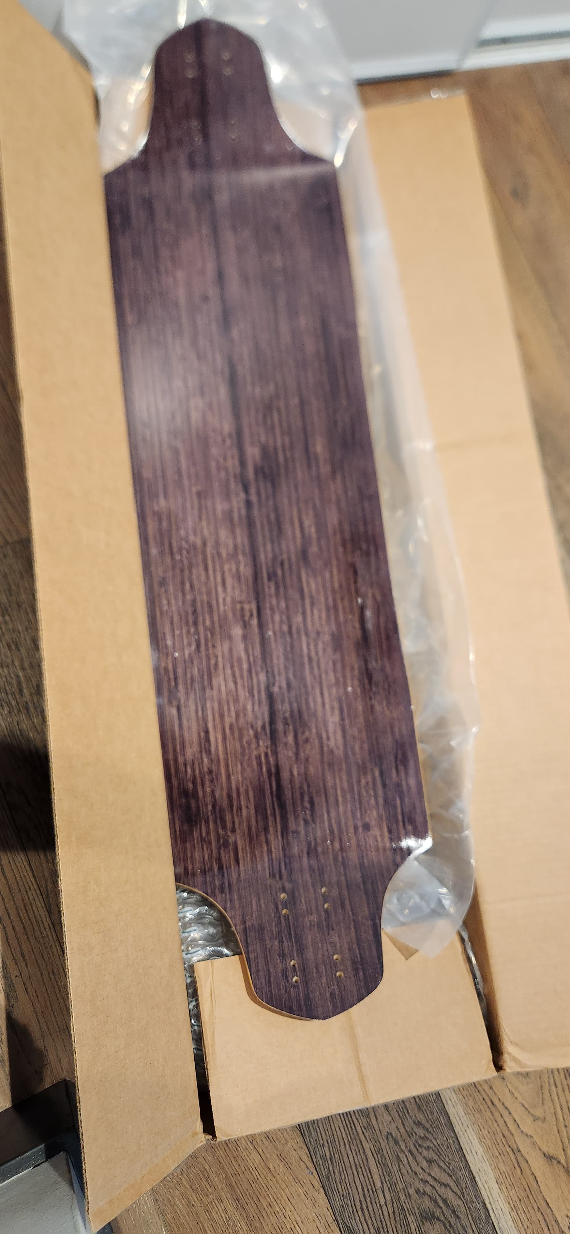

Dream deck right there that thing is purddddyyyyy
I was so excited to gwt it slapped together during lunch i totally missed that lol.
Need more info on that glowie thing :star_struck:
Here you go!
Got it on right.

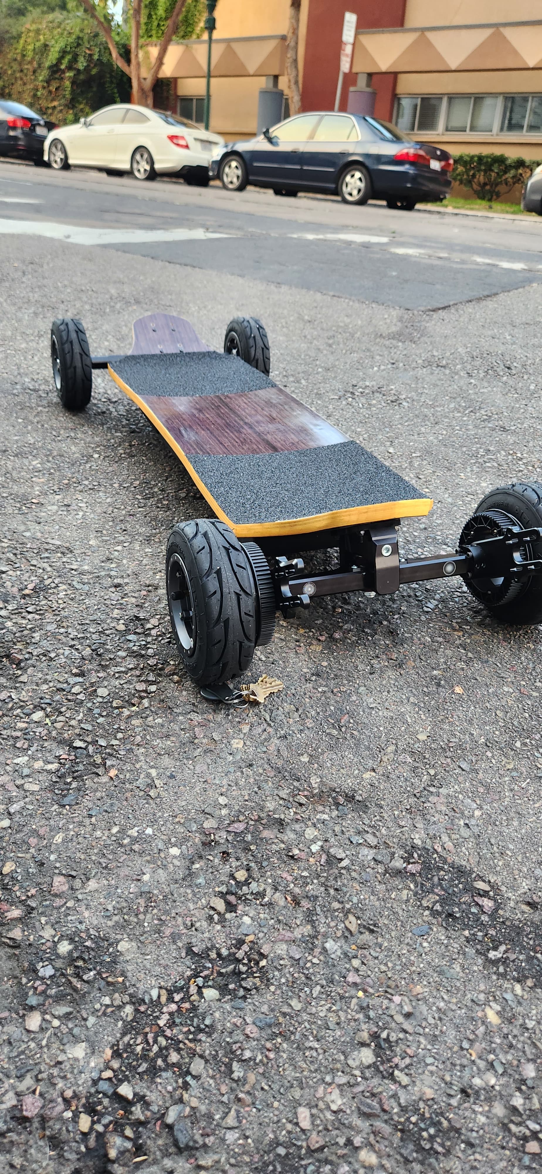

Damn she is Sexy.

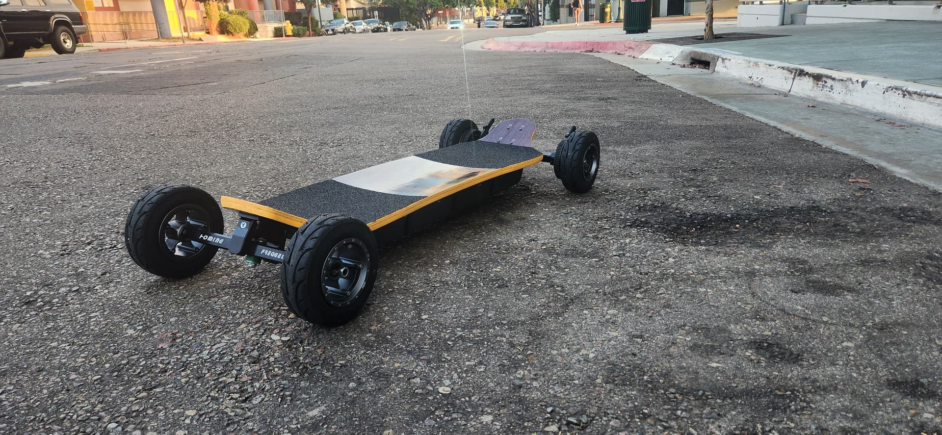

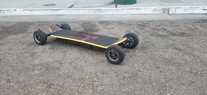

Unfortunately shes too low.

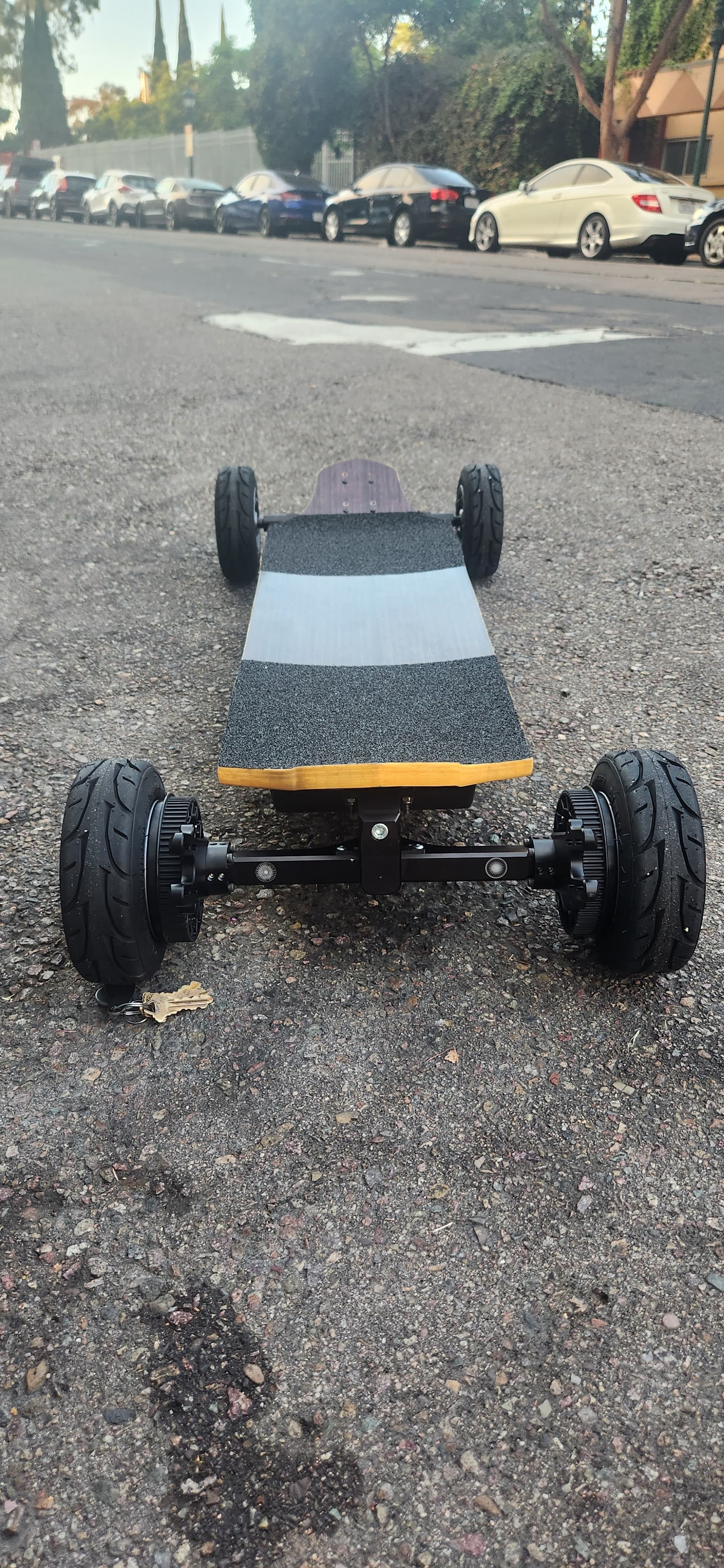

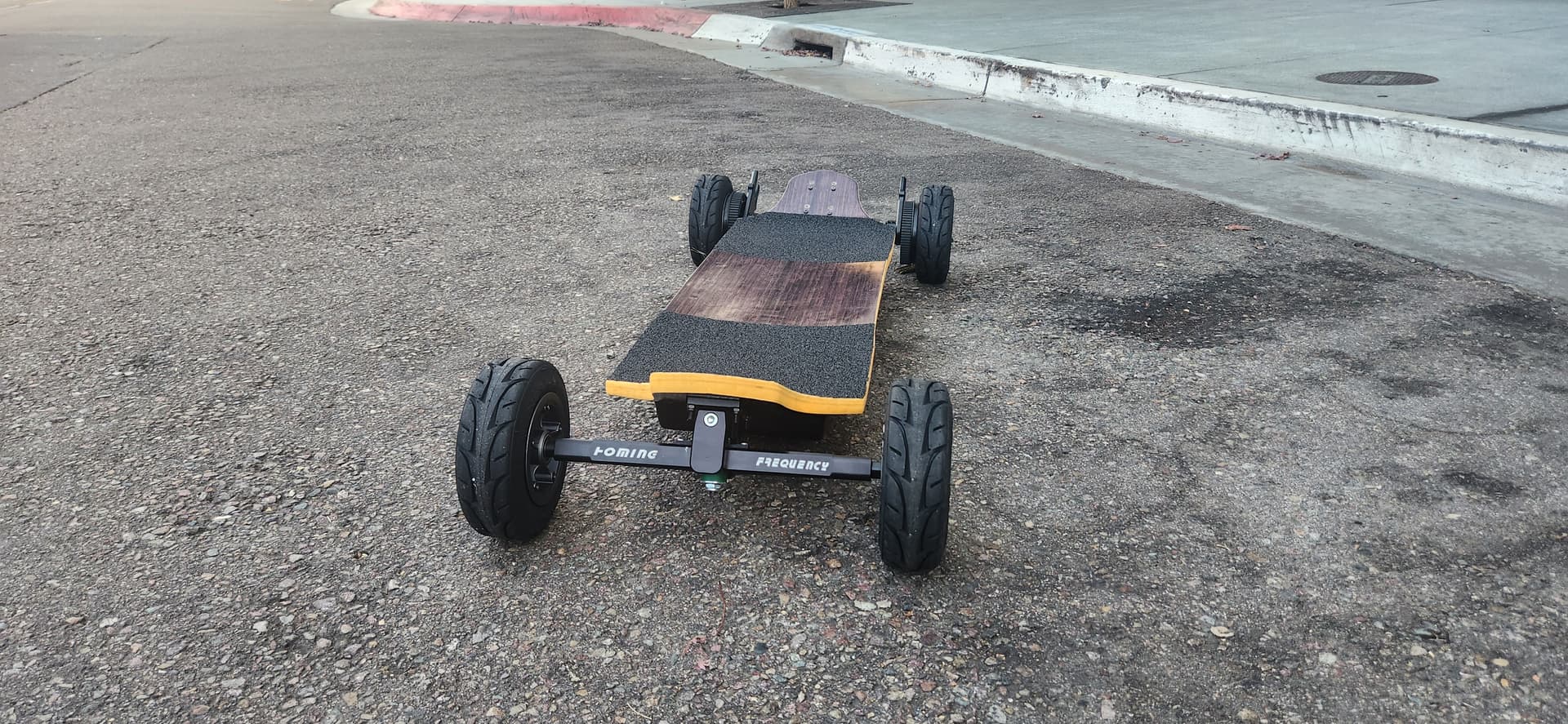

The double stack enclosure takes up a lot of space. First iteration was yesterday evening.
Far position on the bolt holes. It would turn like 10 or 15 degrees before hitting the enclosure. Basically almost immediately bottoming out.
Back to the shop.
Moved trucks to the short position. Which improved it a lot but it’s still bottoming out.
Going to have to try Flipping the hangers or go to 8 inch tires.

That enclosure is HUGE! Not surprised you’re bottoming out. I’ve got problems on my Nazare single stack enclosure :rofl:
I don’t see a way you can keep a low standing platform and a high lean angle for a good race setup while using that enclosure. changing the Trucks into short positions gives me this vibe

This is very true. Have a look at my board on 6.5" tires with a standing platform nearly at the same height as the axle. I don’t think you can make double stack work well, single stack is a compromise, top box is really what gives you the best ride feel but doesn’t look as sleek.

I got the same dilemmas. Double stack really sucks for clearance, nothing in single stack can hold 80+ cells except unobtanium Lacroix and top boxes are ugly :frowning:
Yep. This exactly
Im still set on the 108 cells of 18s6p. But im gonna have to do some funky stuff for a top box. I’ll try to keep it super low profile.
Going o have to research some boxes and maybe mess with a kydex enclosure.
