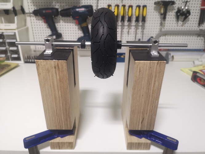

This is the method I use
use two stands to support an ā€axleā€, slide the axle through the rim with the mounted tire and put it on the stands. Mark the heavy spot (the bottom) when the wheel stops rotating. A chalk mark, or grease pencil works fine.
Spin it again and make sure it stops in the same spot. Once you have determined that it is the heavy spot, start applying stick-on weights one at a time to the opposite location on the rim. You can buy a box of weights at auto stores or cheaper online.
Keep checking balance after every square. When the heavy spot stops in random places, you’re done.
This is the method I learned to balance motorcycle tires in a pinch. I’ll bet avio or someone has other methods that are better. I’m definitely curious to know how people are doing it as well.

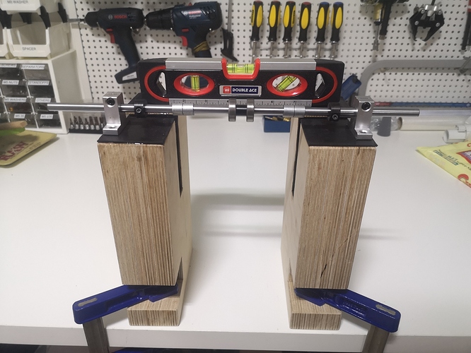

Yeap! Exactly the same as how you’d balance a motorcycle wheel. I’ll take a pic of a cheap setup i made using 3d priner parts when I get home.
If you have a wheel balancer with a spirit bubble level,even better!
I can perhaps also design something that uses a nail and a bubble level app on a phone…

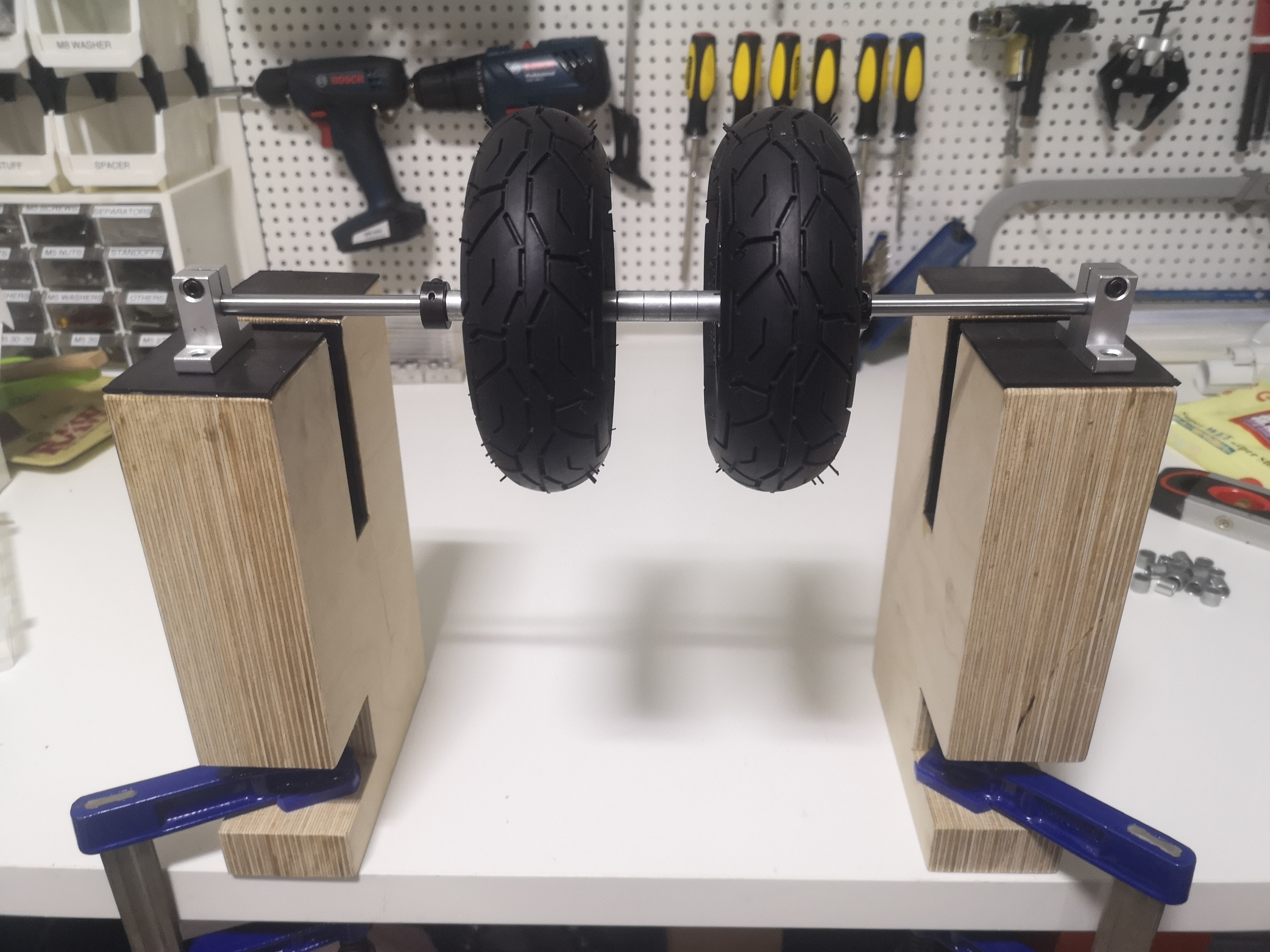

Here you go. I usually balance 2 wheels at a time.
In case you’re wondering, those wooden jigs you see are designed to help me with waxing and tuning my snowboards. (hence the slot in the middle). I also use them to prop up my esk8 builds for maintenance and repairs. really handy for lots of stuff. Works by simply clamping them down to any work surface. Dimensions below if you want to build one out of a 2x4

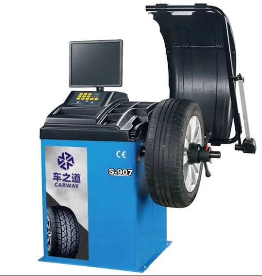

Follow the steps shown in this vid.
Awww, i won’t have the money for that till 2 months… damn my luck
