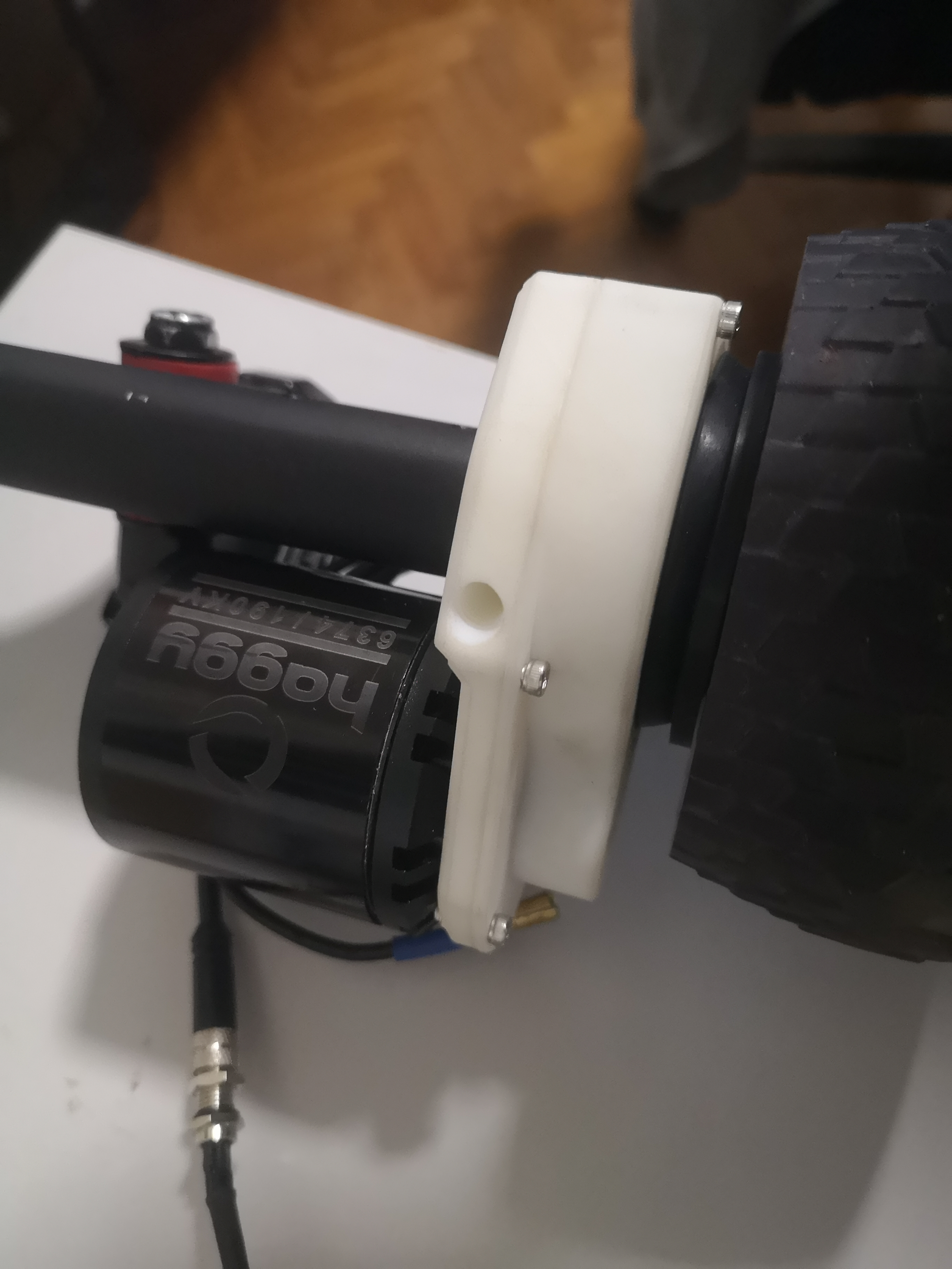

@avX it looks like 6384 are the largest motors can fit. Any chance for a 6396 adaptation?

Nope, there’s only about 184mm between the motor mounts.

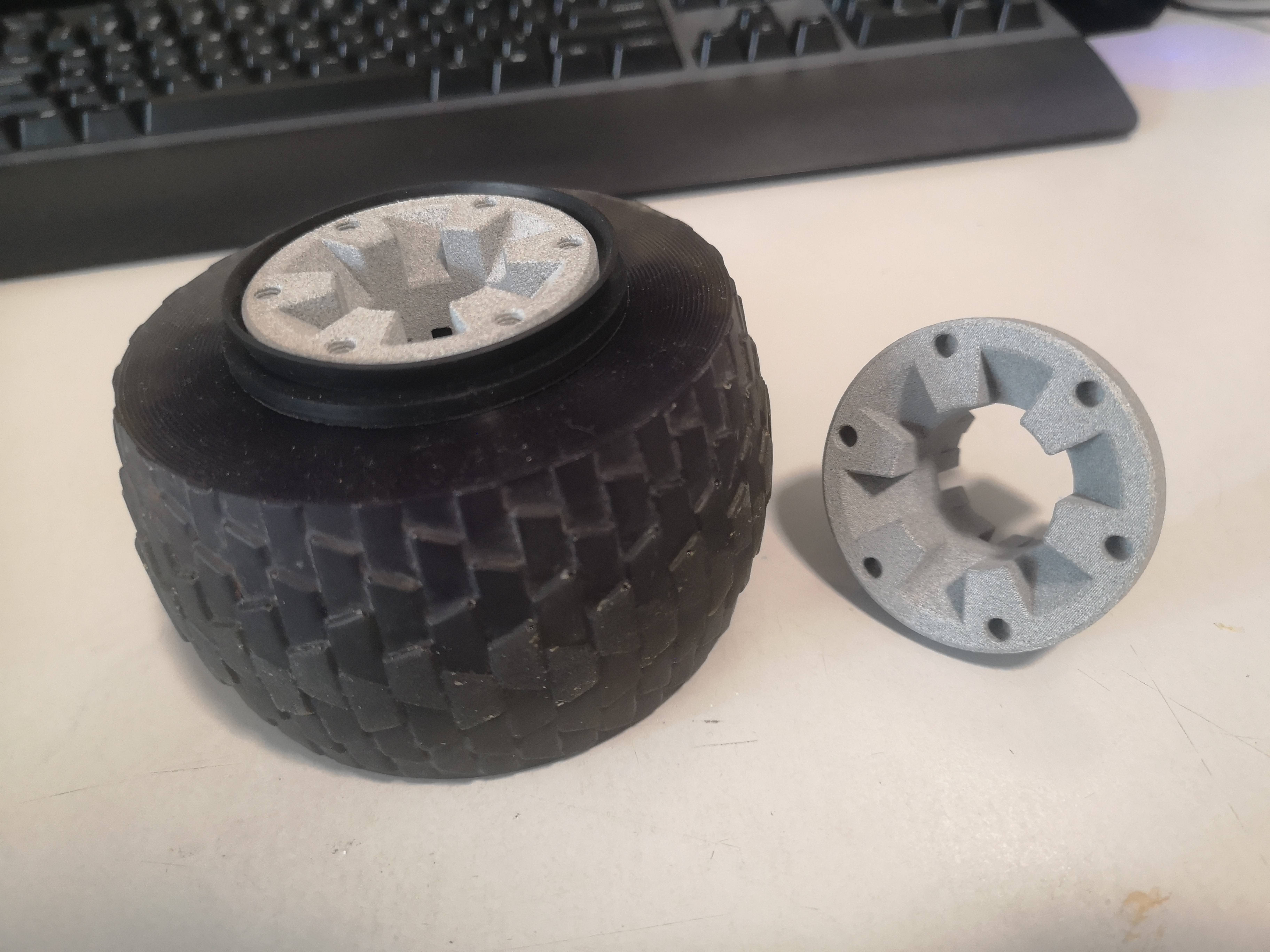

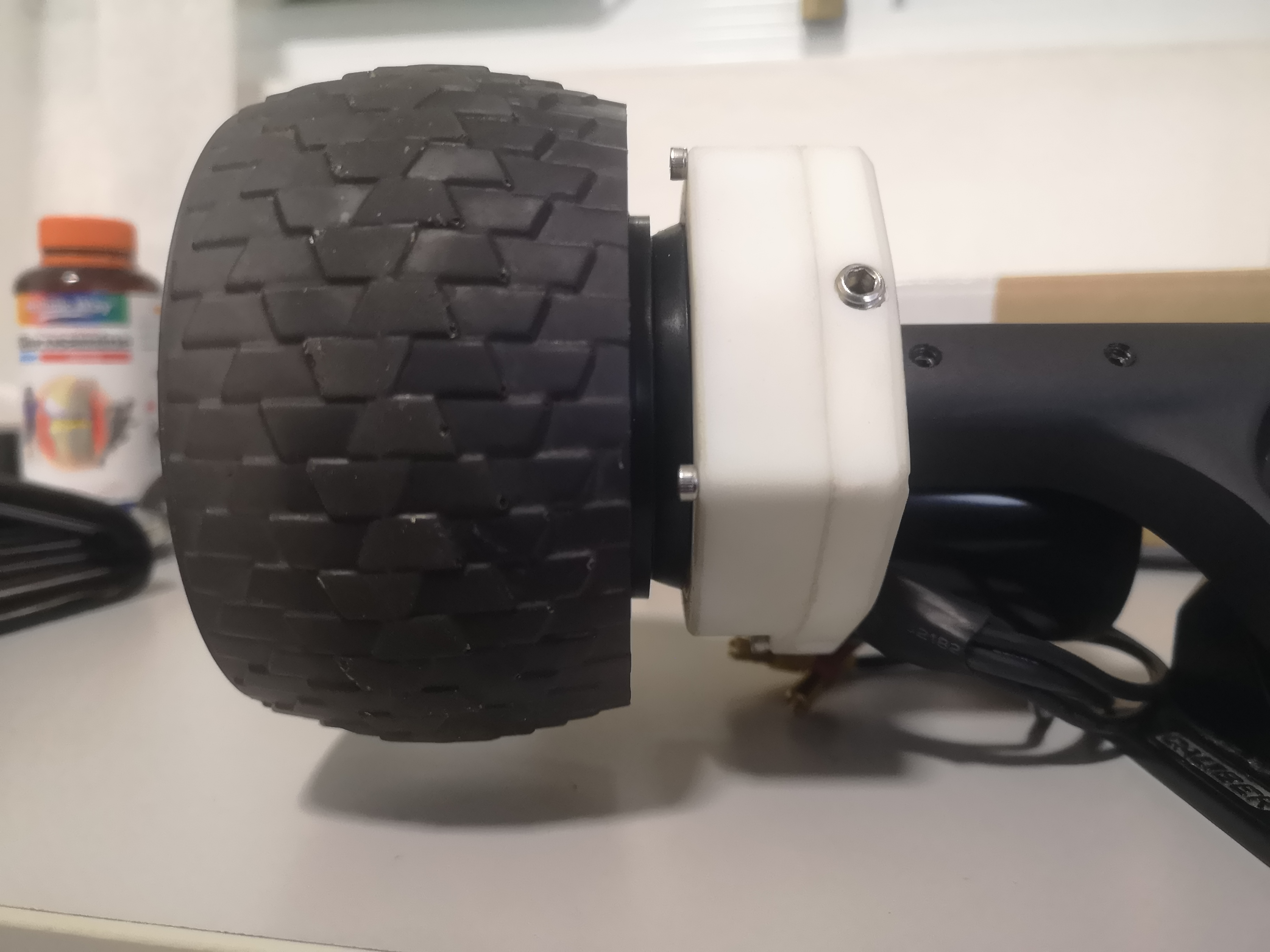

MiniUpdate!
Designed wheel adapters for foamies!

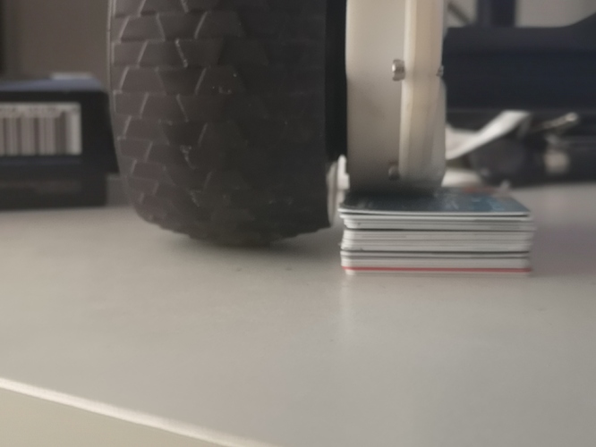

About 21 creditcards of clearance.

Haha, perhaps, but it’s not in my roadmap right now. I don’t expect there to be a large enough demand for people wanting to use 6396s.
Most people regard the kahuas to be a pretty wide truck already.
It might however be possible, to place an a simple 5mm thick x 25mm ID hollow alu stock between the mounts and the trucks to add more distance for motors. Though, this will only work on the kahua precision trucks. (A 5mm adapter at both ends = 184 +5+5mm clearance = 194mm.)
If people are interested, i can make a guide on how this can be done.

Do note that the adapter for foamies won’t be ready for sale with the mk2 set just yet. I intend to test my MJF nylon printed prototype it in r.l conditions before sending it to manufacturing.
I could however send you that MJF adapter after i’m done with it though (:
