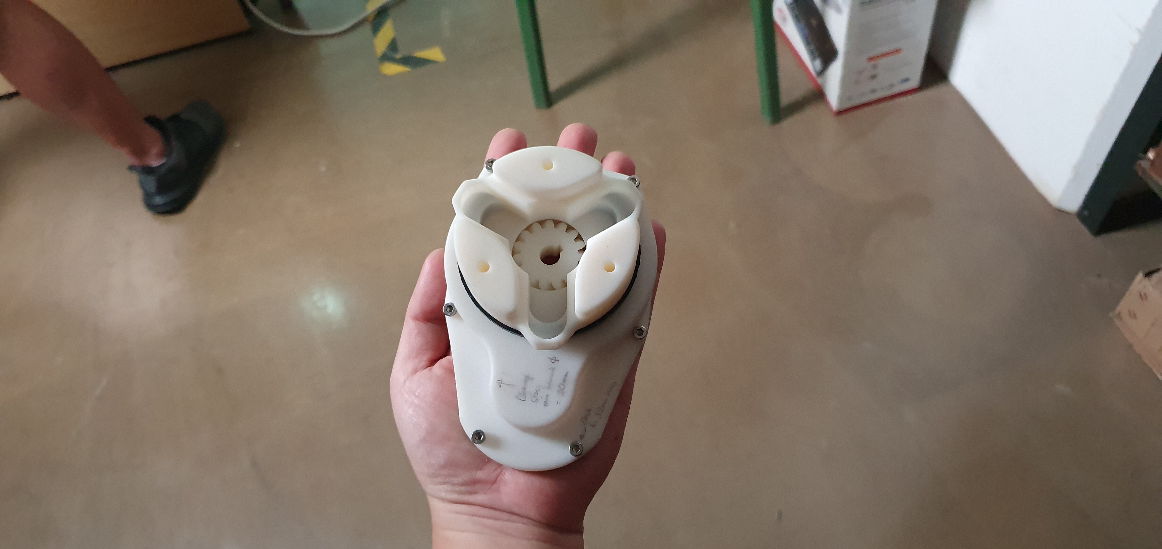

Herringbone Gears Avio MK2 Gear Drive
This is so fun sized. I have small hands btw

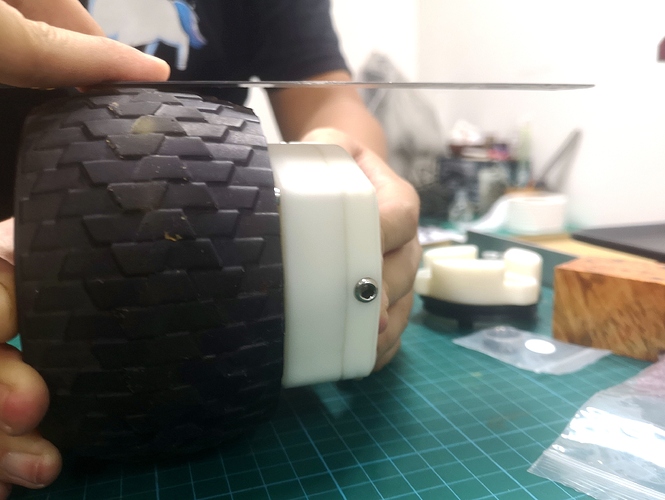

Progress update:
We have carefully selected each of the materials for the different components of the drive and have made the initial payment to our vendors.
We’re now in the production phase! With the costs of our components out of the way, we will now be looking into firming up our shipping options. When that’s done, we will be releasing the price of the mk2 drive! (Expect package deals when bundled with wheels, trucks, motors, or when you purchase more than 1 set!)
Below are the finalised components. Carbon Steel pinion on a POM wheel gear now, as opposed to alu on POM. The pinion will also be black oxide treated for corrosion resistance.

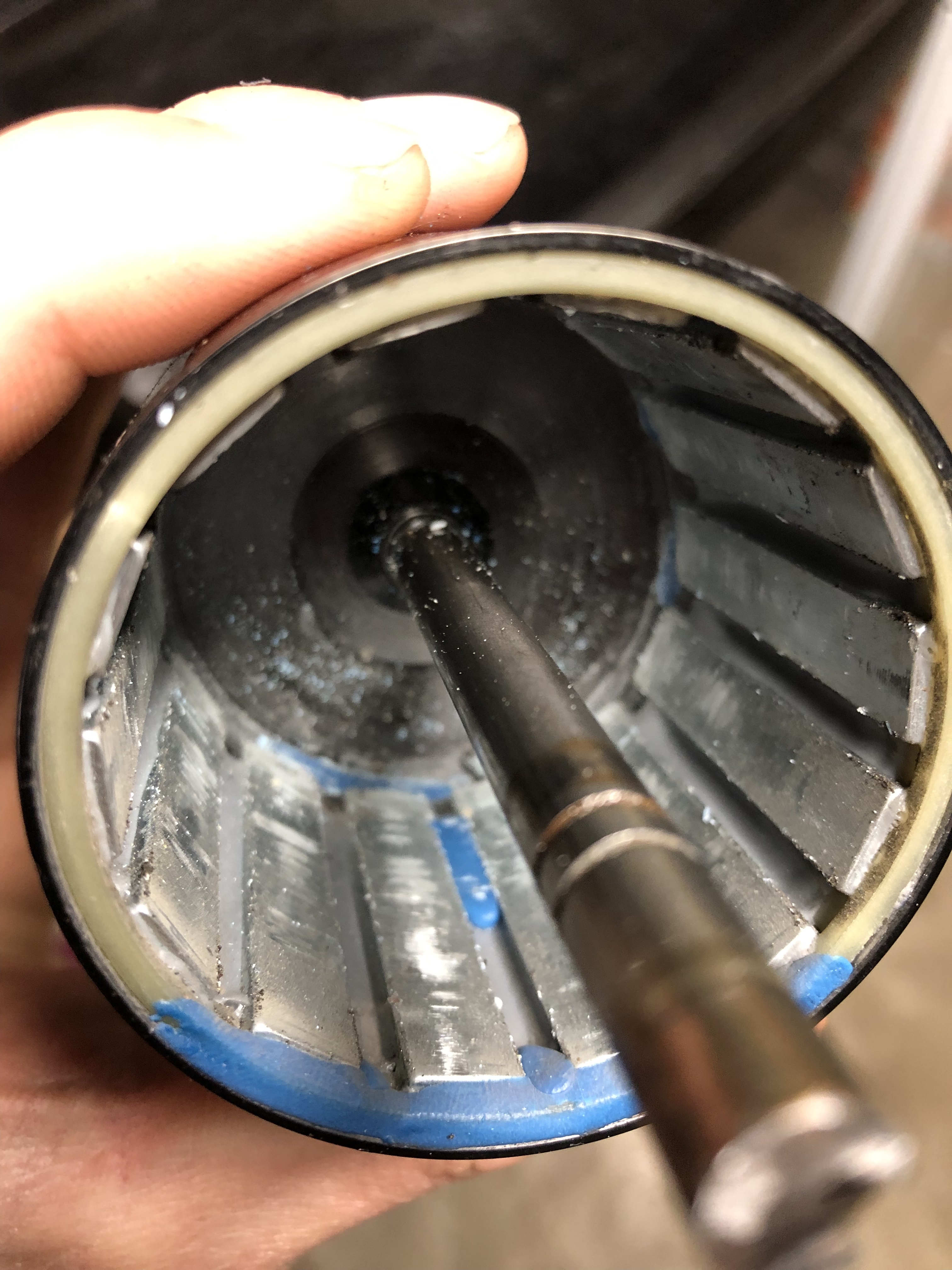

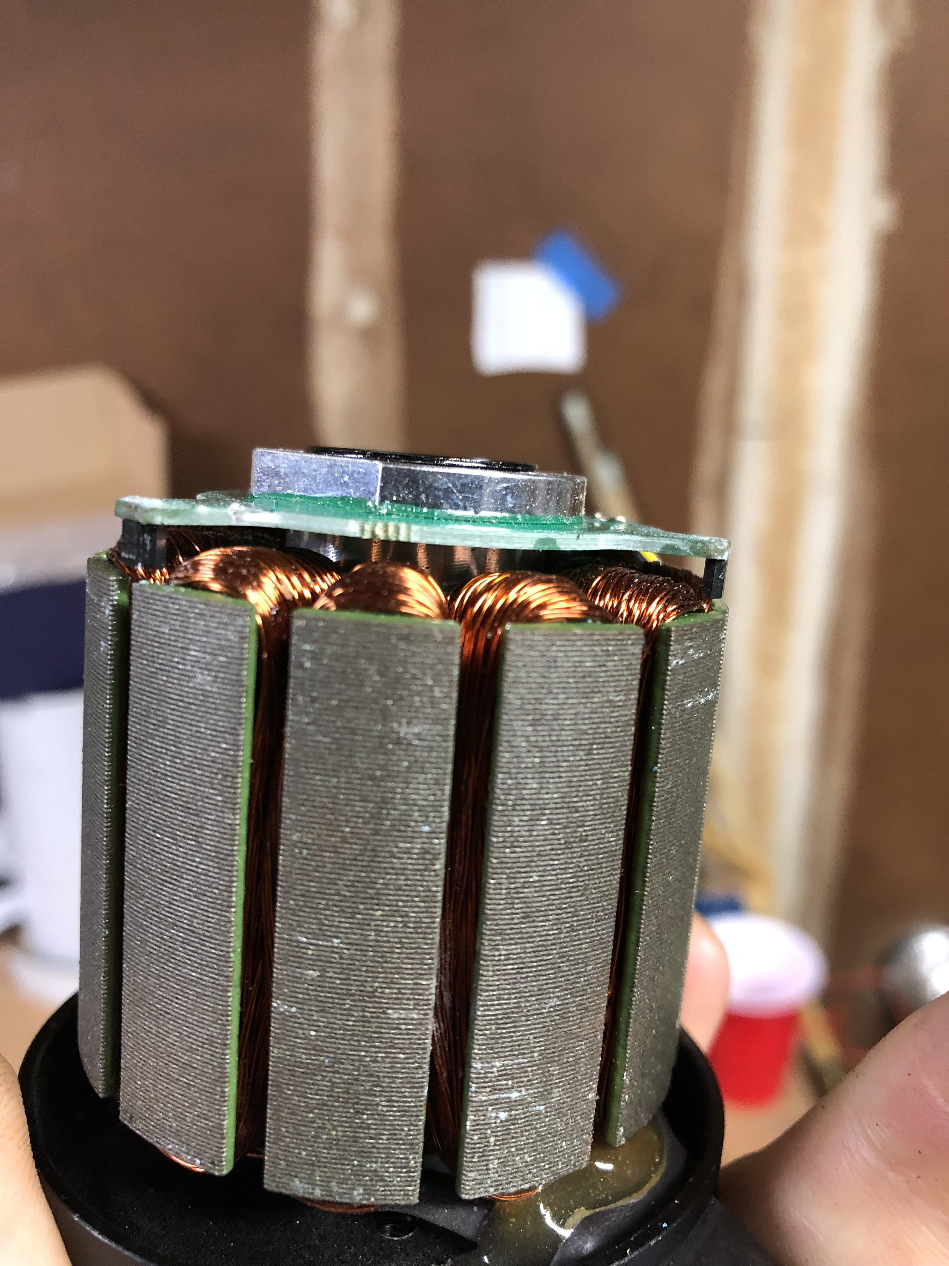

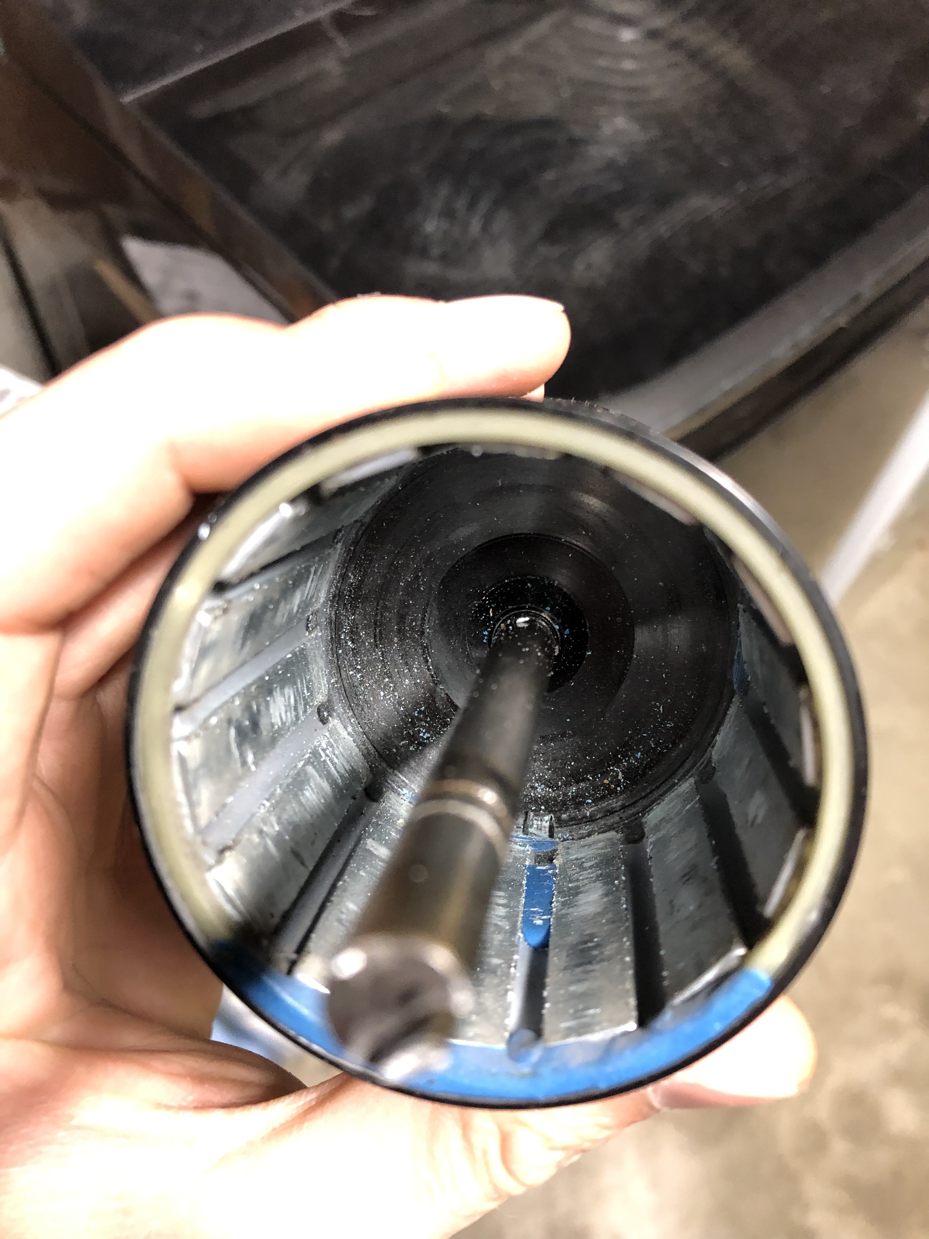

Lol @Kellag knows about my back and forth with Agnes. She was unwilling to replace the motor. Her advice was to keep using it disregarding the fact pieces of the motor pcb had come apart resulting in intermittent wedging between stator and can causing it to seize. I would have to pay for shipping to have the motor repaired. This happened under normal use with less than 100miles on motor.
Looks like a hall sensor fell off the board. I have serious doubts as to whether sensors add or subtract from the experience… The vesc didn’t fry itself?
Hey so how much do you want for that one? :slight_smile: Maybe the remaining good one too.
Luckily the VESC was all good. Motor was still functioning when I discovered defect but I didn’t want to take any chances putting it back in. PM sent
