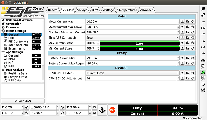

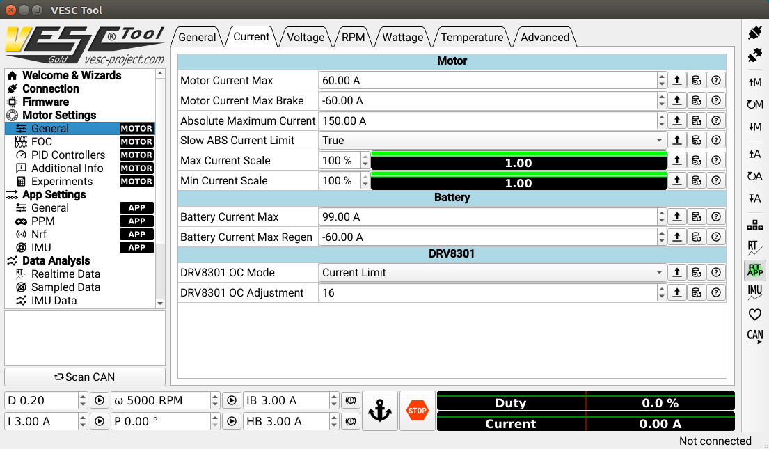

with those suggested current limits my esc cut out constantly ended up eating shit lol
Would you show us this screen after pressing “Read Motor Configuration” on the right?
Absolute max 60a doesn’t sound to me like alot :thinking:
what should it be? 10s4p 30qs
What motor is this?
I’d probably personally go between 120a and 160a
160a is the default for a reason, change it back to the default and you’ll probably be golden.
I’m fairly certain it’s not dependant on your setup, it’s just used as a way to save the vesc if it detects a higher load. Hense over current fault
