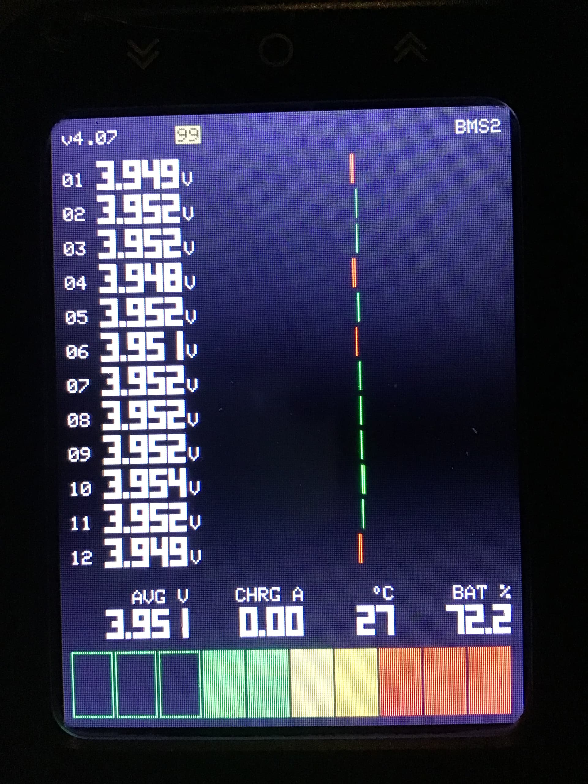

so what is everyone thinking about the piece of the magnet missing? motor feels like it got a little more resistance than usual, also dosn’t run very smooth, as if “something was missing” but what’s the science of a piece of magnet missing in an e-motor? do I lose energy? more friction from the bearings as things are a bit “off”? did about 10 miles today, went smooth, didn’t go faster than 20mph, it’s an intermediate solution, at least I’m glad I can ride it again, cells already seemed to go out of balance from waiting, had it stored half full (3.7V) and by the time it went to 3.4V I had differences of up to about 0.05V in some cells - oh well it’s always something isn’t it… nice board though, big enough to bring a lightweight female along, I did that the other day, it was rather romantic :wink:
Nothing to stress over. More than .05 is when you start worrying
also it’s rather intriguing that only BMS1 seems to have the discrepancies, the other is lined up perfectly - what could be the reason? more load/stress on the back vs the front?

@regarding the battery: well it seems to have gotten worse, but it is not constant. I think I messed it up when I stressed it too much after having to charge it at almost negative temperatures close to a mountaintop, then I had to start the descent early in the morning which meant it would further charge which had it temporarily go to 4.3V or something close. so essentially overcharging at freezing temps, can’t be good. anyways, I almost use it daily in winter, it’s such a rugged workhorse, I occasionally use it for collecting wood and bringing it home to dry. so essentially now I have various packs acting weird, when I charge it and have it balance a night, the max difference is still 0.1V when it is 30% the difference become way bigger, up to 0.2V more or less. I noticed it struggled to violently throw me up steep hills as when it was new, but I think after 6k kilometers and almost daily use this is understandable. wonder if there is a simple way to replace single cells from the stunning pcb inside this monster of a machine.
