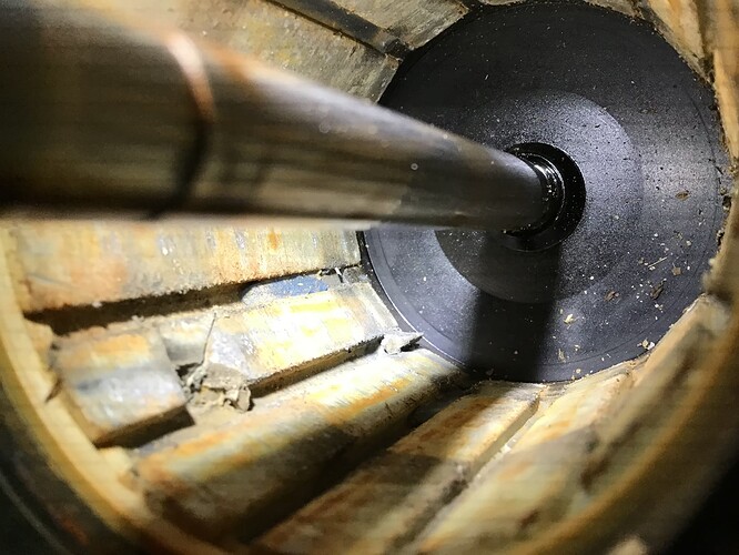

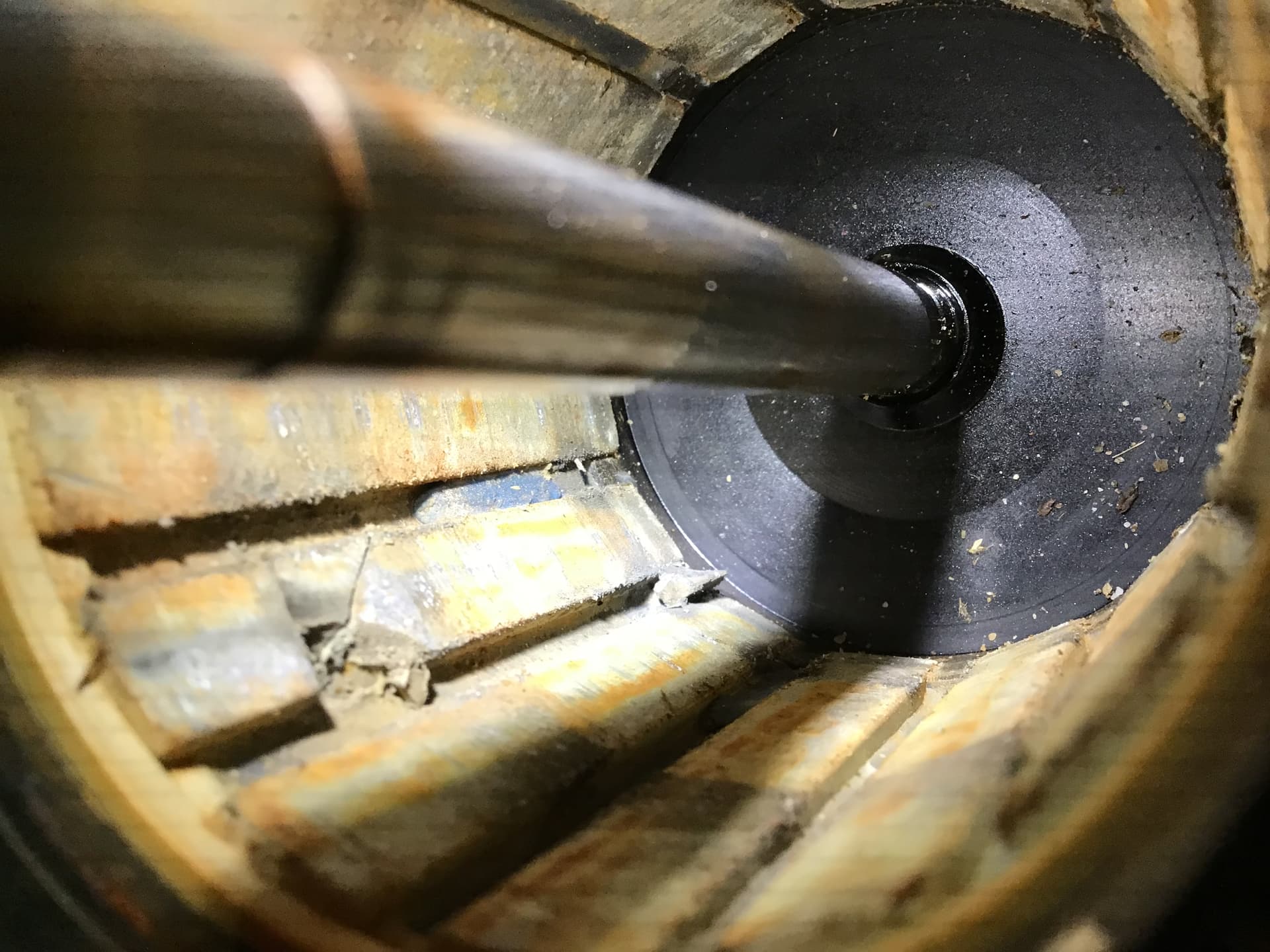

so I just got wind that the plutonium actually does have a traction control option in the vesc tool or metr app - will try it out once I get my motor unlocked, I have no blowtorch atm so I can’t remove the sprocket from the shaft, a heatgun won’t do either, or will it? there’s green loctite and I don’t want to damage the motor by overheating it too much by heating it up too slowly. the instructions I got from bioboard uses a blowtorch…
:::update:::
guess what, finally managed to get this thing opened with tons of heat and flat screwdrivers, turns out a piece of the magnet got shattered, and seemed to have locked up in between the magnets which then blocket rotation, the big ball bearing is actually fine, except it’s rather loud - will try some wd40 on the bearing to tone it down, and about the shattered magnets, well, would you still use this? no more debris is coming off and I removed the blocking piece.
there’s no editing posts in here, is there? - anyways, inspected the can from outside, and there is a small dent in it from debris, it’s likely the cause for the broken magnet.
