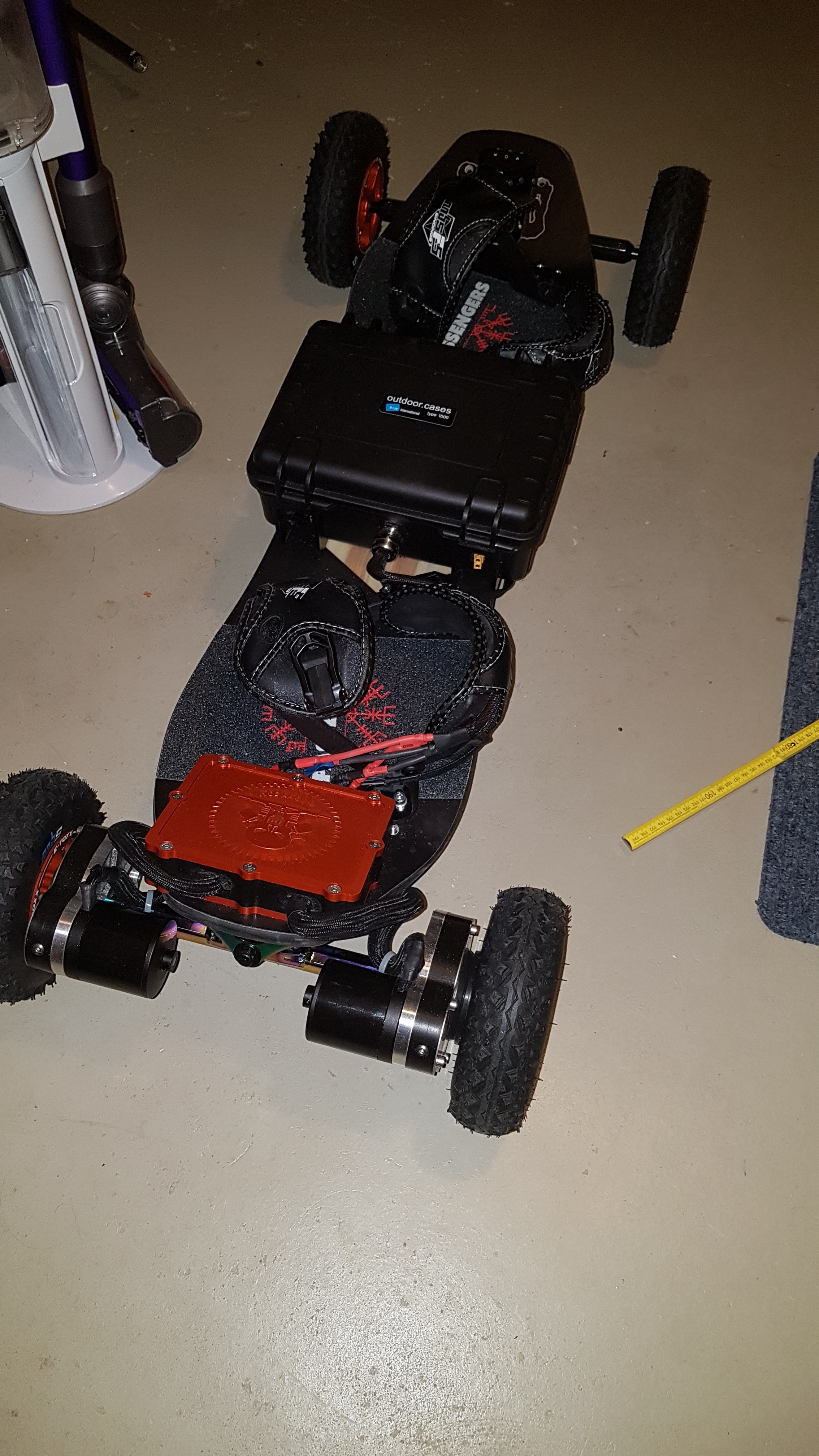

Not an evangelist but I talk from experiance, being the first to put an eMTB together from this deck and covered I dont know maybe 500 miles plus on it since.
It’s a mountainboard bro, built to mountainboard and for its purpose it’s amazing. You saying it’s bad because you cant fit a double stack enclosure on it is like me saying its shit as a tea tray because of the concave. It cant fit a double stack enclosure because it’s a low rider, that gives you control and stability.

The point I was trying to make is it genuinely is a fantastic bit of kit, nobody has a bad word to say about it. Like above, if you want to run a double stack just put some risers on it. :+1:

8mm risers and the higher position :slightly_smiling_face:
I’m going to measure it for ya.
Steeping on some toes there, Bro. But all cool. I think the double stack is doable with a high ply deck like someone suggested before and adding truck risers as @Lee_Wright suggested. Cheers @CiscoV :grinning::facepunch:
8" tyres
camber is ~1cm higher
