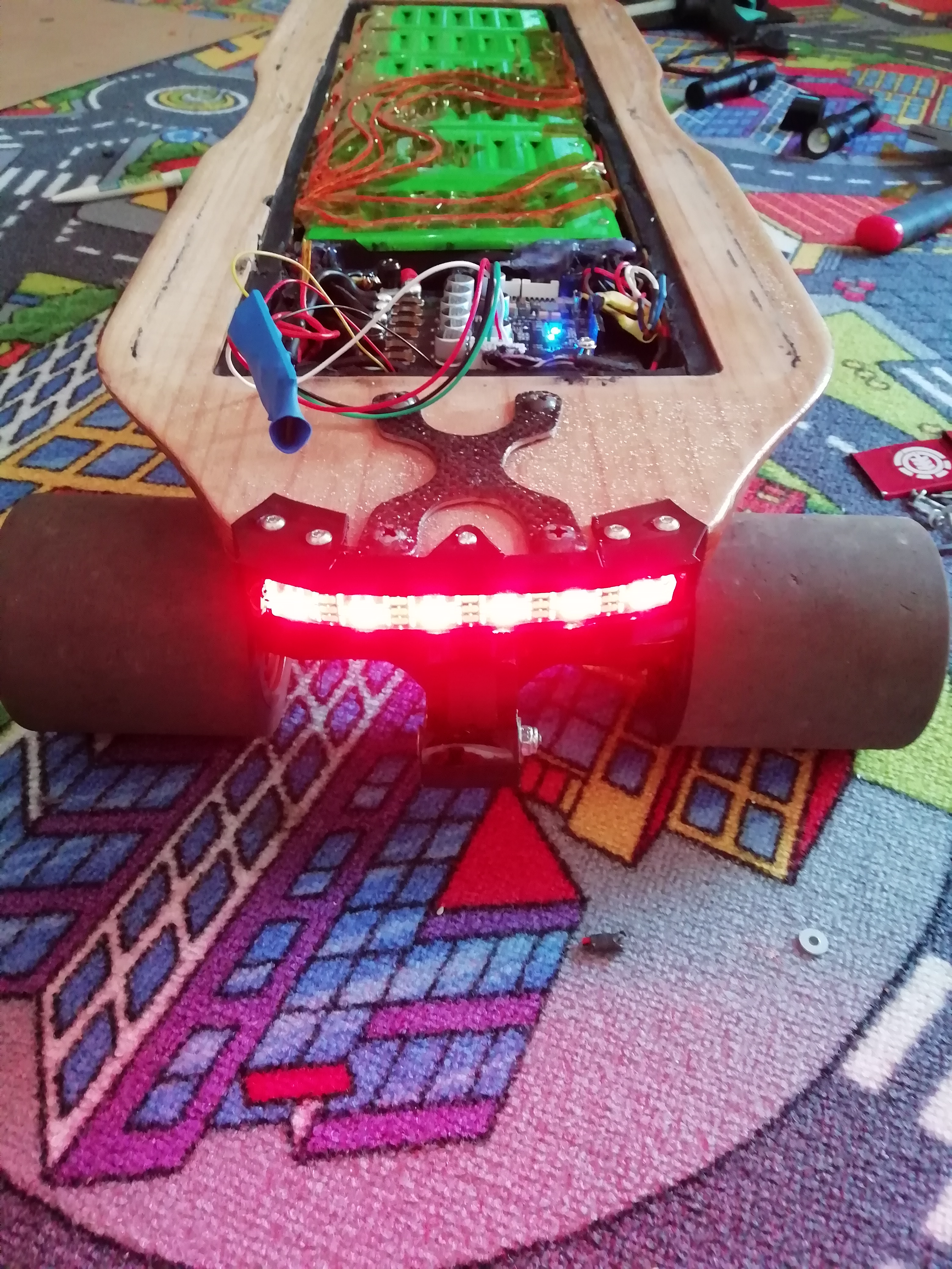

Now I’ll try to get the ppm values and let it react on braking, the more brake the more light :slight_smile: first I tried to use vesc uart communications but it seems that there are no values I could use :frowning:
Sounds good!
:smiley: Actually I think I’ll change plans once more. I got a Gyroscope breakout when I started all this eSkateboarding stuff to implement something like Mellows endless ride. Now I’ll try this to detect braking independently from all other board electronics (apart from power) to avoid interference :wink: For the front lights I got two strong waterproof LED flashlights I’ll mount left and right from the front baseplate :slight_smile:
Well I have seen cheap light on Ali with a giroscope or something inside to detect braking. You could use the circuit for your light.
I just found what you mean, might be an option if I fail miserably :smiley: But the self-made variant could also be modified to detect when it makes no sense to have lights on (eg. carrying). Someone on this or the other forum had a similar idea :thinking:
Yep the auto turn off function would be nice.
I found out that the @Pimousse version of the VescUART library indeed has support for the actual PPM values, so now I’m going back to communicating with the FSESC :slight_smile:
Woowww… As usual that was quick. Great success… Now please make the instructable :grin:
Sure :slight_smile:

Depending on where your PPM signal is in a dual setup you need to use the function UART.getMasterVescPPM(Can_ID).
Thanks @Pimousse for your fork with the PPM values, I was almost sure after research that its not possible to get the value from a VESC. https://github.com/Peemouse/VescUart
You can go at least the double of LEDS with the VESC power supply (as you’re using only the red color)
12x20mA = 240mA. Still room left.
SmartRings (with 12 RGB leds used for gauge + 8 for rear light) can be powered by the VESC also without any trouble.
Seems feasible also for me. Nice! Thanks

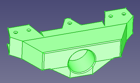

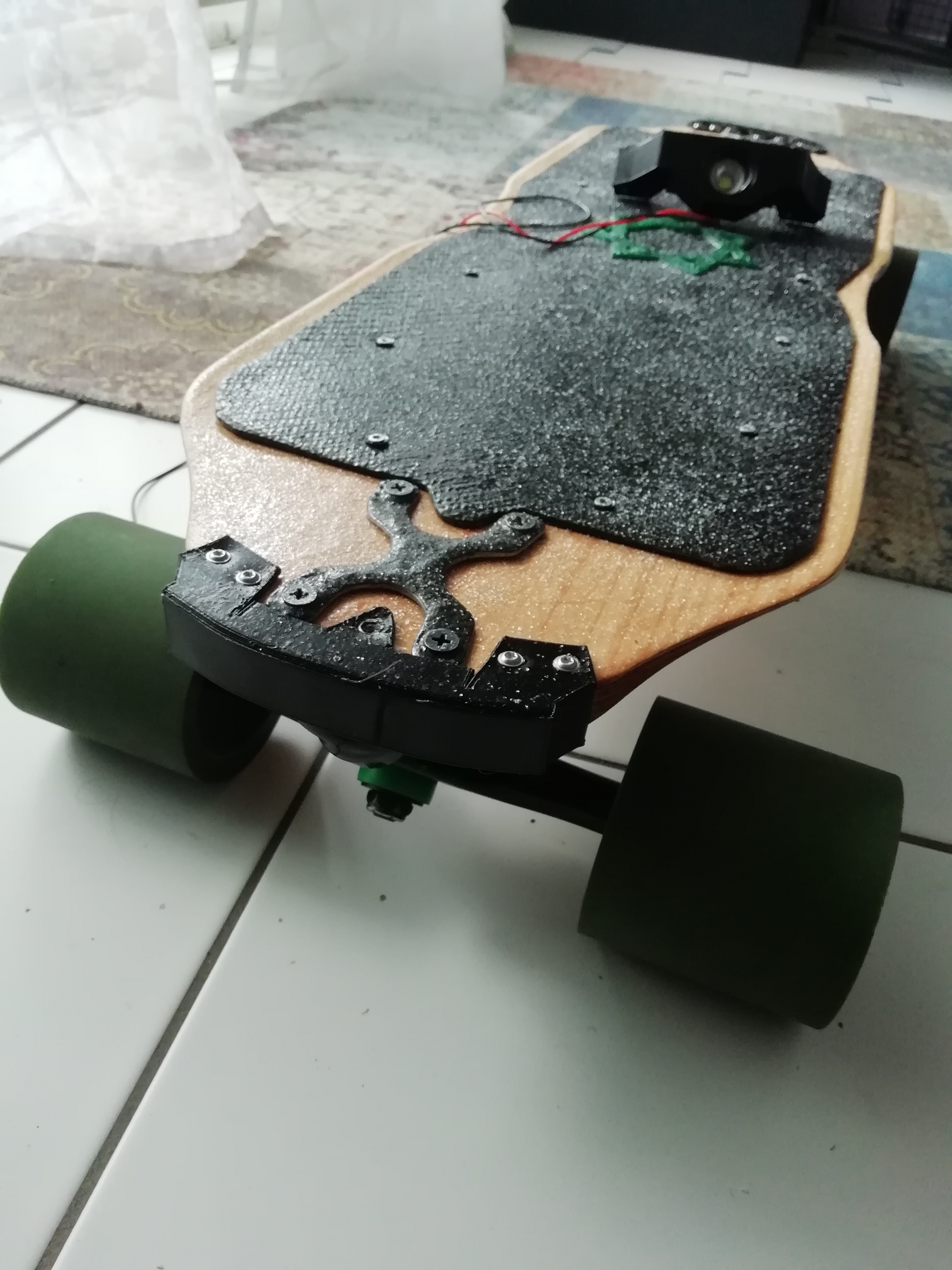

New front bumper design with headlights :), printing at the moment. I disassembled a LED flashlight just for the LED and the reflector, lets see how it turns out :slight_smile: The flashlight is very bright but thats just my feeling :smiley:
btw, I thought of a nice method of switching the lights on and off: pressing brakes while standing for 5 times in a given timeframe :wink:

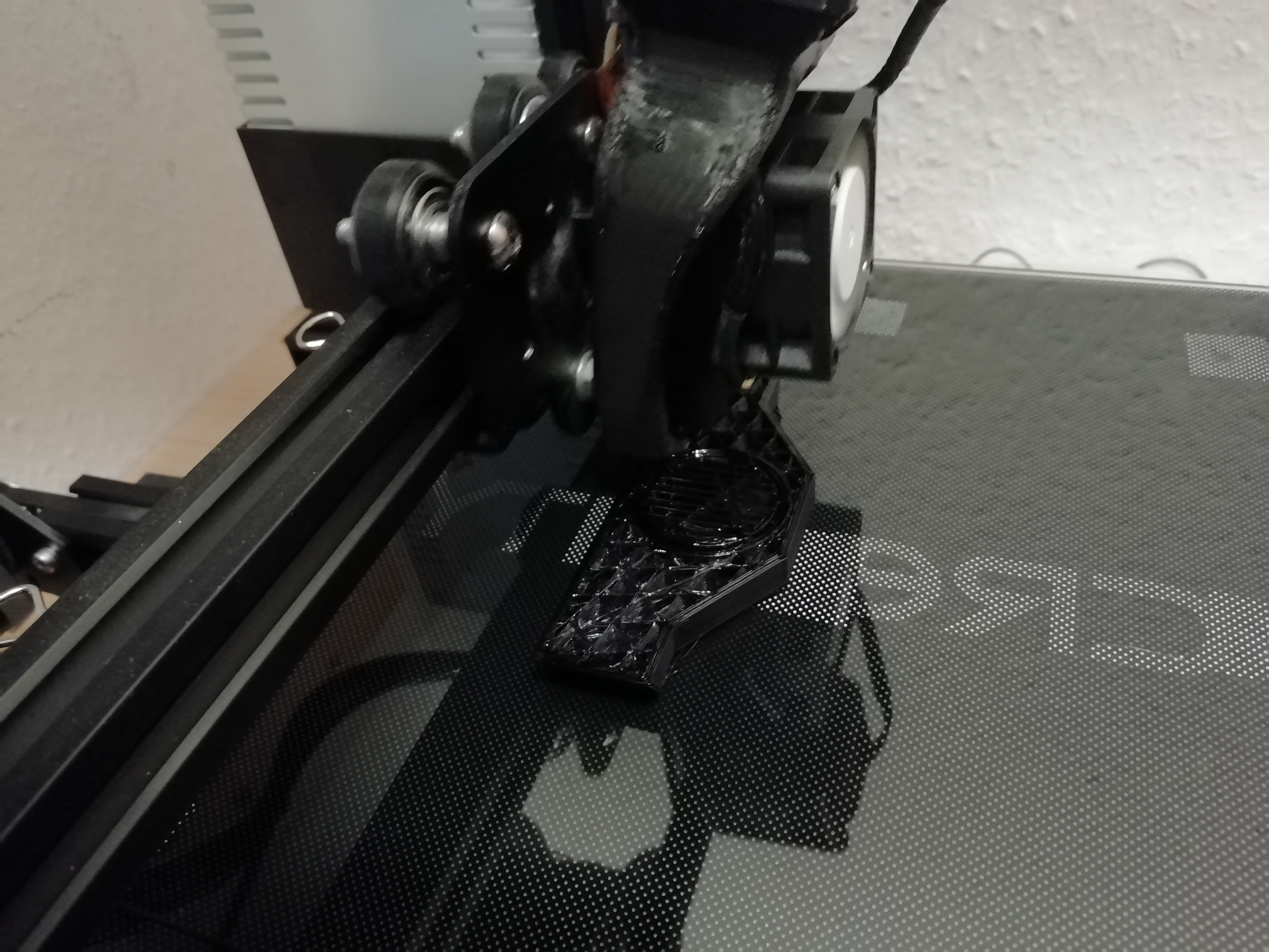

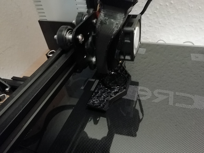

Its printed as usual: 20% infill, 4 wall/roof/bottom layers 95A Sainsmart TPU (which is incredibly printable btw). The infill value result in an airfilled cushion, not comparable to the standard bumper stuff. The board bounces back from walls :wink:

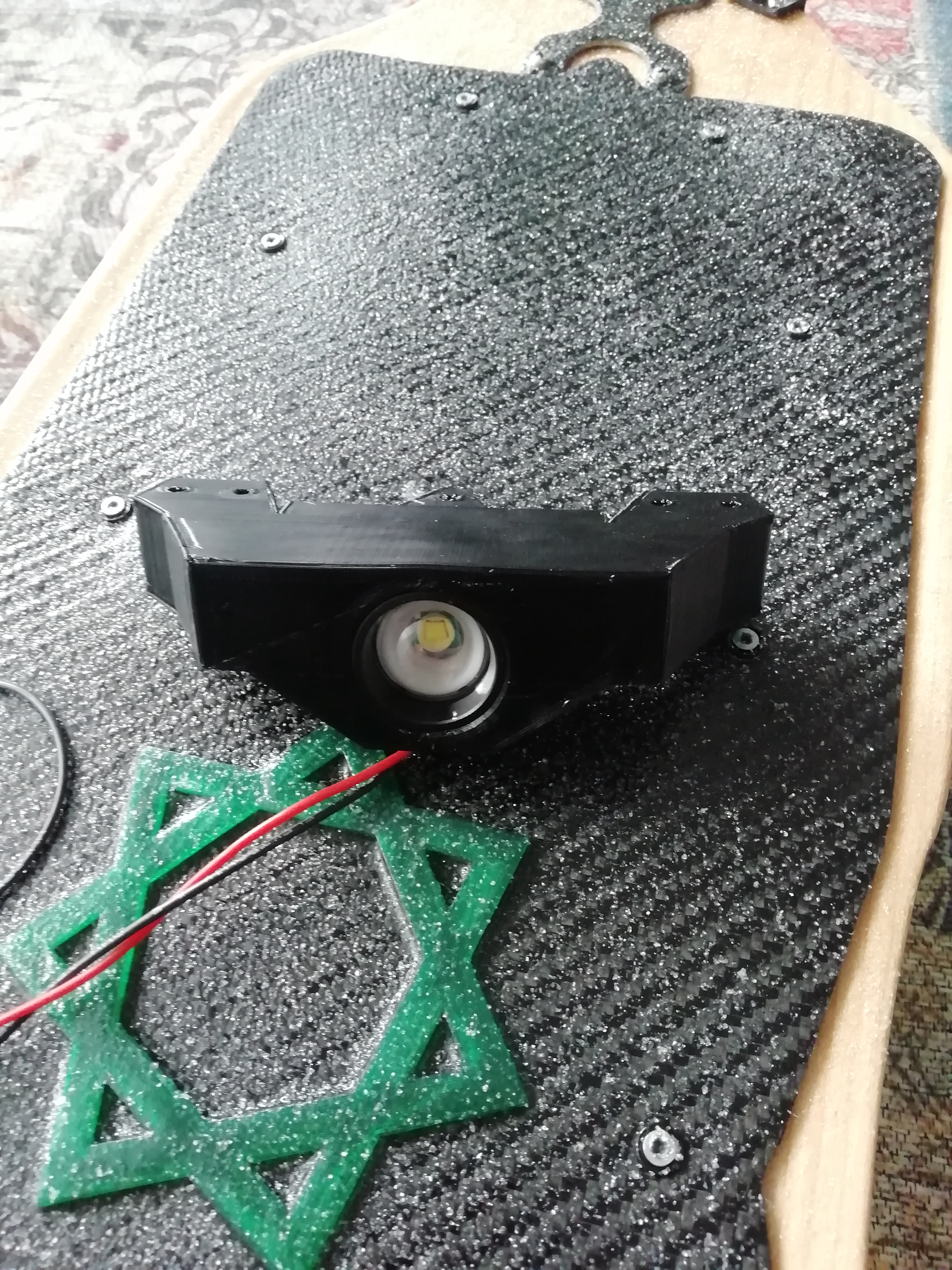

My new bumper, not sure if its still bumping but its making light instead :smiley:
Before:
After:
I’ll run this LED with a up to 56V LED Driver with 1A, the arduino will control Amps via PWM. I figured that brightness is similar if not the same as before when it was a flashlight, temp goes up to 45deg celsius which is still ok, but lets see how powerful I need it to be :slight_smile:
