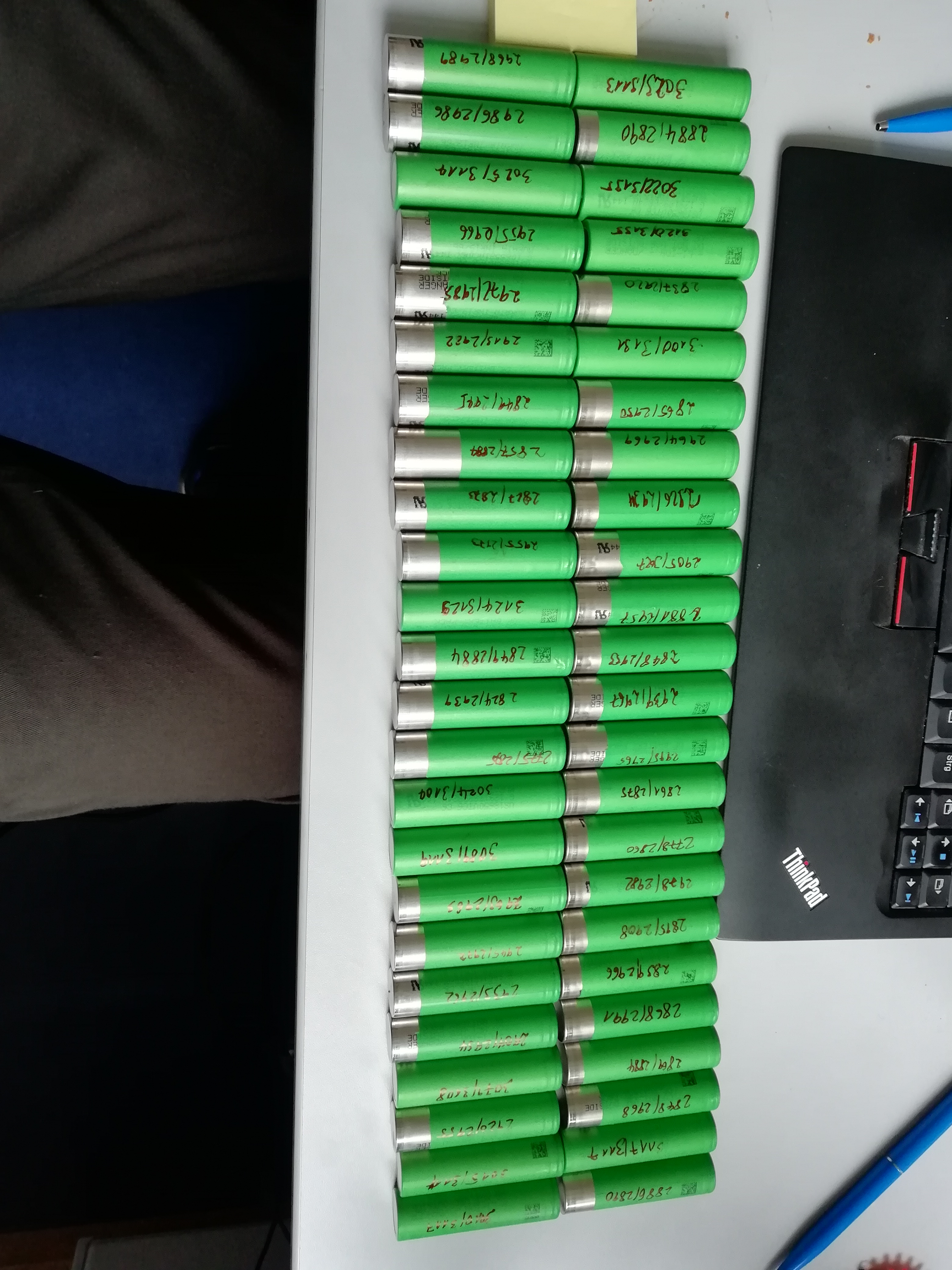

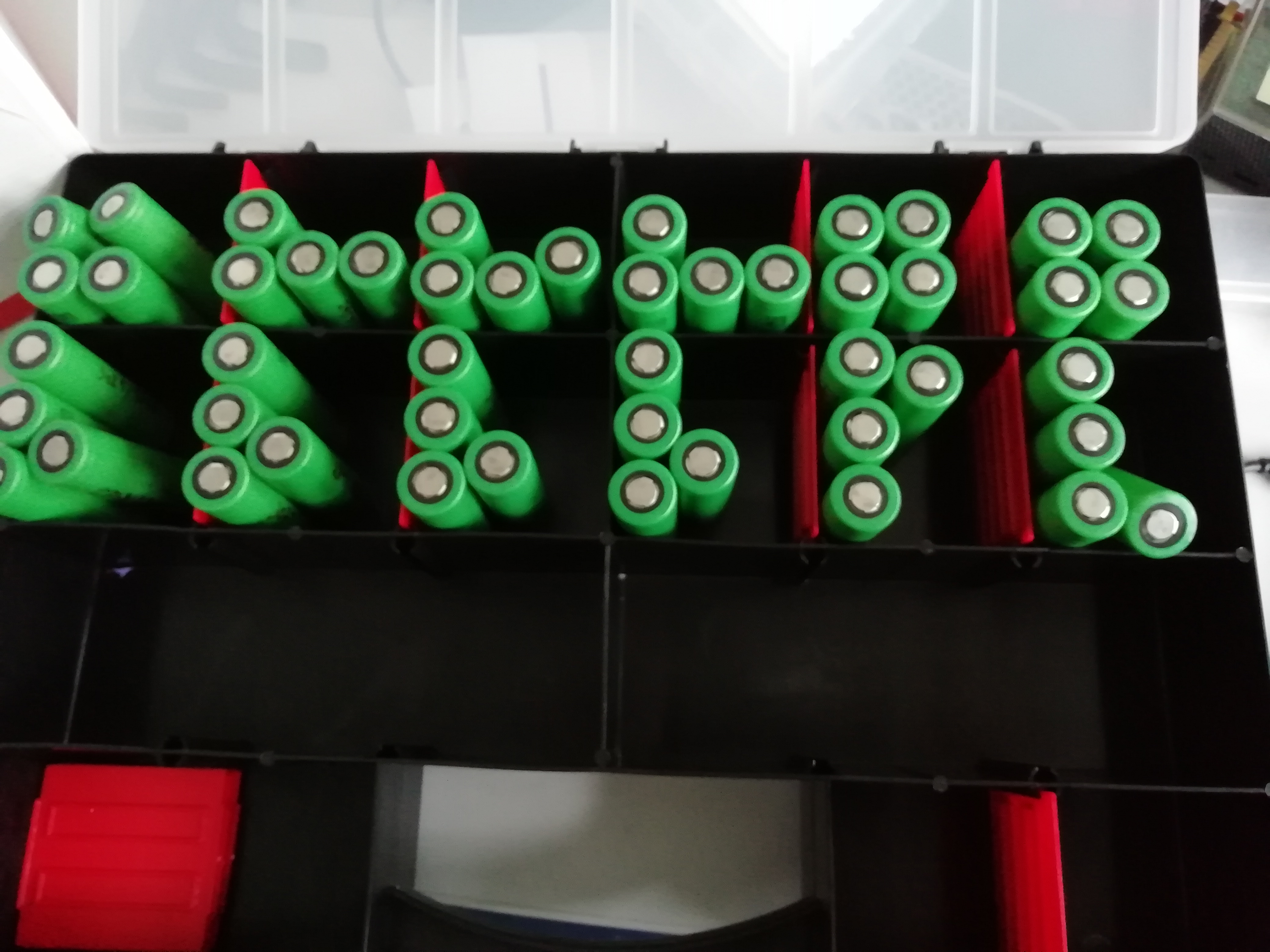

Now that I have a spotwelder (bought it for the new boards battery) I ordered 12 new cells since the deck itself fits a 12s4p in the same volume of 12s3p with NESE when spotwelded :slight_smile: If anyones interested in really cheap used NESE pm me :wink:
12s4p here I come :sunglasses:
on that small board is gonna be a lot of power! nice…I thought you anted to keep it lighter since you travel a lot with it.
weight is not a problem, as @Grievor stated, its my gym :smiley: handling/size is more important.

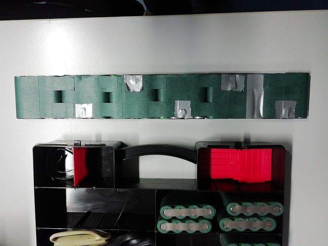

Actually (after some thinking) it is around 200gr lighter since an empty NESE weighs 125 gr (->750gr total, 12 cells -> 560gr) I also want some modularity so I’ll go for connectors between 2s4p groups to be able to split it in 6 <100Wh packs
Repackrd :sunglasses:
One half done:
Lol, I didn’t this time :sweat_smile: the probability of flying is quite low so I just connected the with triple layered nickle, if I’ll fly I buy some cells and use the 12s3p neses I still have :wink:
