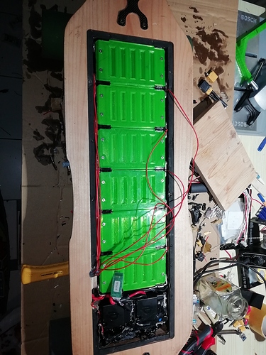

Today I check how I’ll integrate the charging stuff. I still want a capacity/amps enhancement battery that I could plug into the charging port so I need to get that QS8 connector and a balance port in the deck somehow :face_with_monocle:

You mean on the last photo? I implanted a bulgin buccaneer panel connector with 11 wires for my external balancer. First I use a forstner drill for the surrounding area to have a even face and then a big wood drill for the plug. You’ll see :wink:

Balance and charging more or less done:
Nice and clean. good job. I found some glass frit from ebay uk I think really cheap, I can check if you need it.
What did you use to seal the battery, silicon? and the black one is?
The black stuff is black hot glue, the battery isn’t sealed, I taped the balance wires with kapton.
