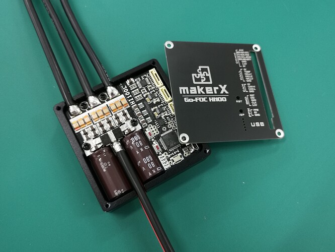

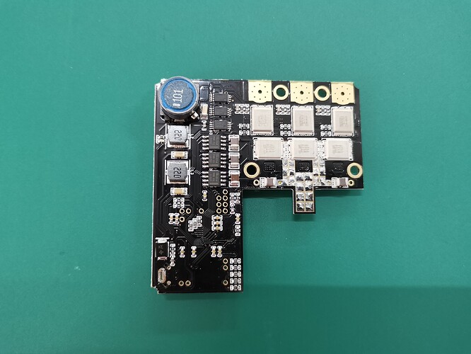

Pop the hood, lets see some PCB porn
The pcb is from yongitech.
But more pictures is always nice anyway😊
Hm, thats 18W of heat dissipation per fet @ 100A. Heatsink feels bit small to support continuous 100A?.. which totals to…72W on one switch cycle (when nearing full duty obv)

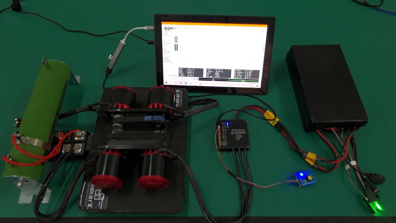

Any dyno tests @YUTW123 ?
I wish I could see the screen :grimacing:
The details can only be seen from youtube on a computer. The video is shot in 4k and it’s all visible.
The test is with 12s and not 16s though so who knows what could happen at higher voltages.
It looks like it holds 85A continuously at 77degC
At 150A motor current and 71A battery current, it puts out 3180W for 7s before hitting temperature limit.
The fact that it did not blow up has got me seriously interested :slightly_smiling_face:

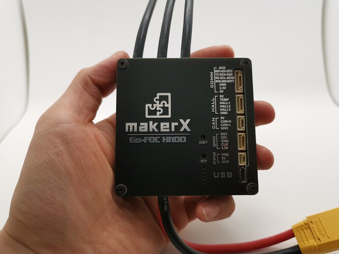

anybody else snag one of these? just fired mine up and its seems like the sensor port is all jacked up.
Yep, no 5v.

His situation is that 5v cannot be output. I have been communicating with him.
It seems to be caused by the socket soldering
