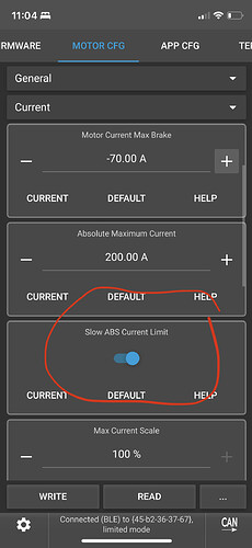

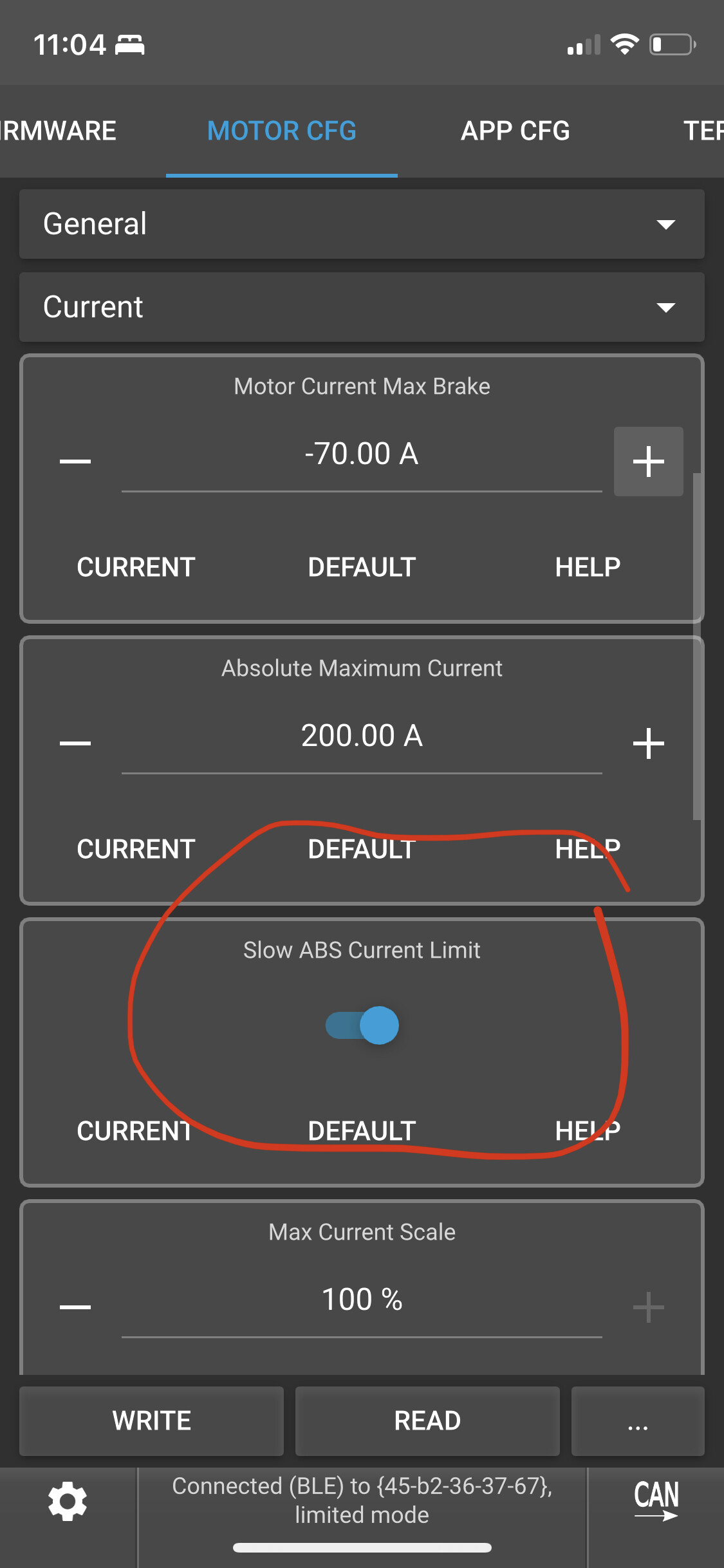

G300. Please use version 5.03 firmware. The new 6.0 firmware has problems ABS current error and unstable duty cycle in my test.

Firmware 6.00 sets the MAX_ABS_CURRENT during motor detection to 1.5x the estimated motor current max. This may be too low and can be manually increased.
Older versions used the value specified in the .h file for that hardware.

I compared 5.03 and 6.0 firmware. same parameters. The current of 5.03 can easily go up. And the 6.0 firmware current reaches a certain level, the motor will shake and trigger ABS error. I’m not sure where the problem is, I’ll test more.
Check your ā€œslow ABS current limitā€. It’s probably off and it should be on.
Fw6.0 has set this for me incorrectly and I had the same thing happen.
