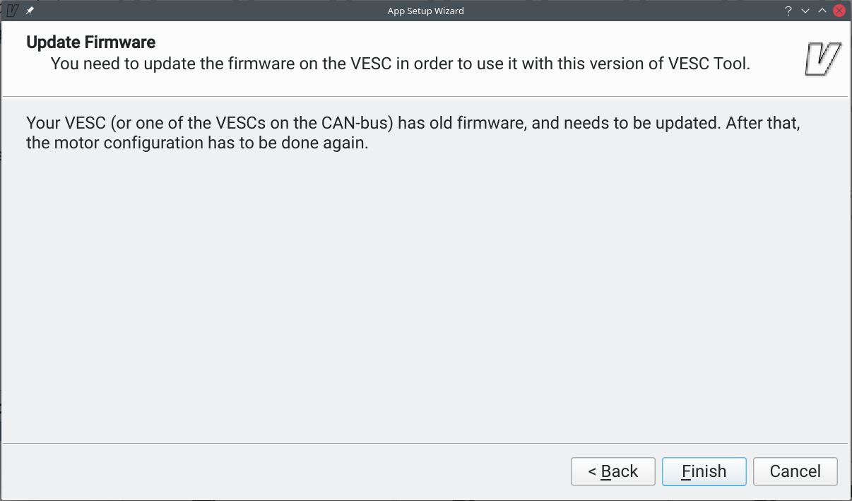

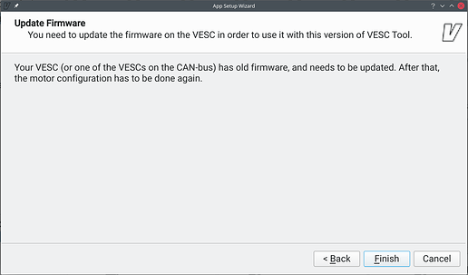

I am having some issues using vesc_tools 3.0, after connection I see the following message:
The connected VESC has old, but mostly compatible firmware. This is fine if your setup works properly.
Check out the firmware changelog (from the help menu) to decide if you want to use some of the new features that have been added after your firmware version. Keep in mind that you only should upgrade firmware if you have time to test it after the upgrade and carefully make sure that everything works as expected.
When I select ā€œFirmwareā€, I see ā€œ60ā€ for Hardware version and ā€œVESC_default.binā€, after uploading this to ā€œAllā€, when I reconnect I see the same message as above.
This would be fine but I am unable to setup the Input using the connection wizard. It is telling me I need to use the latest firmware first.
Question: How can I install the latest firmware (version 5.02)?
Also I did save my original configuration by going to the menu ā€œConfBackupā€ and saving it and then restoring it after updating the firmware, which seem to be version 5.01 (already install), but I think the VESC tool is looking for version 5.02
One other thing I notice after I do an ā€œAuto connectā€ I am told I am connected, but in limited mode? I never seen this before.
This appears to be a recurring problem with the new vesc tool, best take it to a vesc tool thread rather than here as I don’tbelieve this problem is hardware specific.
Thanks I went back to the previous version I had and it’s all working fine.
Read my post about installing the bootloader before doing an update. It fixes that issue.
ā€œI usually just install the bootloader since that is somewhat the cause at times. Happened to me on my retro. It said it wasn’t updated so I hit the bootloader and it worked.ā€
