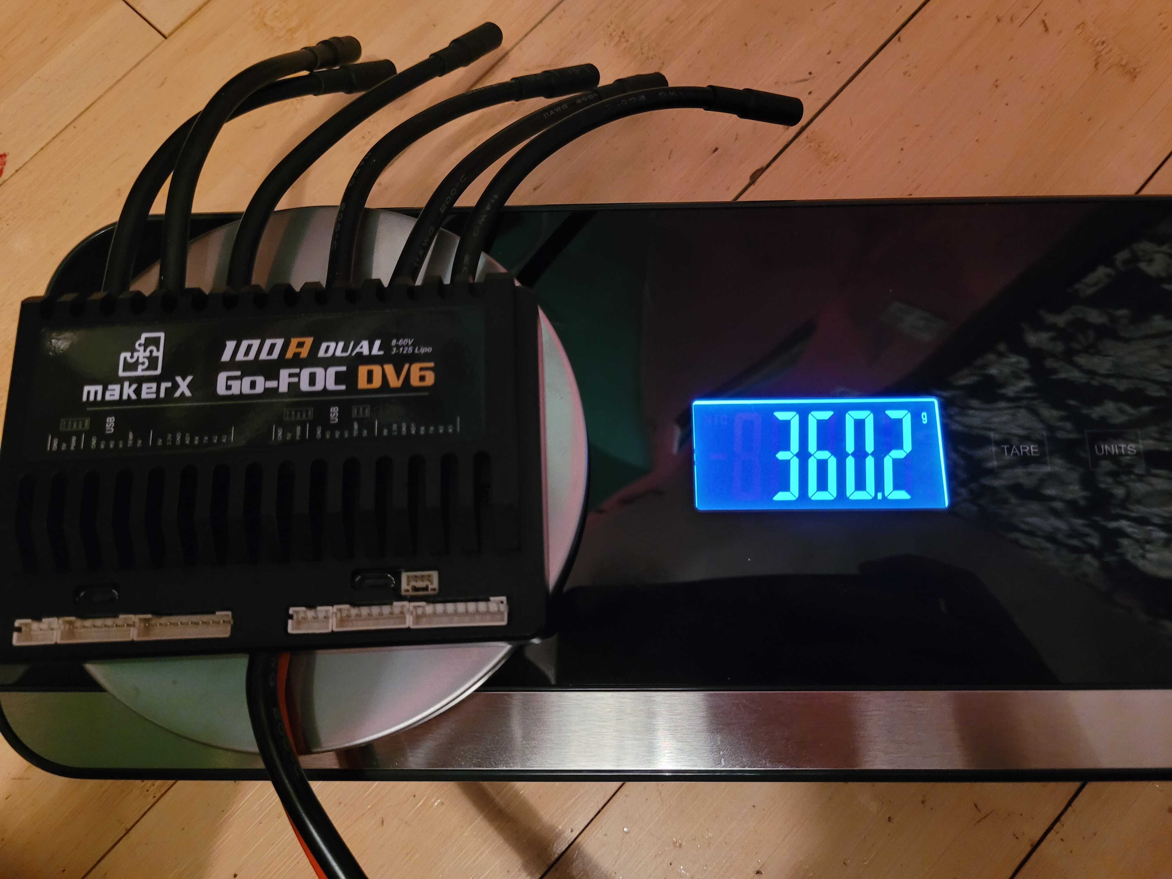

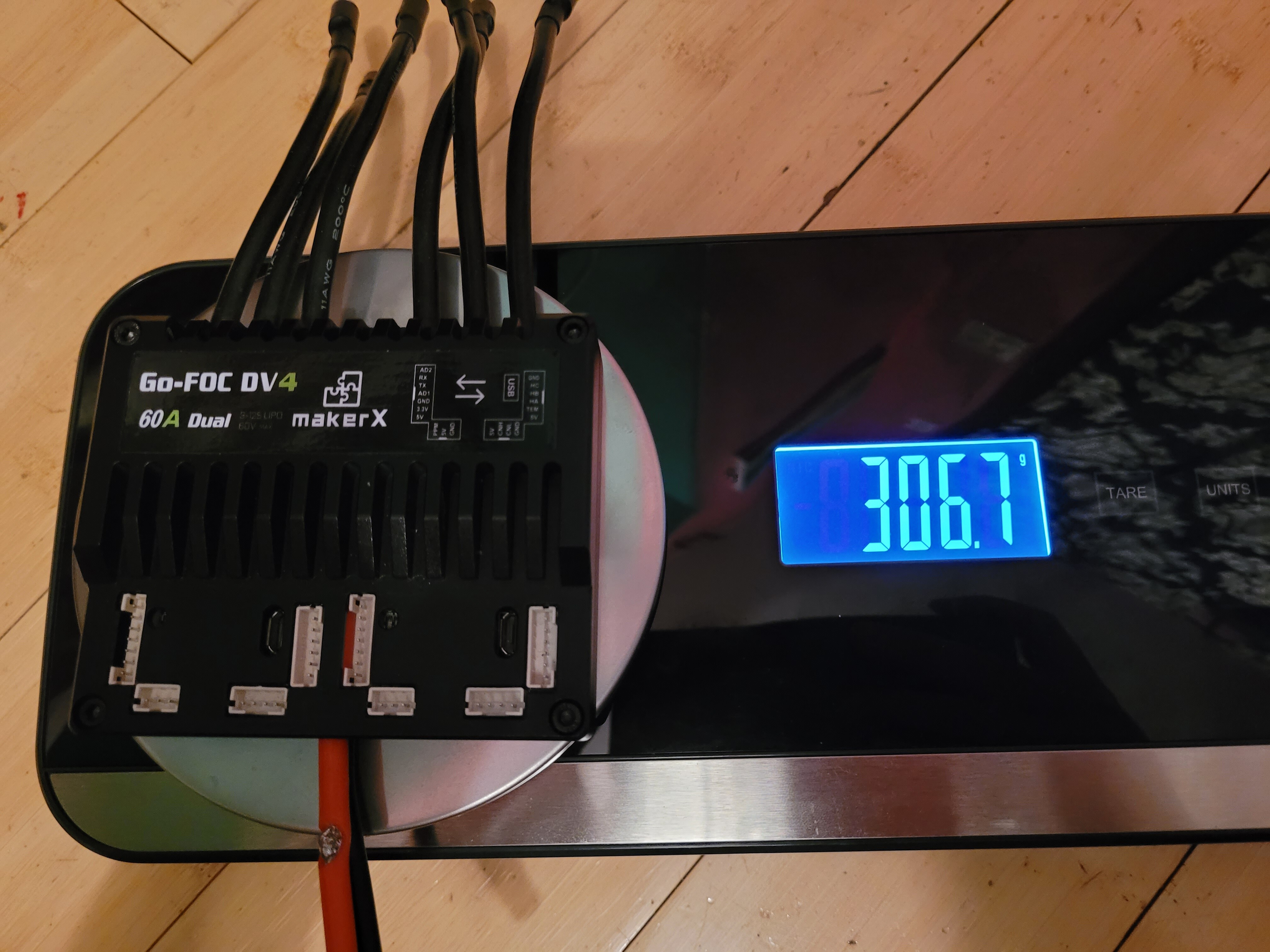

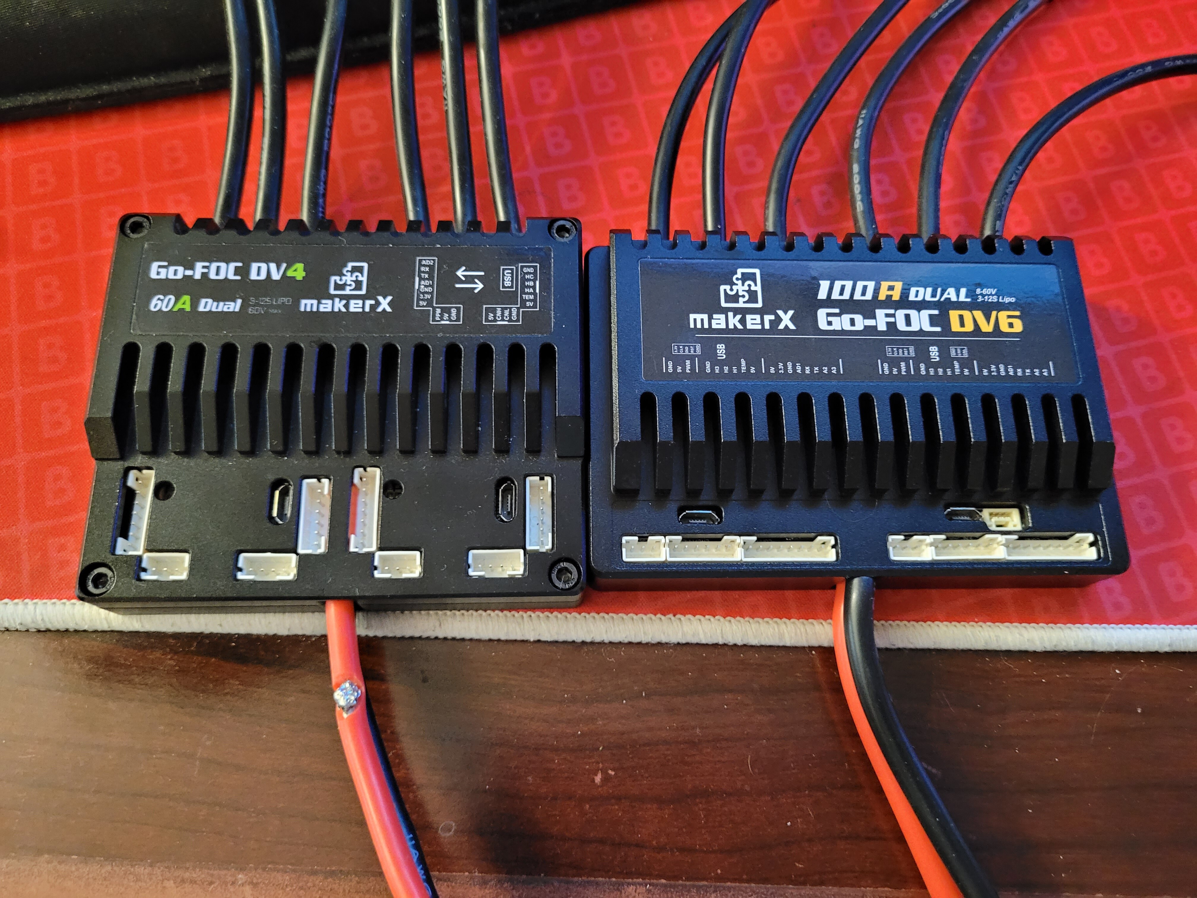

Wow the heatsink for the dv4 is quite large
Both Vescs weigh about the same too.
You got a good esc there.
Interesting, the old version of the dv4 was very different
Do you have a pic of the old DV4?
Not really, it’s inside a board right now and doesn’t have a heatsink lol
It didn’t come with one back then to be fair
Hmm that’s interesting. I’m glad it has one now though
Actually I did have a pic in the build thread
Hmm its completely different too. Hopefully from here on out every vesc will come with a heatsink.
