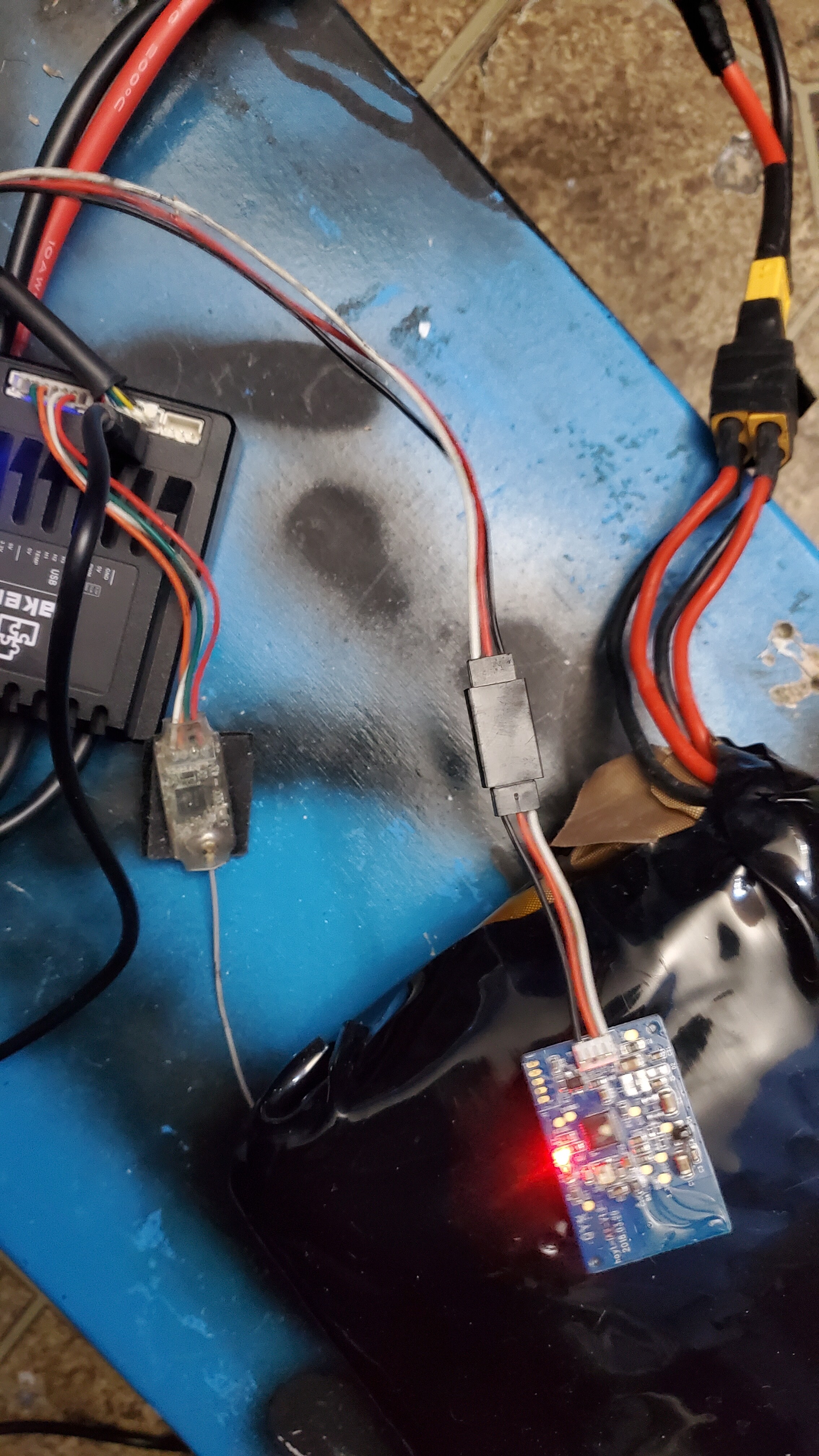

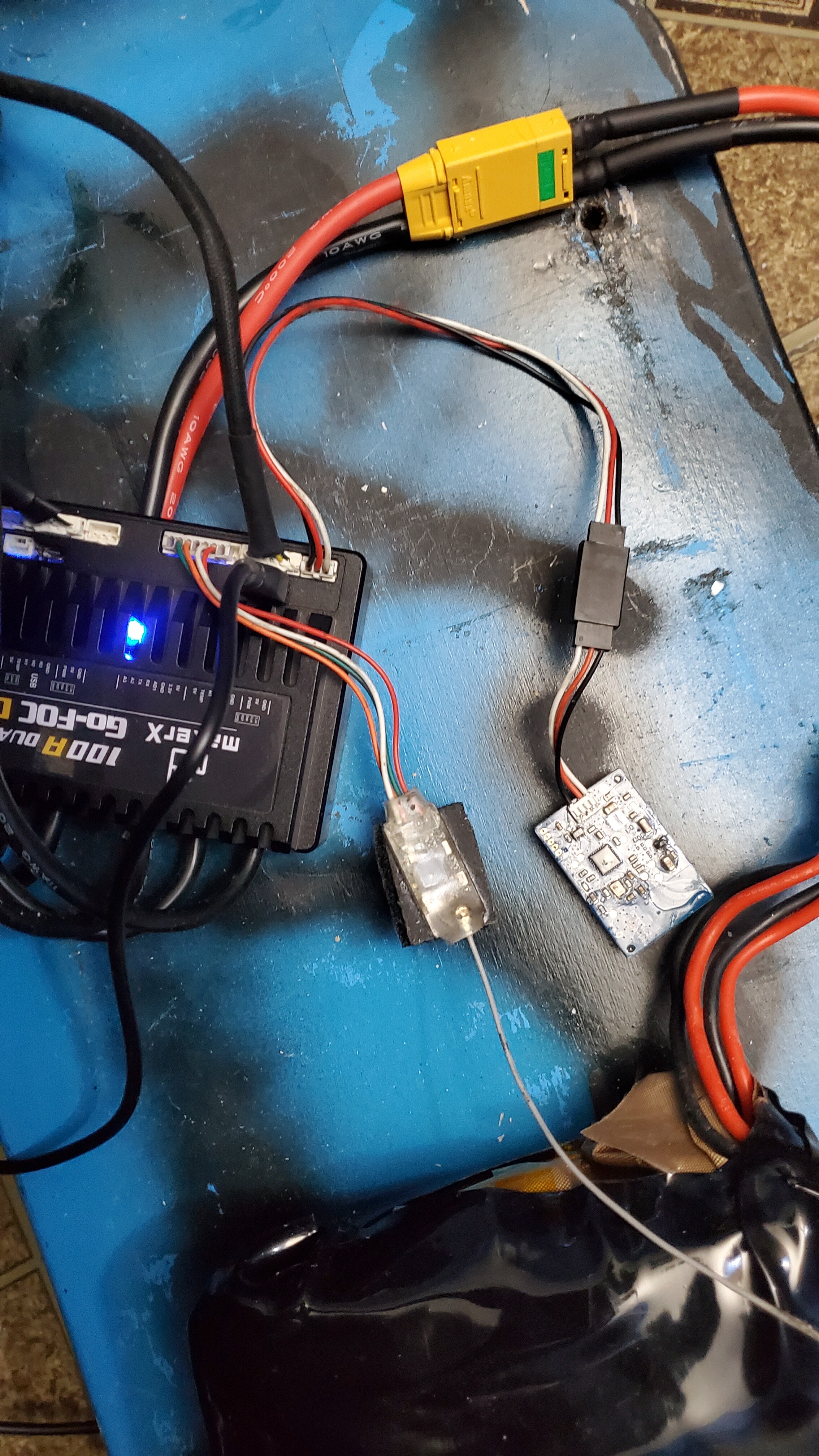

So, I got my DV6, however I have an issue with both the ppm and uart systems…
Why aren’t these working?
Edit:
The wire indication were backwards for this esc…
That was so lame…
How do you mean backwards exactly? Like the pins were reversed? The silkscreen was wrong? Or, what? I’m going to set mine up soon and don’t want to accidentally fry my metr lol
In the Retro, it was red white and black to the same connectors. But on this esc, you might need to pay attention to the stickers since now it’s kinda reversed. I just flipped the wires and it works…
Weird huh
Both are working now. So remember this, if you’re moving from one esc to another, it’s not always the same connection wires…
