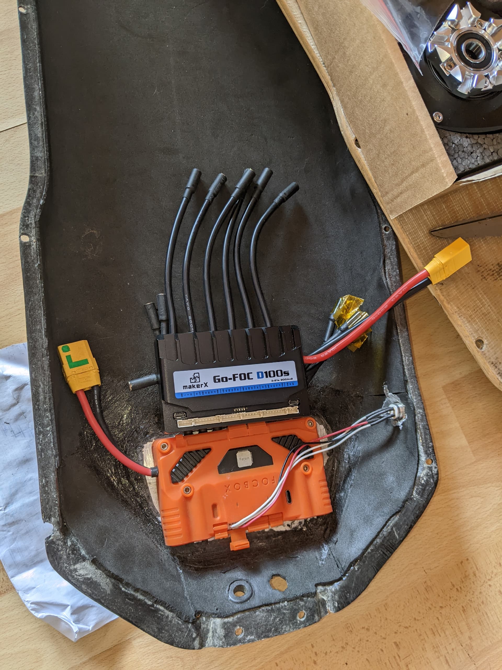

This ECU is so tiny… awesome work…and also thx for 5 days delivery time from china to germany…:+1:

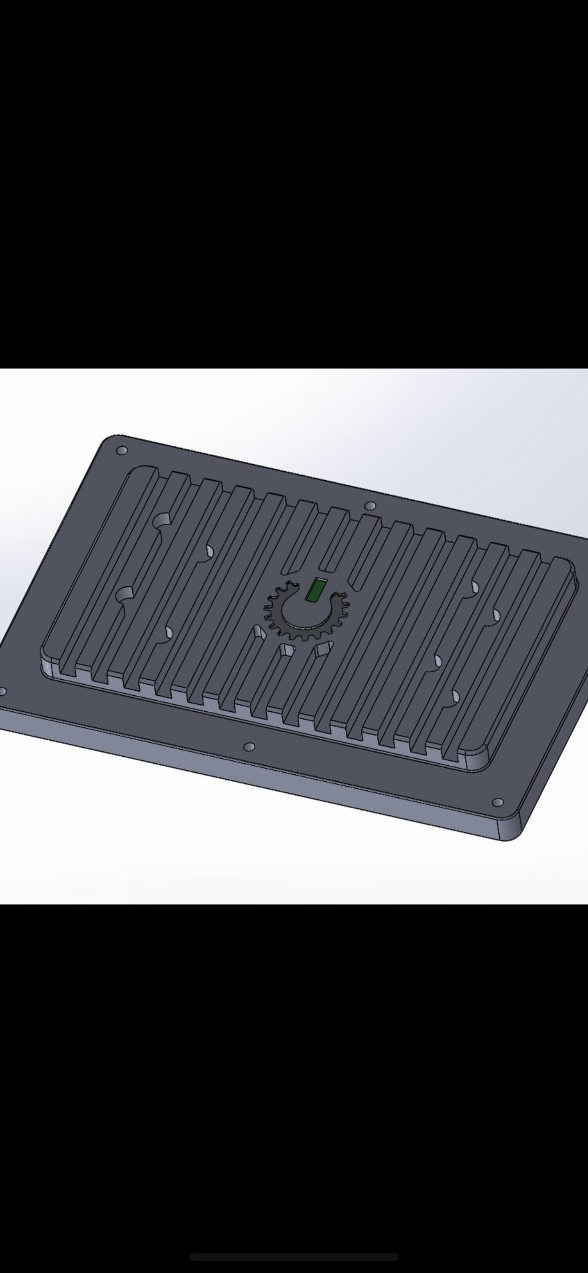

Updated our thick heatsink to support D100S and DV4S:
Will be ready in 2-3 weeks

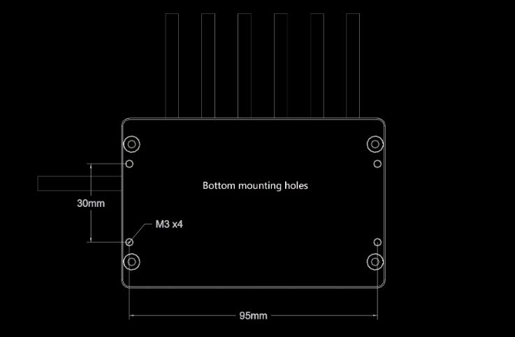

Note that we have modified the DV4s shell to be the same as the DV6s and have the same mounting holes.
And the previous version will no longer be produced.

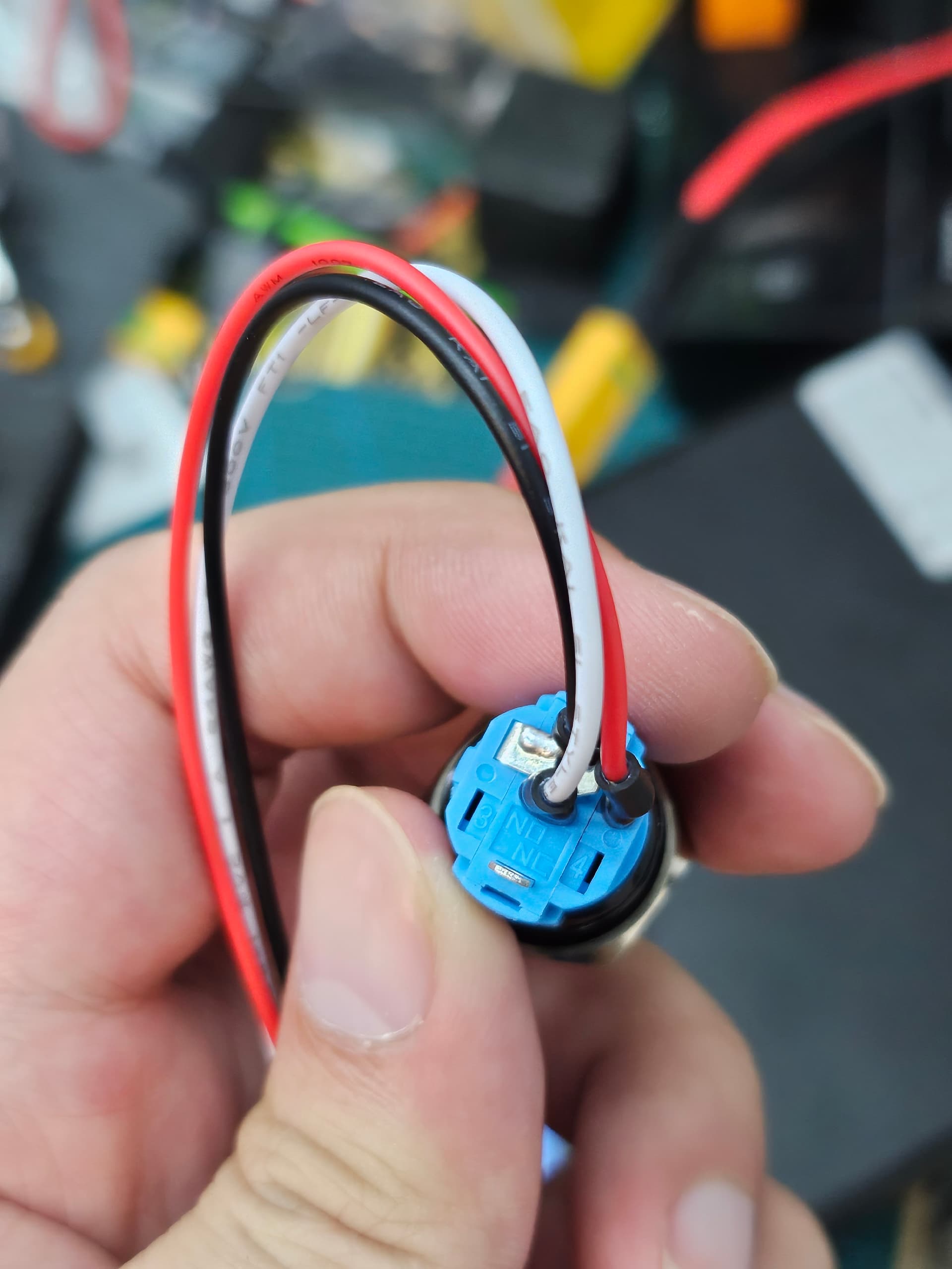

The D100s DV6s DV4s, have been modified to normally open buttons (located on 3pin port).
While the D75 DV6pro etc. using normally closed buttons on 8pin port.
Normally open buttons have more options!

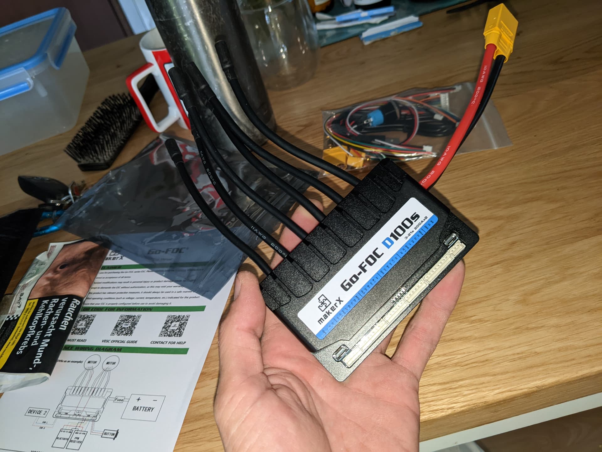

So this 2 should cover them? DV4S and D100S
But my d100s is normally open (NO) button? Please clarify
I also tested the button and confirm it is NO type
Sorry. Typo. D100s button is normally open.

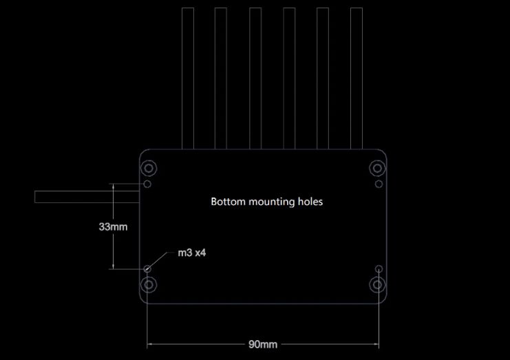

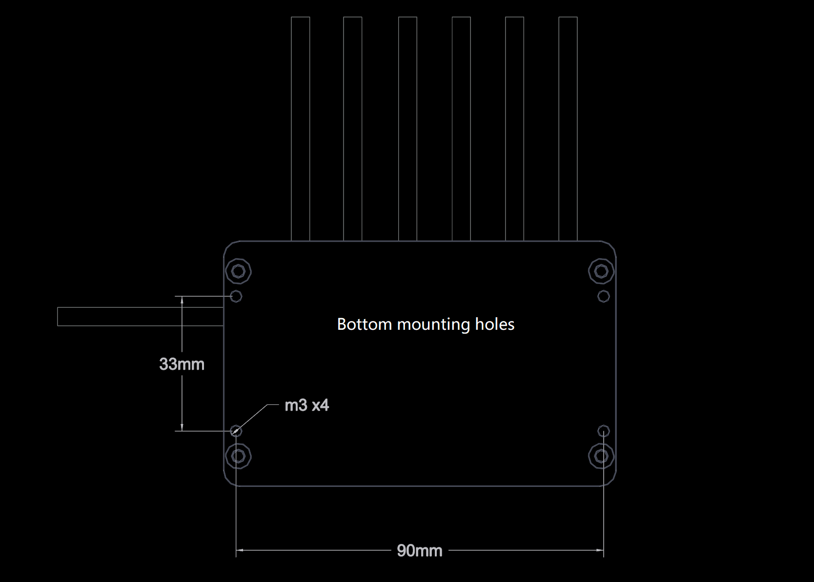

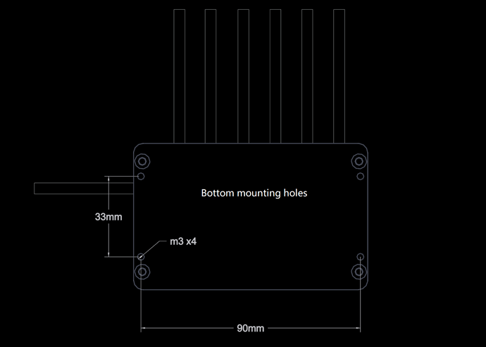

33x90 This one is the latest.
