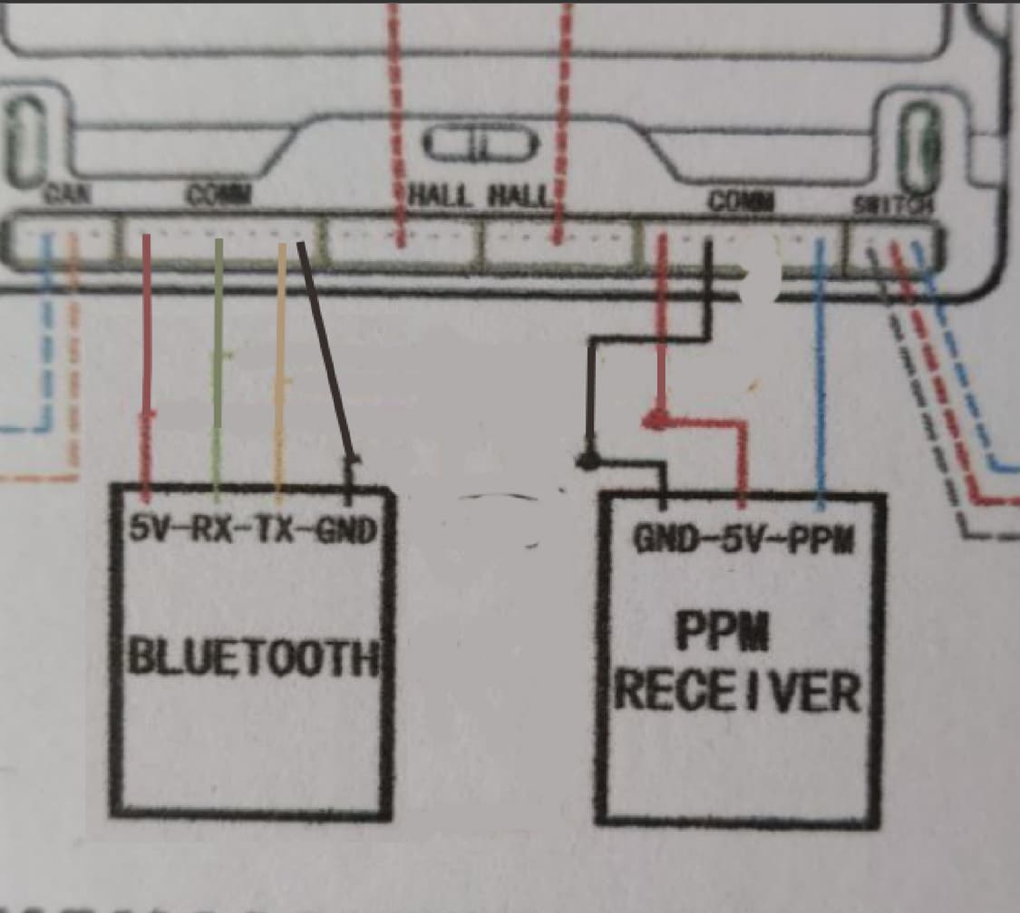

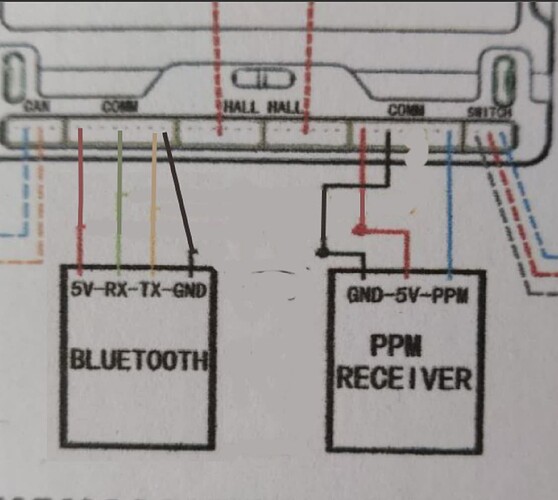

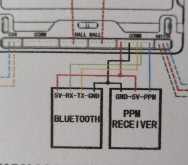

In the documentary of the DV6s you show that the BLE and PWM Receiver share some pins on the right side of the esc. There is no adapter included, is it up to the user to splice them together?
Part2: Can’t i just use the BLE on the Left COMM Port and just the PWM Receiver on the right COMM port?
instead of this:
do this?
and if no - why not.
Question 2.5: What are the Buttons Labeled “ISP” on the PCB?
