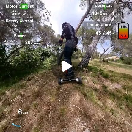

I’m using the D100S with 360KV inrunners at 20S.
Forest and dirt, with 9 inches wheels.
No issue after having set Traction Control to OFF and Absolute Max Current to 420A.
In spite lots of burnouts in dirt. Enough to kill the Loctite 648 on motor sprockets.
Very good start up with HFI. The same I could have with sensors even in dirt. HFI was easy to set properly. Phase Filters are set OFF as advised by MakerX.
I’m very satisfied with it.
I am pretty sure you are supposed to have phase filters on for the D100S and off for the older D100.
That said if it works well don’t touch it
Those are probably 4 pole motors and not 14, so end result is a lower ERPM, easier on the controller.
That said… Good to know inrunners work well!
« filter is not available on HI200 ,HV200 ,HI100 D100 M100,If you are using official firmware, Please turn off the phase filter
Ok because of this page I have set them OFF. Anyway as you say I won’t turn them ON since it works great like that.
With 2stage gear drive from E-Toxx, it’s amazing!
