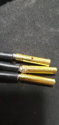

Is it possible I must have soldered the 4mm bullet connectors on the esc phase wires improperly or heat leaked into the esc hardware? I took it out of the heat sink and had a fan blowing on the PCB wile I was swapping the bullet connectors.
I didnt cut the phase wires or anything. They seem pretty damn solid IMO
