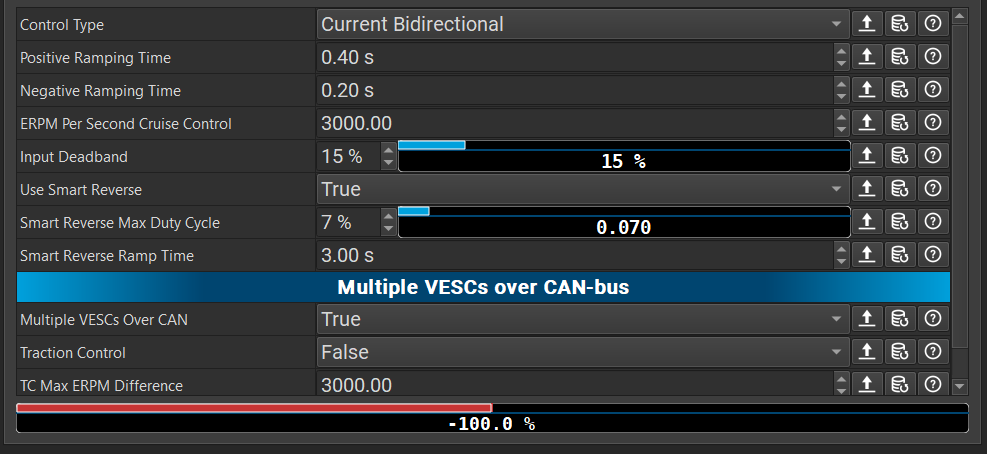

Yeah mine just stays stuck at -100%, and vesctool freaks out when I put it into UART control mode :person_shrugging:

Well, my case is special. It’s a CANBUS remote that uses the vesc remote app.
