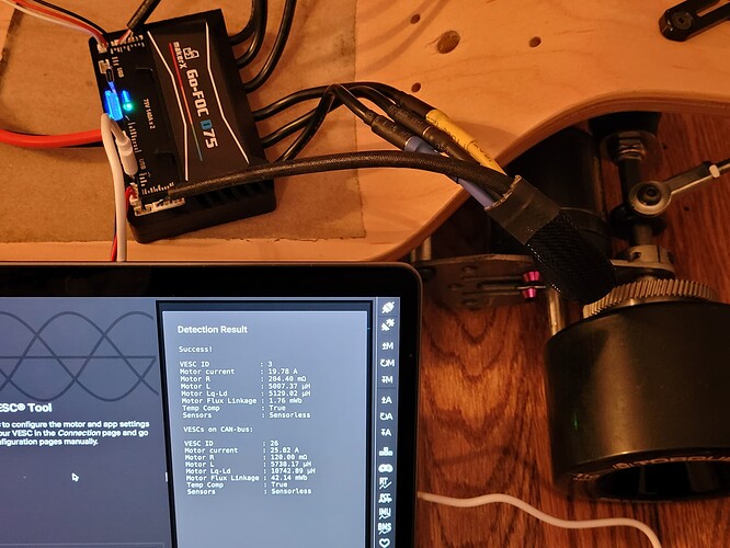

Having issues with D75 1st batch.
I set max motor current to 180 as makerx advised, disabled phase filters, started motor detection wizard, amd chose NO to accept default motor settings.

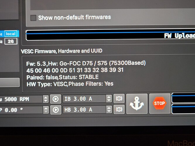

Using the FW on the d75 that it arived with.
The detection process is silent, motors never spin but the results show success.
What am I doing wrong?

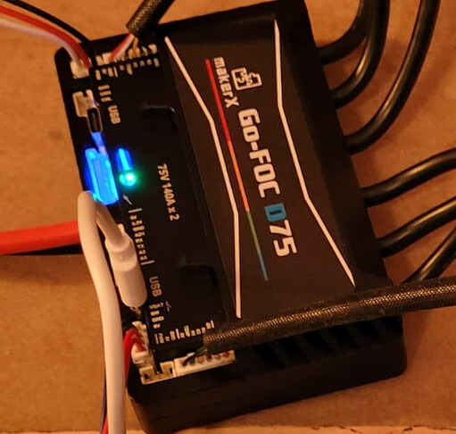

Also, how does this power switch work? I can’t get the esc to turn off.
I uploaded the custom FW that is available for the first batch of D75 from the Maker X website. Mine detected fine first time. Maybe try updating your FW to the custom FW.

Second, make sure you’re on the latest makerx firmware

The stock button has a very deep throw, you have to push it in very far to turn the ESC off.

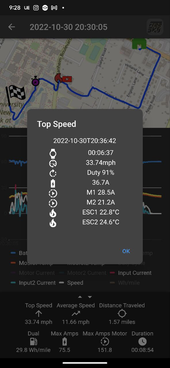

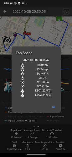

I dont wanna leave this on a bad note either. I just got my 16s mountainboard running with my batch 1 D75. Running 80 motor/50 battery amps per side on 205kv motors/6.42:1 ratio/8inch tires makes such an insane amount of power. I cant recommend high voltage enough.
