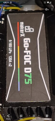

Seems like it because people can run 115 motor amps on the d60 but I got an ABS overcurrent running 110A on the D75 at 16s
Just regular 4wd.
Total wattage and most components are the same. D100 is only 100 phase amps ber side while the D60 does 160 phase amps per side. The D75 is in the middle with 120 phase amps per side.
I have personal experience with the D75 faulting at 110 motor amps. Id say its limited to 100A safely.
Where did you get 120A from?
I think that’s the website spec if I recall
Idk, something about “official specs” I’m not really qualified to say…
I’m successfully running 115A per motor on 12s with a D75. Hoping it handles the same when i move it to 16s build soon. Time will tell.
