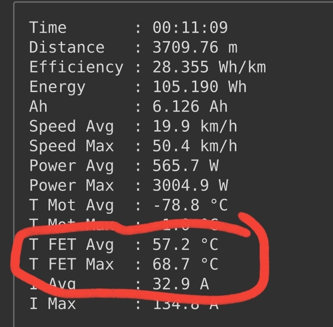

First proper ride on a Bikeway today I was hitting 78c with the new d75 a bit easily. Unsure if that’s high or normal? Just thermal taped and pasted it now to the original hobbywing plate hopefully that helps. It was kinda isolated before.
After how long was that?
That’s a tad warm, what are your settings?

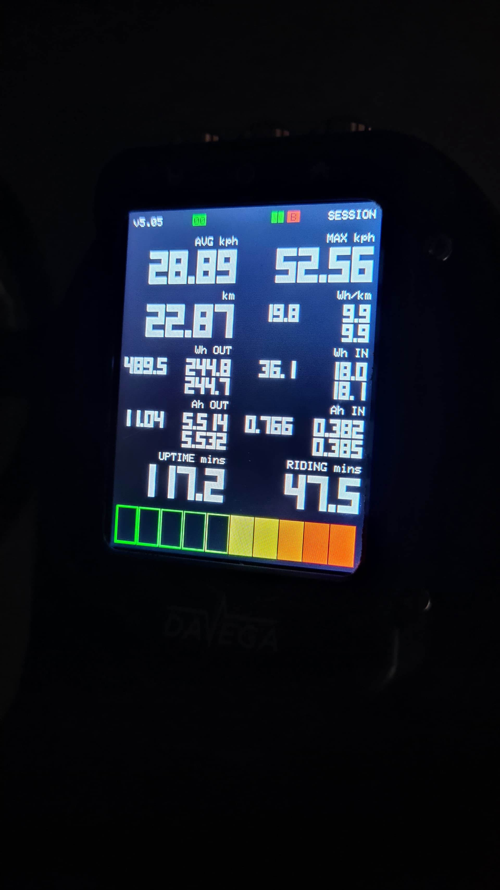

I did a long ride yesterday in 30C ambient. I definitely wasn’t going hard but I was quite impressed with how well it did
28wh is up there… is that the 16s?
I was only around 20. 100 motor 55 a side battery. With the 12s5p.
Yeah 16s, d75
I think i’m at 80 motor, 50 battery

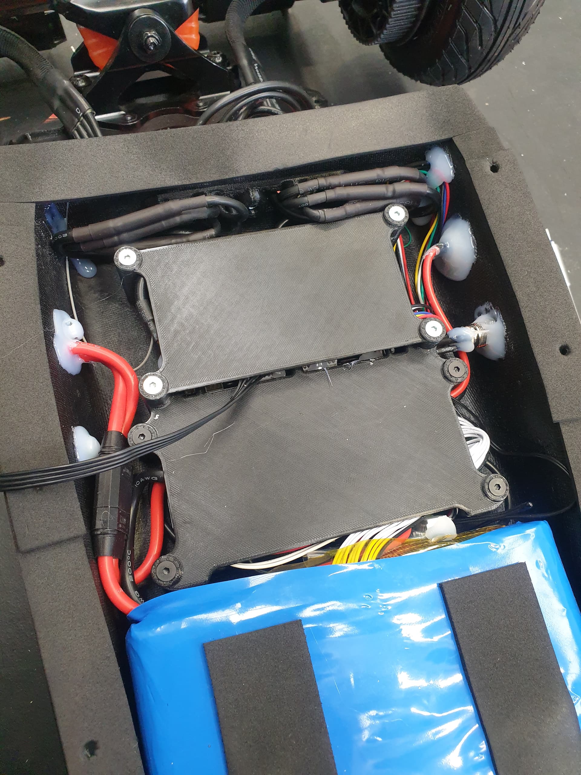

I ve got room to do something with it properly. Definitely keen to see what you come up with. It probably doesn’t help the BMS sits on top too. Did I see once you guys have something neat you print to cover the LLT’s ?
That’s what the hellcats look like inside.
Bluetooth and puck receiver sit on top of the esc, power connections sit on top of the bms
