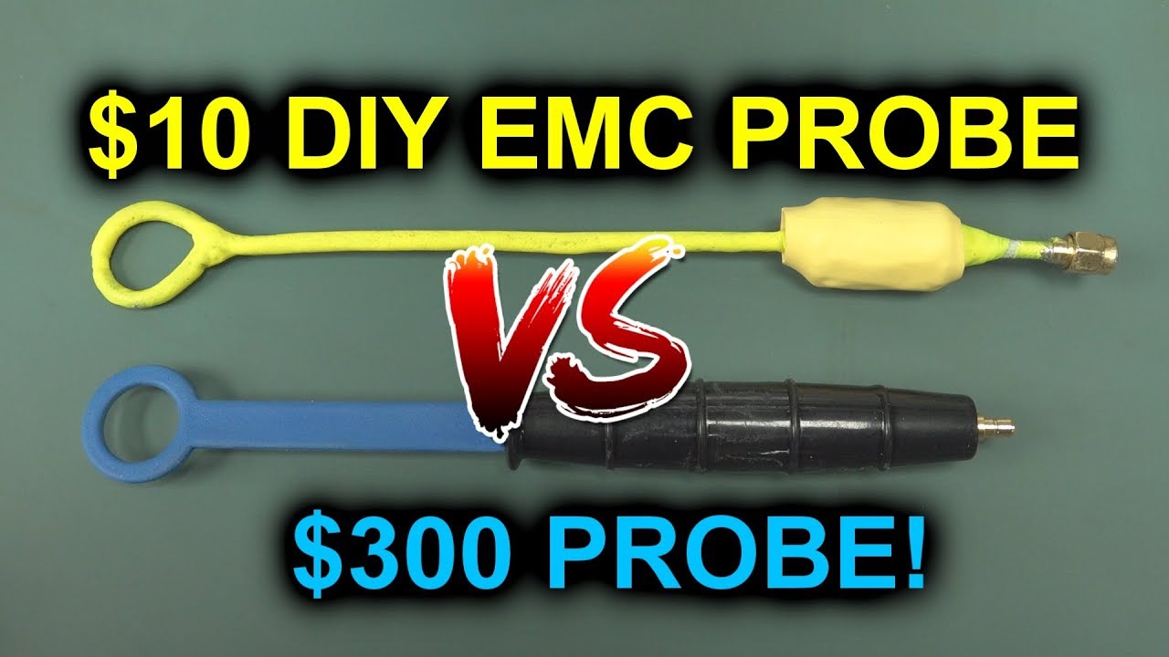

A loop antenna and a portable oscilloscope should be able to pick up near-field effects (more on the magnetic than electro- side of things. IIRC Dave from EEVBlog did a video less than a year ago showing how loop antennas/probes can be used to sleuth near-field EM on circuit boards, and the concept is the same. Even showed how to make your own loop antenna for cheap from a piece of coax.
Great lead! This look like the video you saw?
