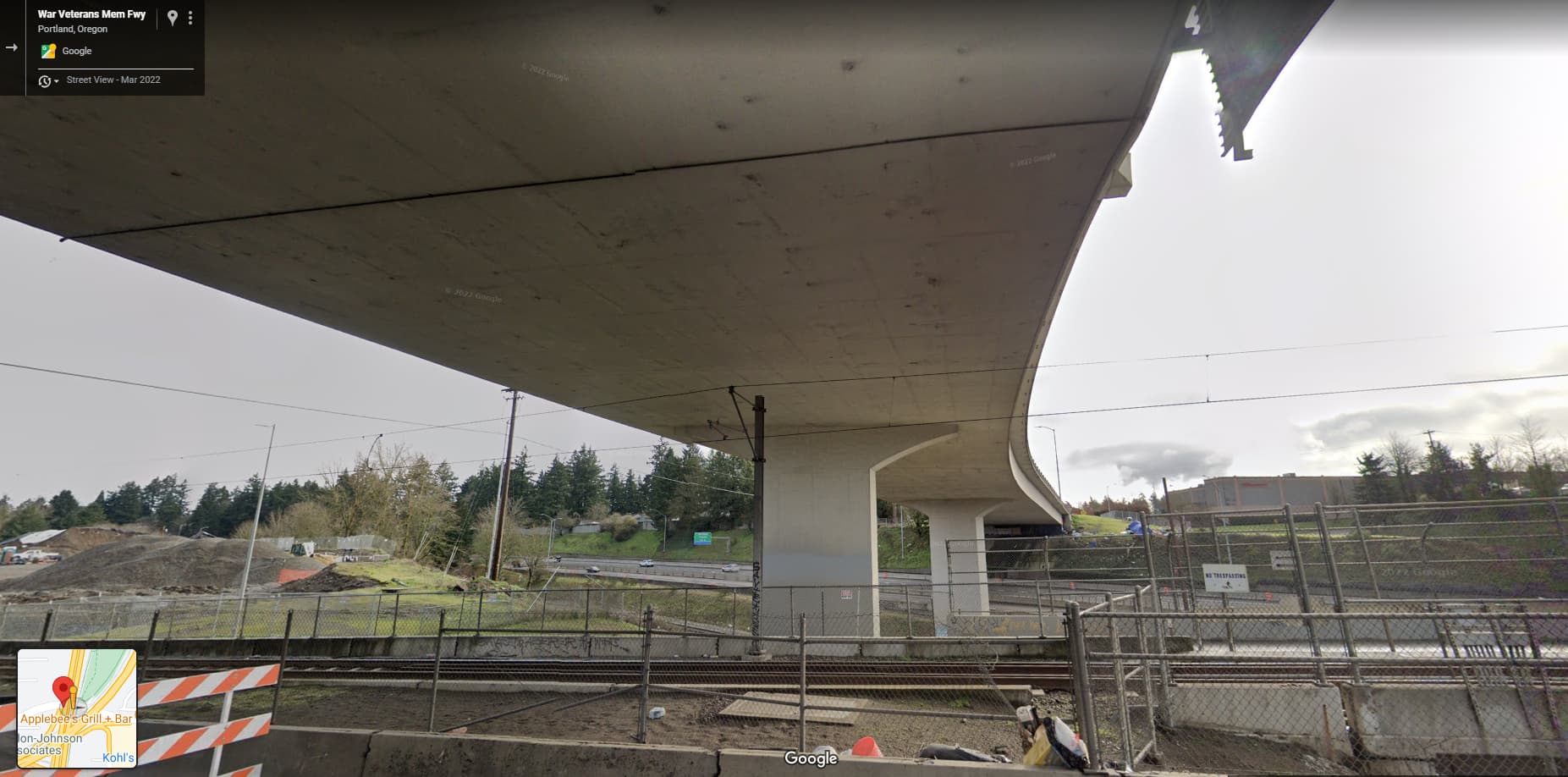

I still don’t understand the bridge incident… could it be from these wires under the bridge?
They’re the only thing I could find from google maps that could be related.
Yep, that’s the one!
It’s possible, that looks like a train line which usually run at 25kV (that’s kilovolts, not motor speed) AC, so if something’s super sensitive it could pick up eddies from it. Kind of odd though considering all the concrete in the way, and it’d be extremely weak to begin with.

Aren’t their crawl spaces in the bridges their not solid I think

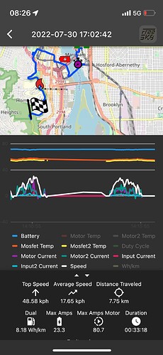

Was anyone running logs at this point? Any logs y’all want to share?
All the logs that have been posted via robogotchi don’t seem to indicate anything.
Except that it complely fucked up my distances both times

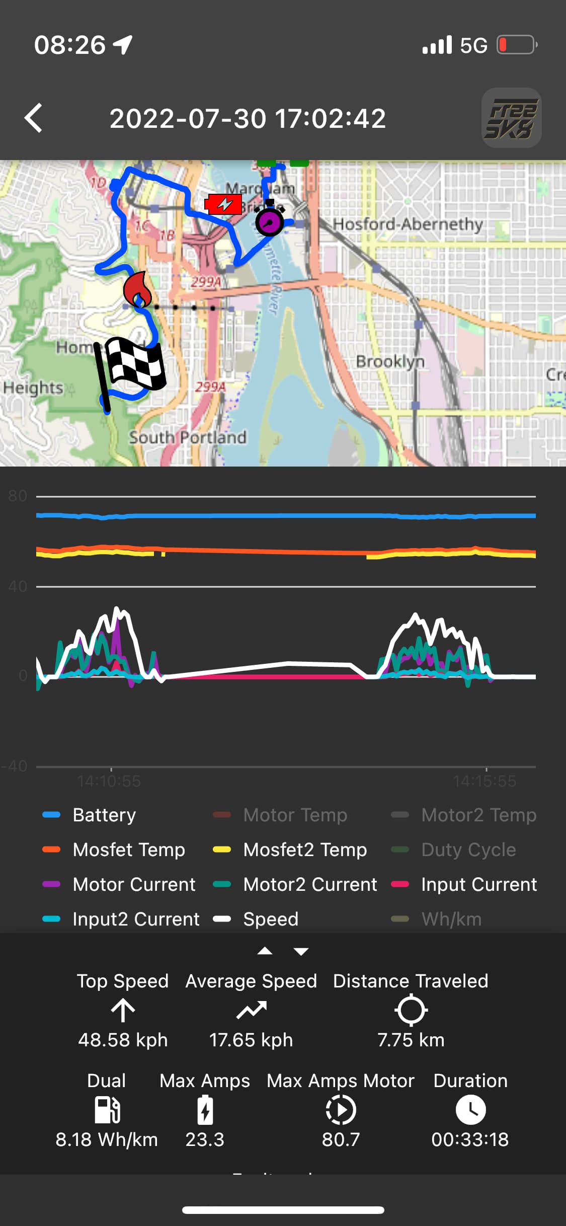

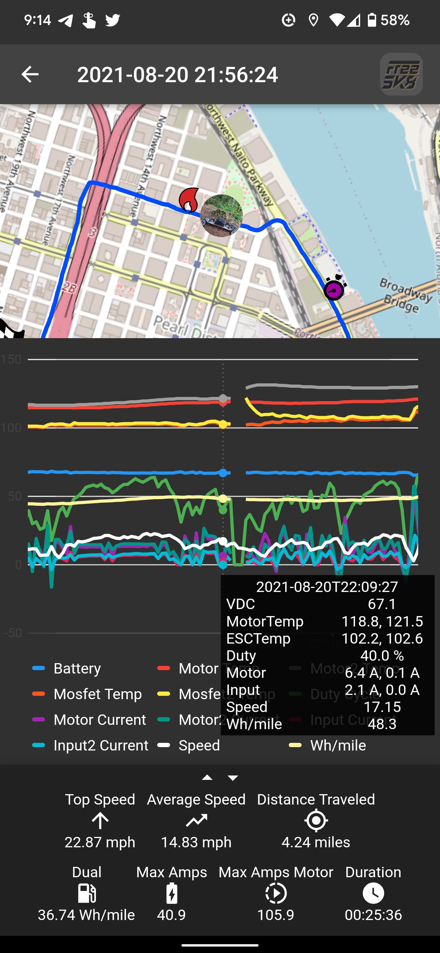

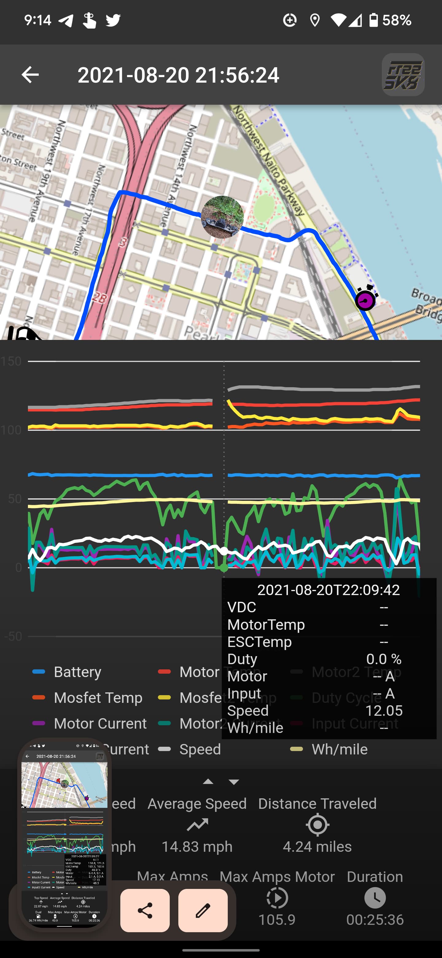

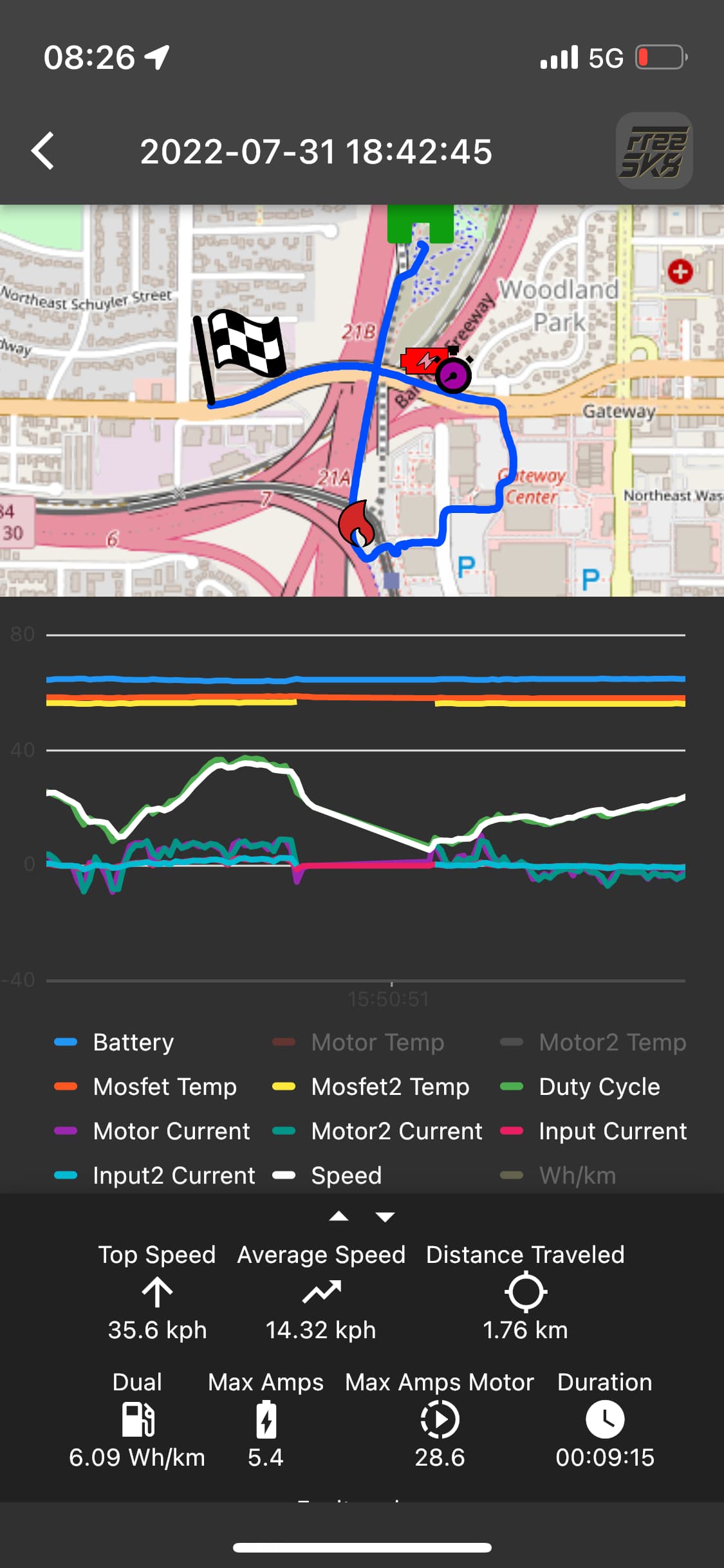

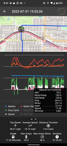

Hers my log on that ride, and a couple of screen shots to compare, notice over the overpass my shit goes dead except mph
60% duty
Dead like a… Ghost :ghost:

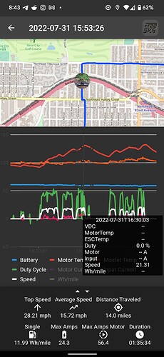

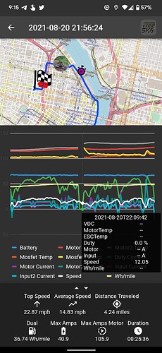

I found the incident from Carve PDX 2021, same board, same thing as the bridge incident, same data in the robogotchi
https://drive.google.com/file/d/10kyF-pTJo6UfeB1EsEbKBZ041wI2DF6_/view?usp=drivesdk
