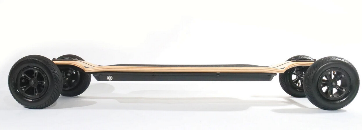

Some may know the Youtuber or Esk8 reviewer “average eskate reviews”
One of them seems to have found a liking in building DIY boards and turned it into a brand as viewers asked if he could build them one.
Seems like it’s…Off the shelf parts although it uses the Ubox it seems instead of Hobbywing like most others.
Price is very…rough. Fit and finish definitely needs some work.
Cost (Converted 1:1):
AT normal charger 1399£ / 1630€ / 1947$
AT fast charger :1550£ /1805€ / 2157$
Street normal charger: 1299£ / 1513€ / 1808$
Street fast charger: 1299£ / 1689€ / 2018$
Speed:
● High acceleration 0-32 MPH / 50kph
● Medium acceleration 0-32 MPH / 50kph
● Low acceleration 0-32 MPH / 50kph
● Hill Climbing: 40%
*Tested with a 77kg rider on real city streets and country side roads in the HIGHEST SPEED MODE.
MPH
● AT Wheels 175mm (7inch) 16-20 miles with real world riding (Tested with a 77kg rider using the Highest Speed more)
Wheels
Pneumatic AT (all terrain) Wheels & Swappable Street (Cloud) Wheels:
● 175mm/7inch, 150mm/6inch pneumatic AT wheel with 66T Gear. Ideal for enhanced shock absorption for a smoother ride, superior grip on roads, extremely comfortable on long distance rides and handles rough streets, pot holes and more better than any other wheel.
● Quickly switch from AT (all terrain) wheels to 120mm cloud wheels with 40T Gear
Charge time:
● Standard charger 2-4 hours
● FAST charger 1 hours
Battery
Powerful 12AH
● Battery Capacity:12AH
● Battery cells: Samsung 30Q
● Range: 18 miles (29km) on 7inch/175mm AT wheels. 32 miles (52km) on 120mm Cloud
*Tested with a 77kg rider on real city streets and country side roads in the HIGHEST SPEED MODE. Individual range my be different depending on location, terrain, rider size and weather.

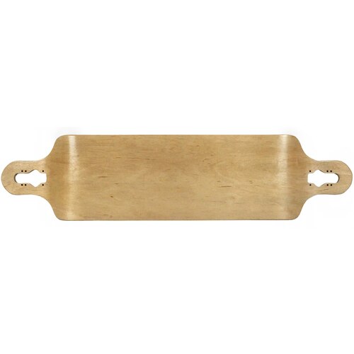

Deck:
● 40.75 inches long x 9.75inches wide
● Drop down and drop through Canadian maple deck with W concave
● Max load 147kg/325lbs
● 9 ply

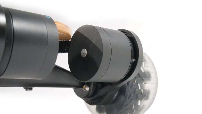

Motors:
● x2 2450W rated power high-quality and high-precision motor
● Battled hardened
● 63mm 54mm. 10mm D shaft
● 15T Pully
● 140 KV
● Excellent, reliable and powerful
