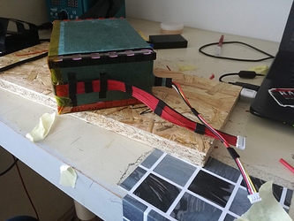

For the battery i was indecisive between 12S5P and 10S6P. I opted for the latter because of the 4.12 ESC not being reliable with higher voltages. Since this is a eMTB build, space was not limiting factor (at least not in my case) i decided to use 18650 holders instead of just gluing the cells together. I spot welded one 7x0.2mm nickel strips for parallel connections and doubled them for series. So the current of one cell goes trough 7x0.4mm strip which is 2.8mm^2 for 15A on less than 18mm of lenght. The battery is 650Wh and theoretically should get me 30km of range.
BMS is generic AliExpress with 10A charge and 60A discharge. I soldered connectors to the pack so i could replace the BMS in the future if needed. Charge port is fused with 10A fuse while charger is 5A.
I placed NTC thermistors on the 3 of the battery cells to monitor battery temperature (4 pin connector on the pictures). For the charging i DC barrel jack is used which seems to be at its limit at 5A charging current.

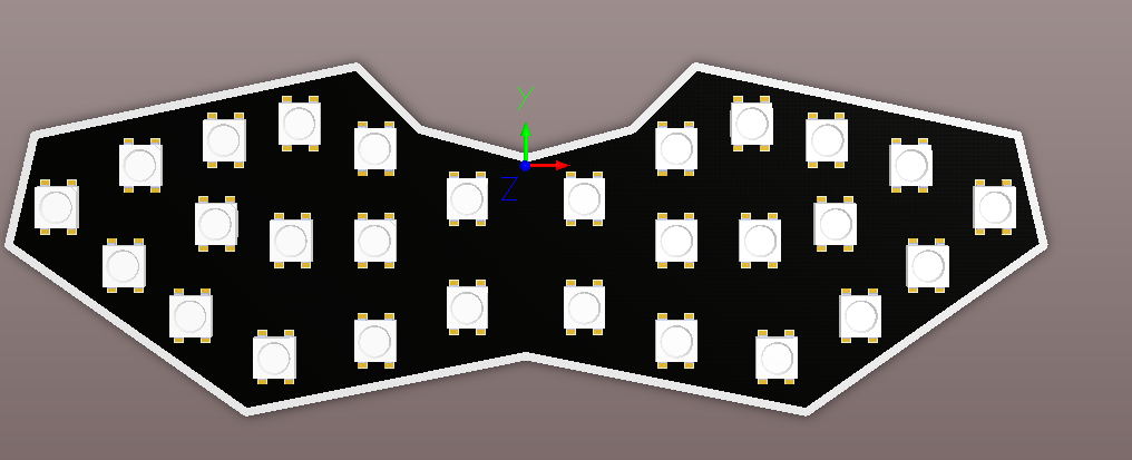

For VESC enclosures i didn’t want just a box so i tried a few shapes and settled for this one. As any other project it wouldn’t be good if there was no LEDs so i laser cut acrylic glass and placed WS2811 on the inside. The second iteration of enclosure will have waterproof glands instead of just holes for battery and motor wires and with white acrylic glass in place of transparent one. The enclosure is fitted on the deck with truck bolts.

Front and backlight will be controlled with MCU, which is connected to hte UART of VESC, and 2nd channel of receiver. MCU will also monitor and display battery temperature from NTC thermistors. A switch to turn on/off lights, change VESC mode (250W,1000W, 2kW…) and some other misc functions.
Backlight: custom PCB with WS2811 leds, need to print enclosure and wire it up
