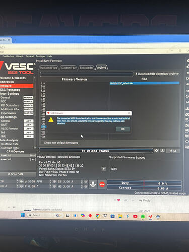

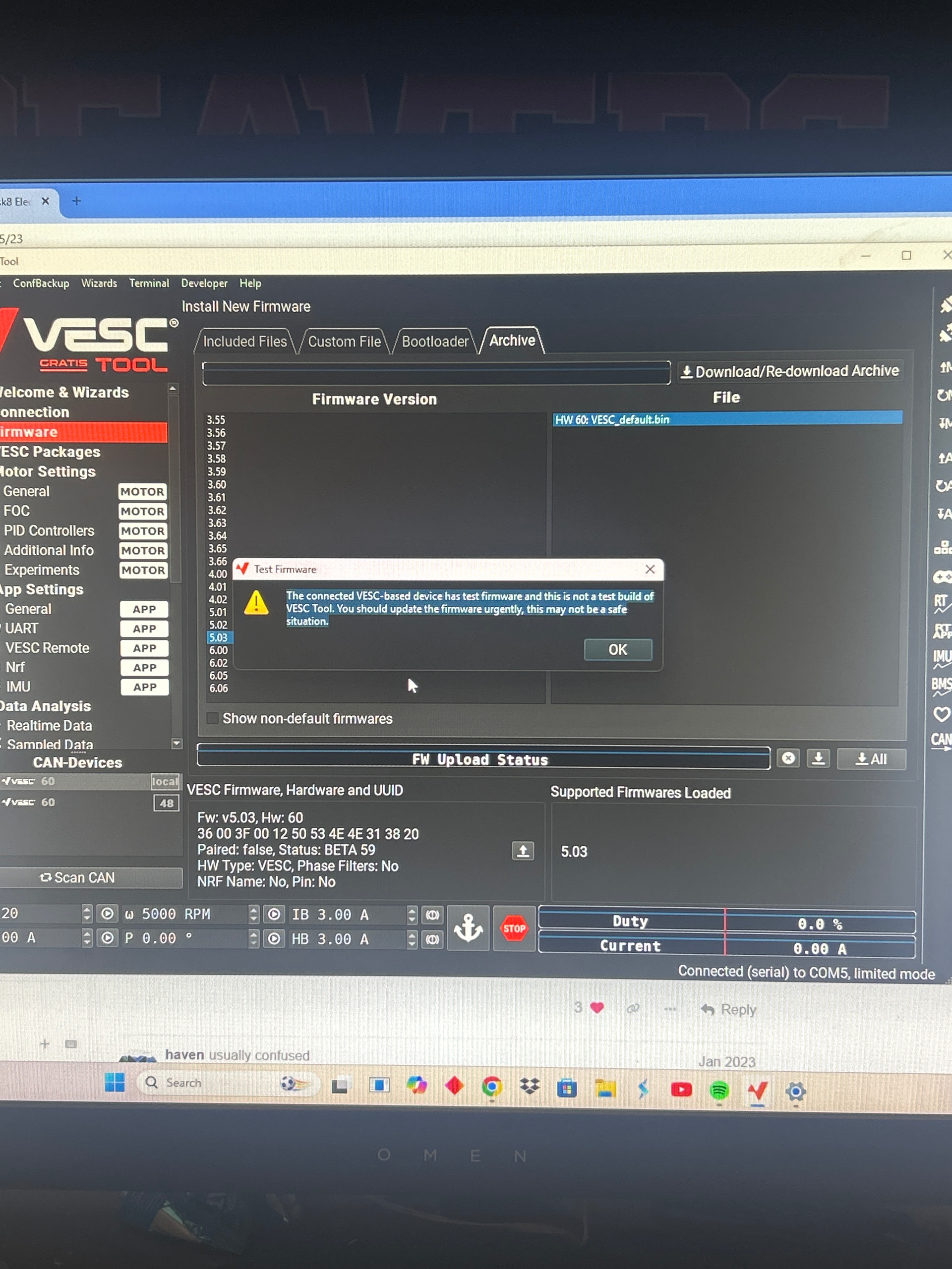

Is this no bueno?
Is this on the DV6? Have you tried updating the firmware?
I would recommend finding a tutorial specifically for the DV6 and updating the firmware first.
I updated it and the message went away.

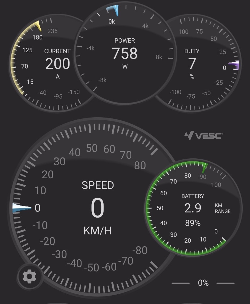

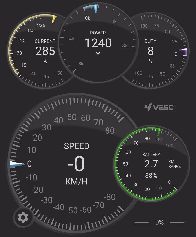

I would be curious to see what power reads as for other people when stationary and high torque. (63100s 170kv 16S in below pics)
200A (100A per side) I think is a good level to see.
I didn’t manage to stop wheels slowly spinning at this current even while standing on the back truck, so take the below wattage with a grain of salt

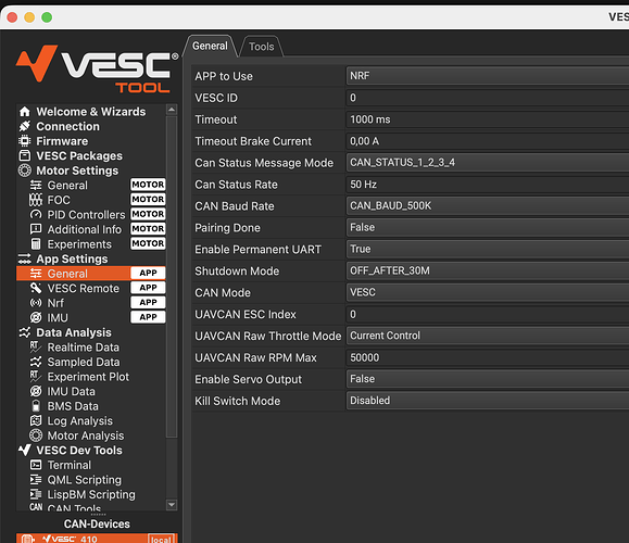

So I’m trying to get this GB dual trigger remote to display telemetry. The instructions I got from @georgebenett say to …
“Fix for the customer: in VESC Tool → App Settings → General → CAN status message rate/mode, make sure the CAN status is enabled like this: CAN_STATUS_1_2_3_4 at 50Hz”
He included the screenshot shown below.

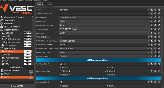

Problem is, VESC Tool 6.06 doesn’t seem to have this option. Instead, there is a “Can Messages Rate 1” and another for rate 2. I set them both to 50hz. All of the status boxes, 1-6, are checked in both sections. Is the “Can Status Message Mode” tab hidden elsewhere? Any advice is greatly appreciated because I really want to get this thing out for a test run.
Tick the boxes 1,2,3,4 at the can messages rate 1 , don’t tick anything at can messages rate 2
Just tried, it didn’t change anything.
