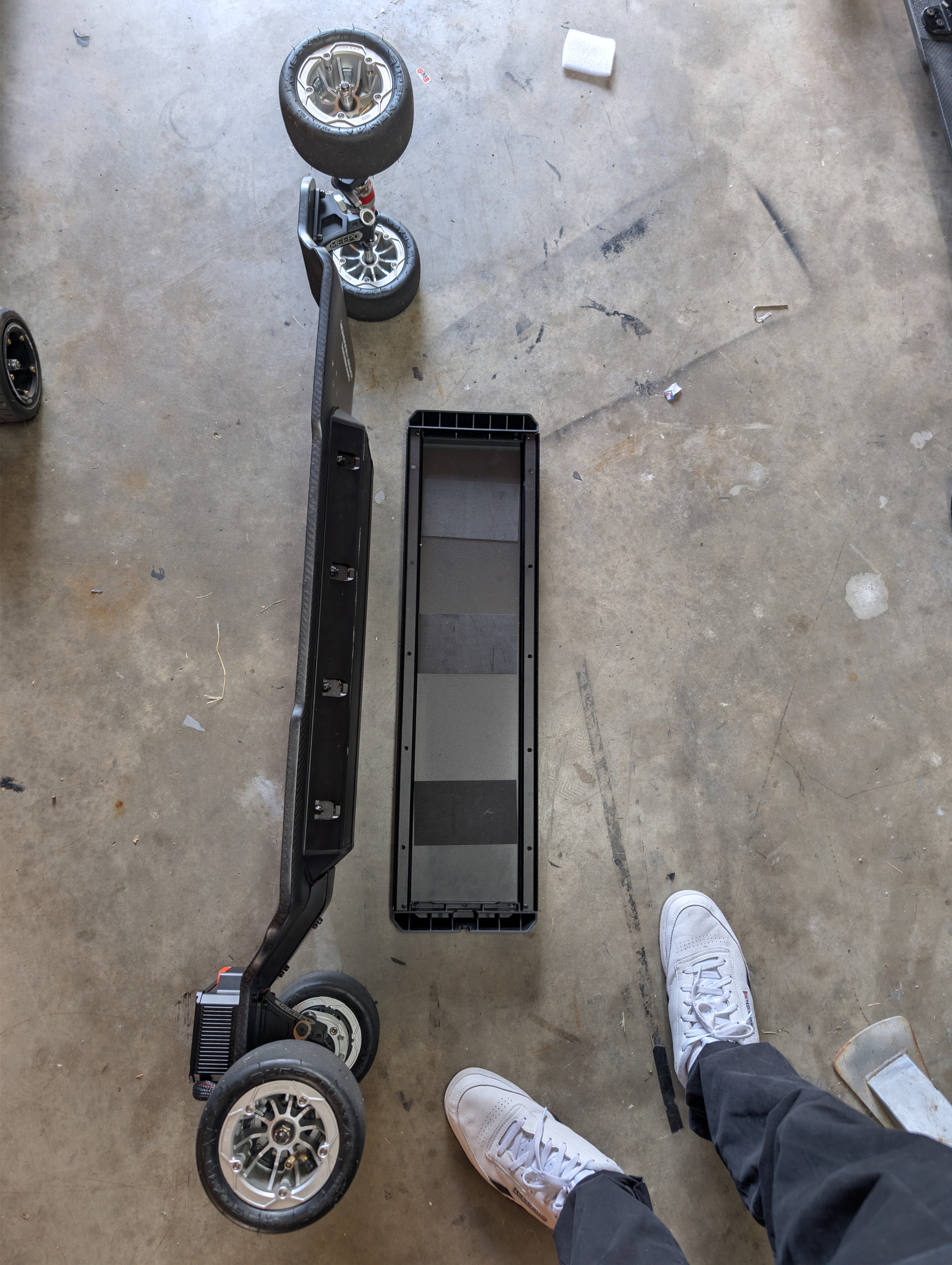

Got the larger 3p enclosure for this thing.. using some of these new tabless cells would a 20s2p be enough to run 130kv 85’s at their limit? It’s just going to be a spare practice board so im not fussed with range. Keeping it light and perhaps squeezing the d100 in the enclosure would be a win.
