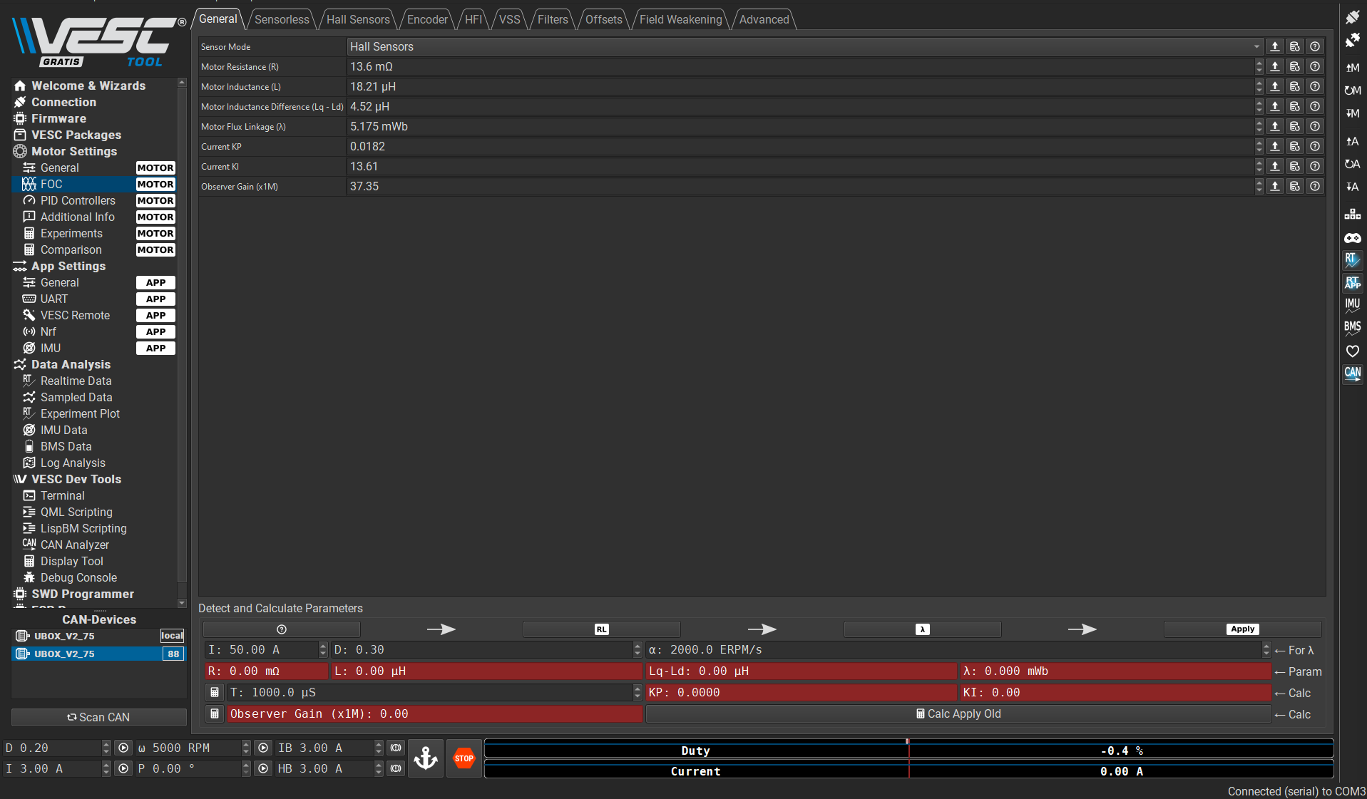

Finally found some time and then I found out of 6 usb c cables none were a data cable, but finally I’m able to connect again.
@b264 you were on to something.

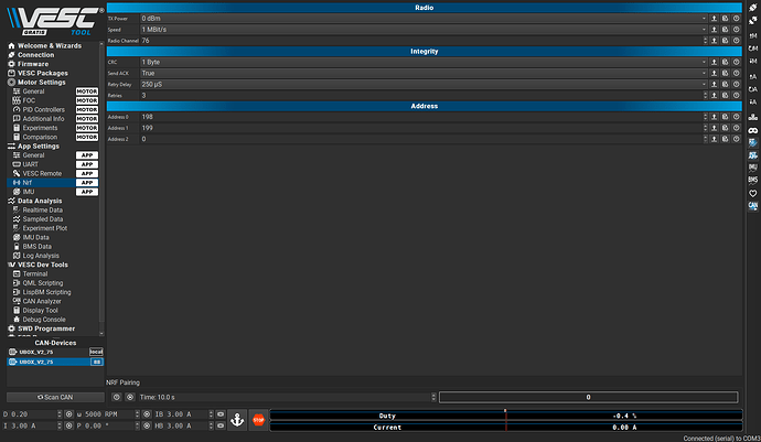

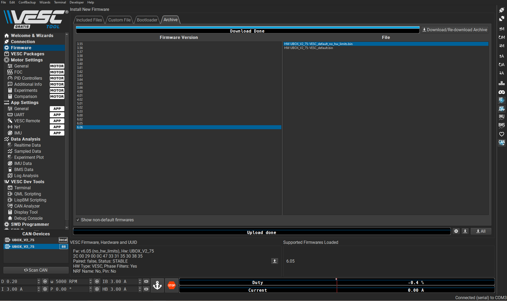

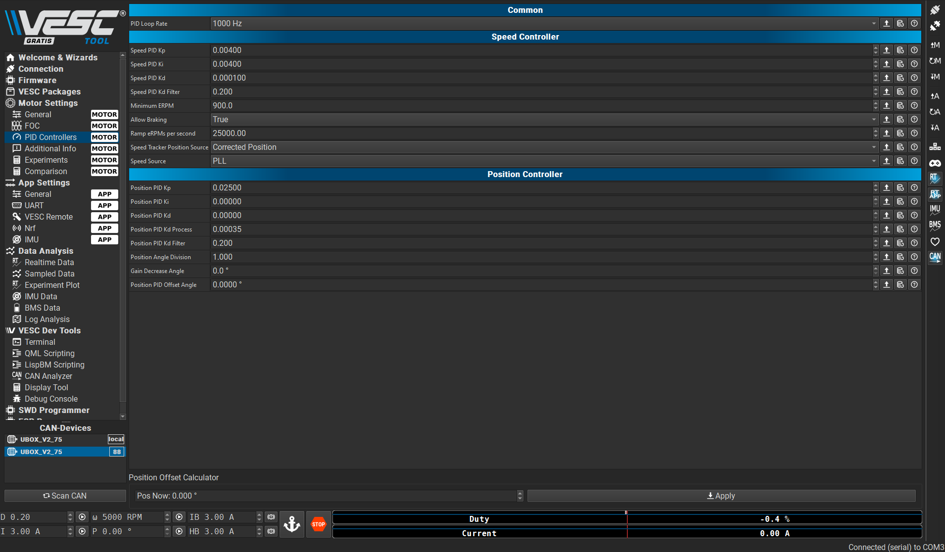

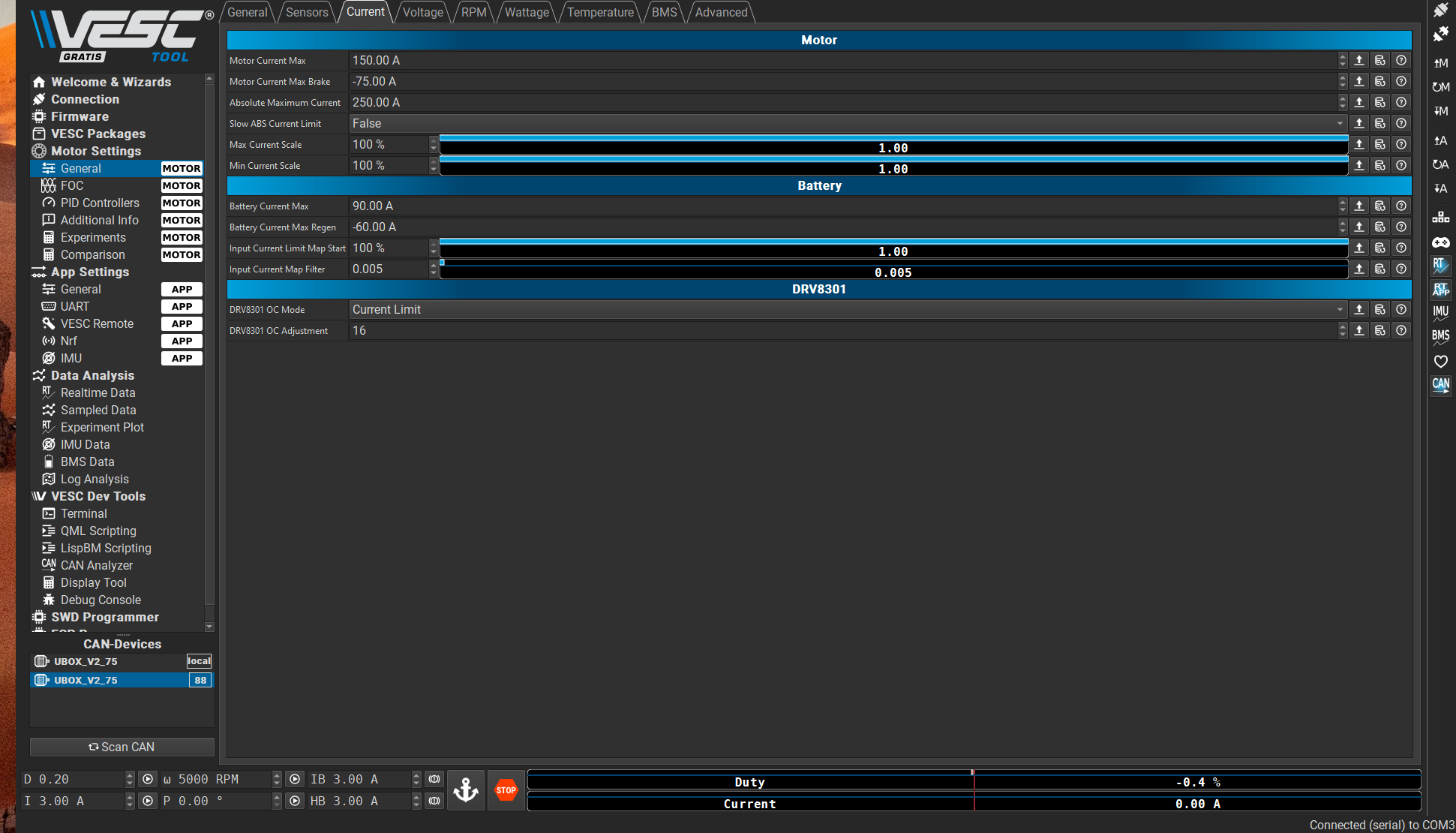

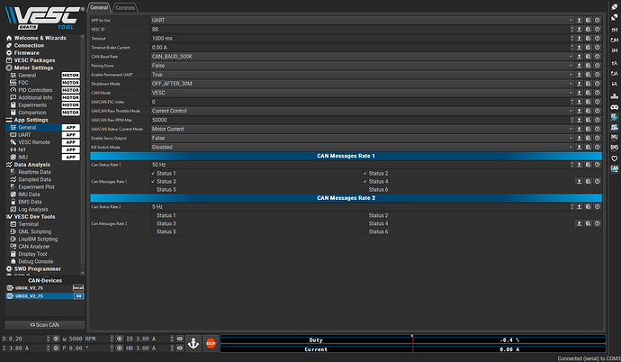

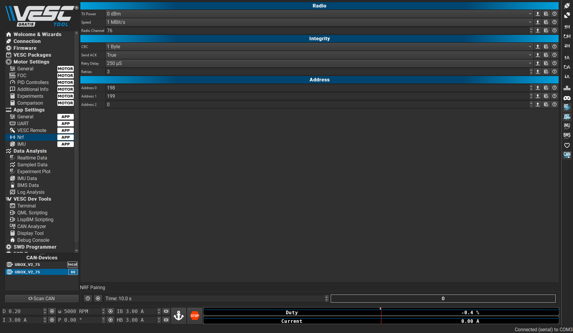

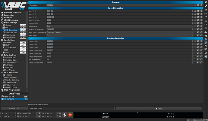

Settings screenshots
Wow, either that remote is set up wrong, or it belongs in a trash can. That’s ridiculous. Does it have PWM output instead of UART? Can you try that? Unlikely to be a solution. Is there a ramping or damping or other setting in the remote that can be disabled?
Try setting positive ramp time to 0.1 and see if that makes a difference.
