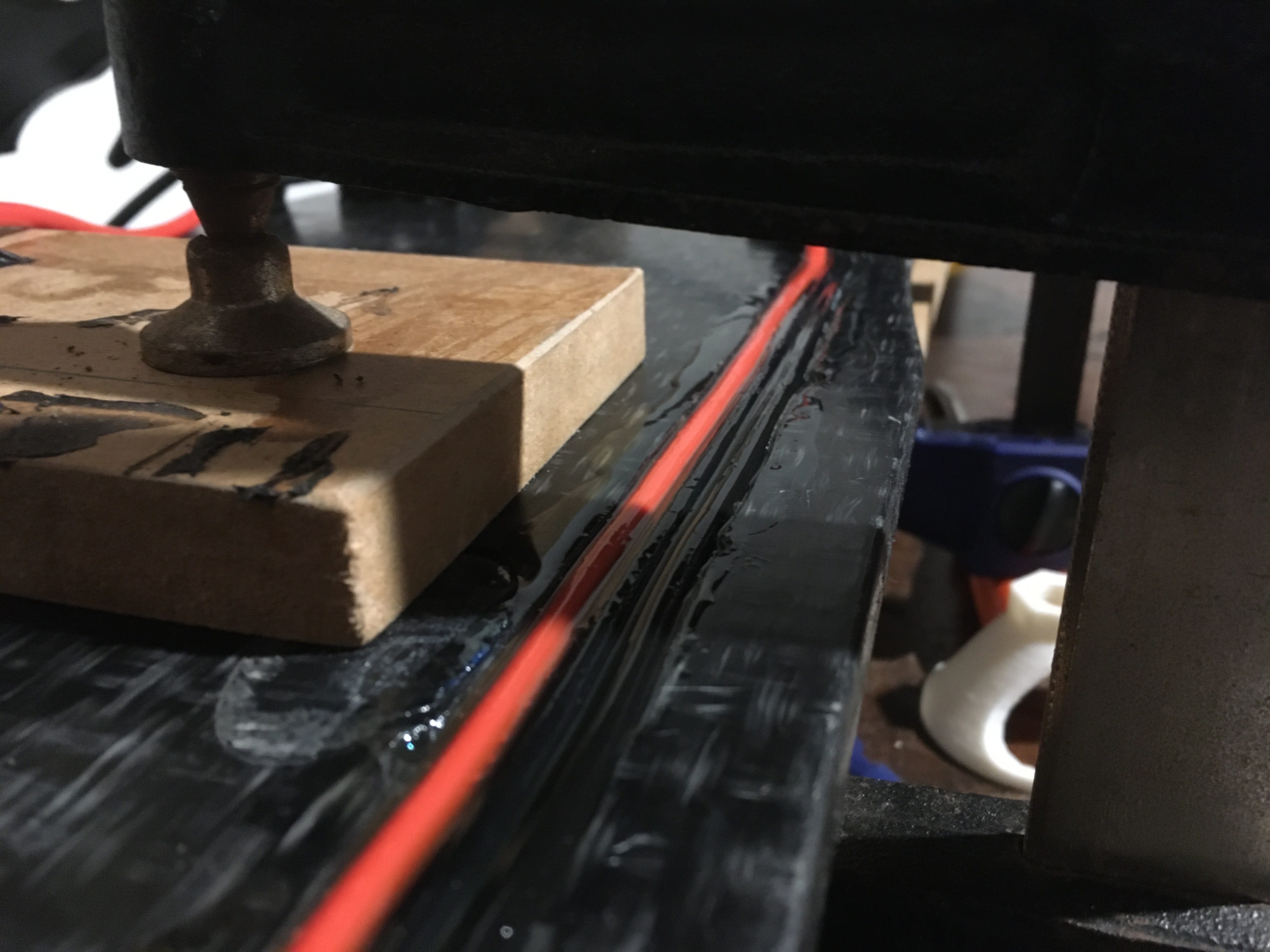

Wire channel routed, started with a Dremel, moved on to a column router and finished free hand on the Dremel due to clearance near the read, the plan is to pour clear epoxy, and if it turns out nicely I may leave a window on the grip tape to show the wiring
Instead of doing a epoxy pour, just superglued the wires to it and will do a few layers of varnish, looks great and way less messy
