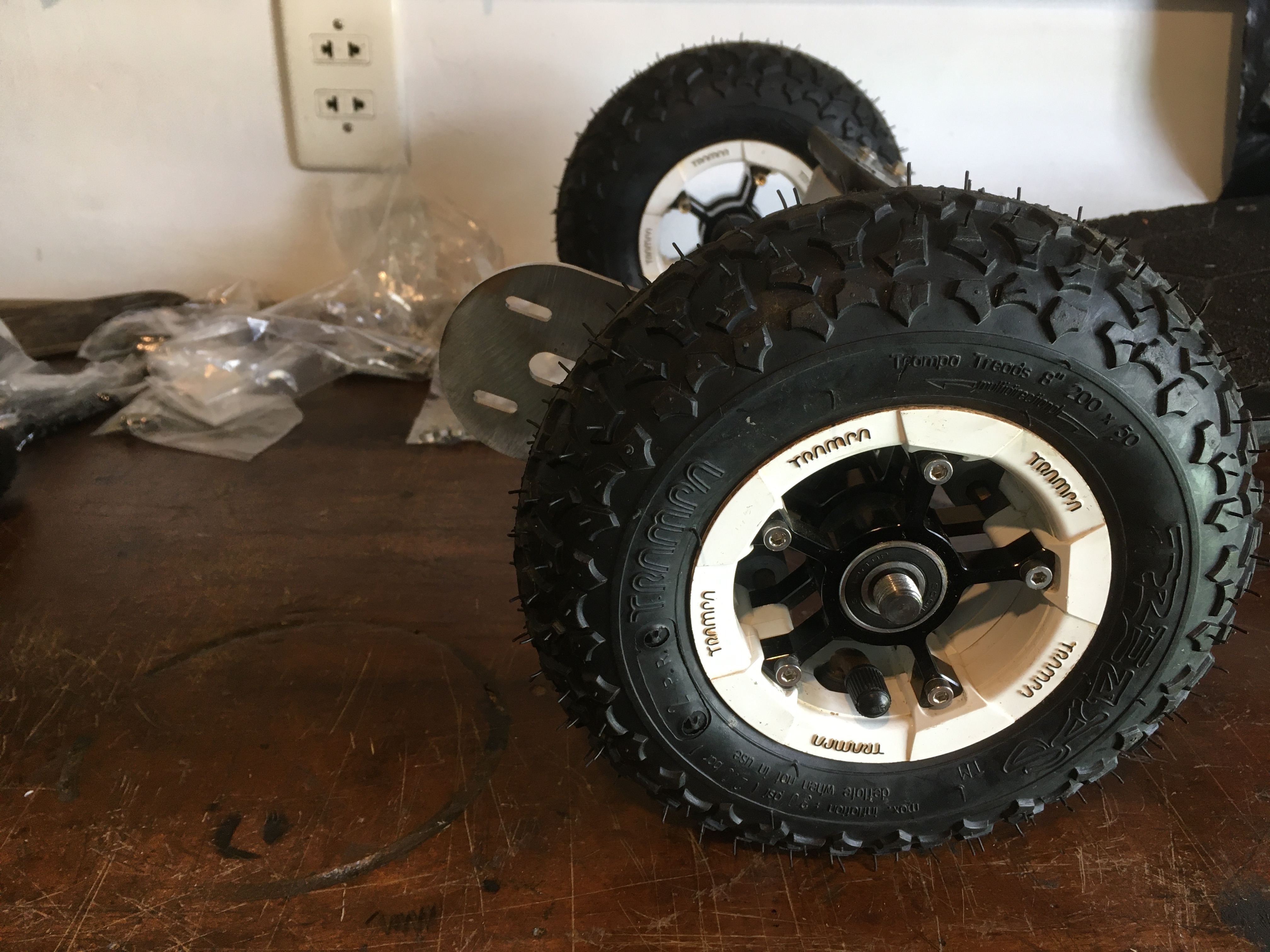

Apart from some wiring I think this is all needed to assemble it :grinning:
It’s on the way heavy side, but considering that in the end it costs around $100, there is no better way, this includes both enclosures, motor mounts, wheel pulleys and all hardware

Do you have a CAD model of the 8" tyres?
Silicone everywhere, given the tolerances of the 3D printed part I wouldn’t trust a gasket, if it was all machined pieces then a o-ring would be perfect for easy access
Just a really simple one, with jus the overall shape if you want
yeah that would great :slight_smile: thanks

And the motor mounts design works, locks really well in place and the alignment is perfect, you tighten the set screw and everything gets square and locks into place
Also It’s definitely possible to make them lighter and more compact
If there is enough interest I think in start selling them, but beat them up first
I asked because of the tread pattern but it’s not a big deal
Oh, the one with the thread is from Lacroix so I can’t share
But I will see if I can manage to do equal the one I have on the board
