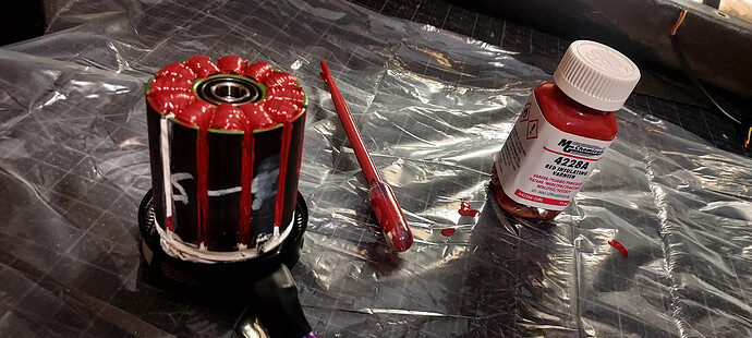

Fuckkkkkk yeah boy, check that motor clearance out! The gap goes on for miles and miles
Picomiles®
Screenshot_20240923_211054_Chrome
We should try to make that an SI unit, for sure
Those squeezy pipettes are definitely the way to go for varnishing stators. Super clean :ok_hand:
