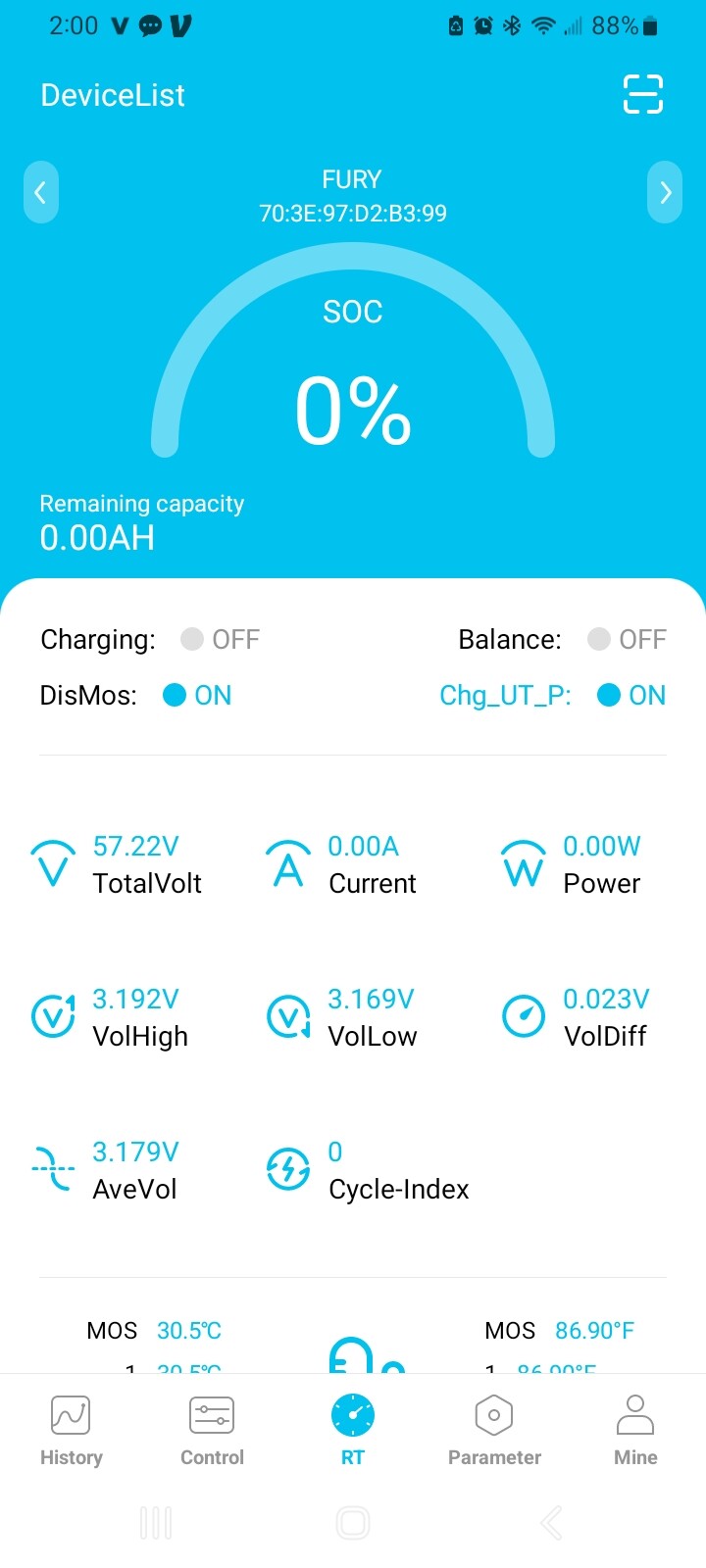

BMS: NOT COOPERATING
This JBD BMS isn’t letting me set the charge switch to ON. Or any other setting for that matter. If I try to change any other parameters, it actually does start charging successfully for a couple seconds, but then shuts it off again. Anyone know what gives?
EDIT: nevermind, got it sorted. Apparently i had to “submit an application” in My Profile > Device Management > Authorize, and wait for it to go through
Bad app, recent update fucked everything up. Try doing the same using overkill solar if you’re on android.

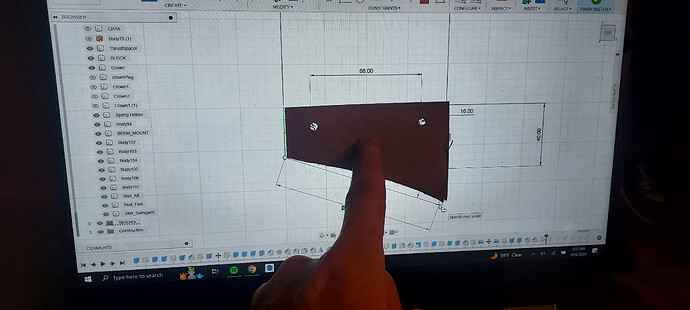

Footpad: TRIMMED FOR CLEARANCE FOR THE FIFTH TIME
Rear toe clip: NOT FITTING
20241005_231548_1
I’ll print a footstop, since I at least need to keep my leg from sliding back into the drive assembly
Design: CARDBOARD AIDED
Foot: STOPPED
