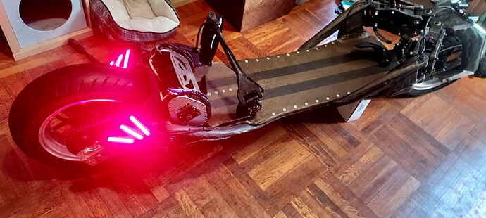

Why am I building a new bikeboard?
(the reasons)
Orbital has a lot going for it, but you know what else it’s got? Teething problems. (gimme a break, there’s no design handbook for these things) Here’s the big ones and how to fix them:
  • Insufficient lean angle while cornering → raised deck, wider wheels
  • Insufficient steering input before ankle tipover → lower deck, wider wheels, positive steering control
  • Hella turn radius → positive steering control

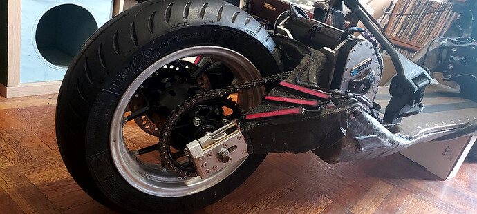

  • Chain derailment (got worse over time and it’s a big yikes :grimacing:)–> high rigidity rear triangle, direct load path for chain tension, thicc chain
What do all these have in common? They require hacking apart significant sections of the chassis and fabricating new parts to graft on in their place. At that point, might as well build a new chassis. But wait! All the drive components are tightly integrated into the existing chassis, so reusing them would greatly limit the design freedom for the new version.
Rationalization complete! Time for a new board! Let me just crack open the old bank account and -

Aside from bug fixes, how will Fury differ from Orbital?
(the reasons)
The design of Orbital was intentionally conservative, mechanically speaking. I was trying out several new techniques for the first time (like forged carbon and 3D fixturing), so I kept the design down to the bare essentials.
This time around, the kid gloves are off.
Fury will use an integrated chassis, with the deck lid completing the torsion box:
FuryExplodedChassis_1
The deck lid will carry a carbon fiber torsion bar steering mechanism, as a ripstick homage, to improve responsiveness:
FuryExplodedDeck_1
Articulation points for the steering mechanism and suspension linkages will be forged from carbon and fused into the panel structure:
FuryExplodedSteering_1
Four motors will feed power to a single moto chain sprocket through a laser cut/3DP gearbox, because we need to push the frontiers of Esk8 audio pr0n:
FuryExplodedDrive_2
And because speed is a bikeboard’s natural habitat, this machine will be able to merge onto the goddamn highway.

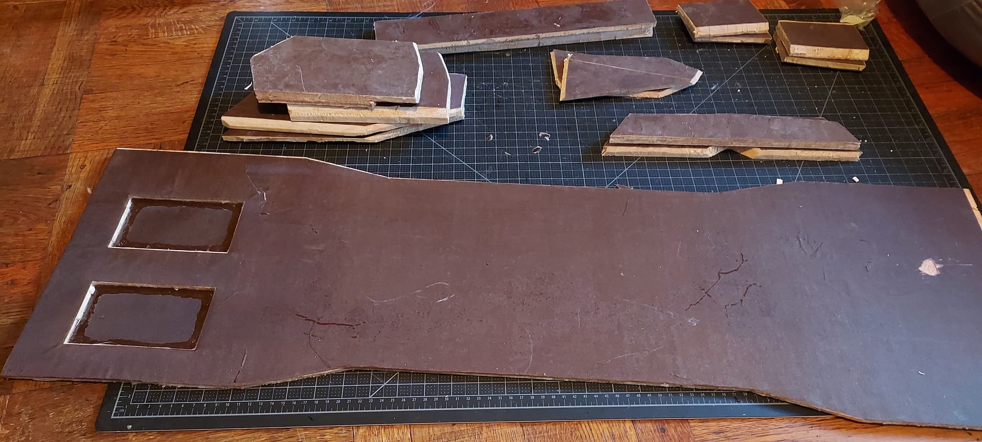

PART ONE: I Vacuum Bagged The Whole Damn Thing 'Cuz I’m Chassis That Way
Carbon forgings are coming along slowly and steadily.
Here’s one fresh out of the mold, still with its dusting of 13 original herbs and spices:
And after much cleanup and grinding:
These flat panels are made by drawing patterns onto craft paper and vacuum bagging them onto end grain balsa, to make a lightweight sandwich that’s carvable with a knife:
All the panels are glued up with thickened epoxy to make the center frame of the chassis, and the outside edges are rounded over:
The inside edges are filleted with a epoxy/silica/sawdust mix:
The forgings are glued on and over-wrapped with carbon:
The tricky spots are wrapped with flax fabric manually:
The whole thing gets bagged up (and i make my room extremely messy):
The end result is approved by my supurrrvisor:
That’s where the project has stood for the past month or so. My work schedule should start easing up a bit, hopefully.
The chassis core needs a couple bits trimmed off, a couple cosmetic details added on, but it’s pretty much there. Next up is the deck plate and battery.
