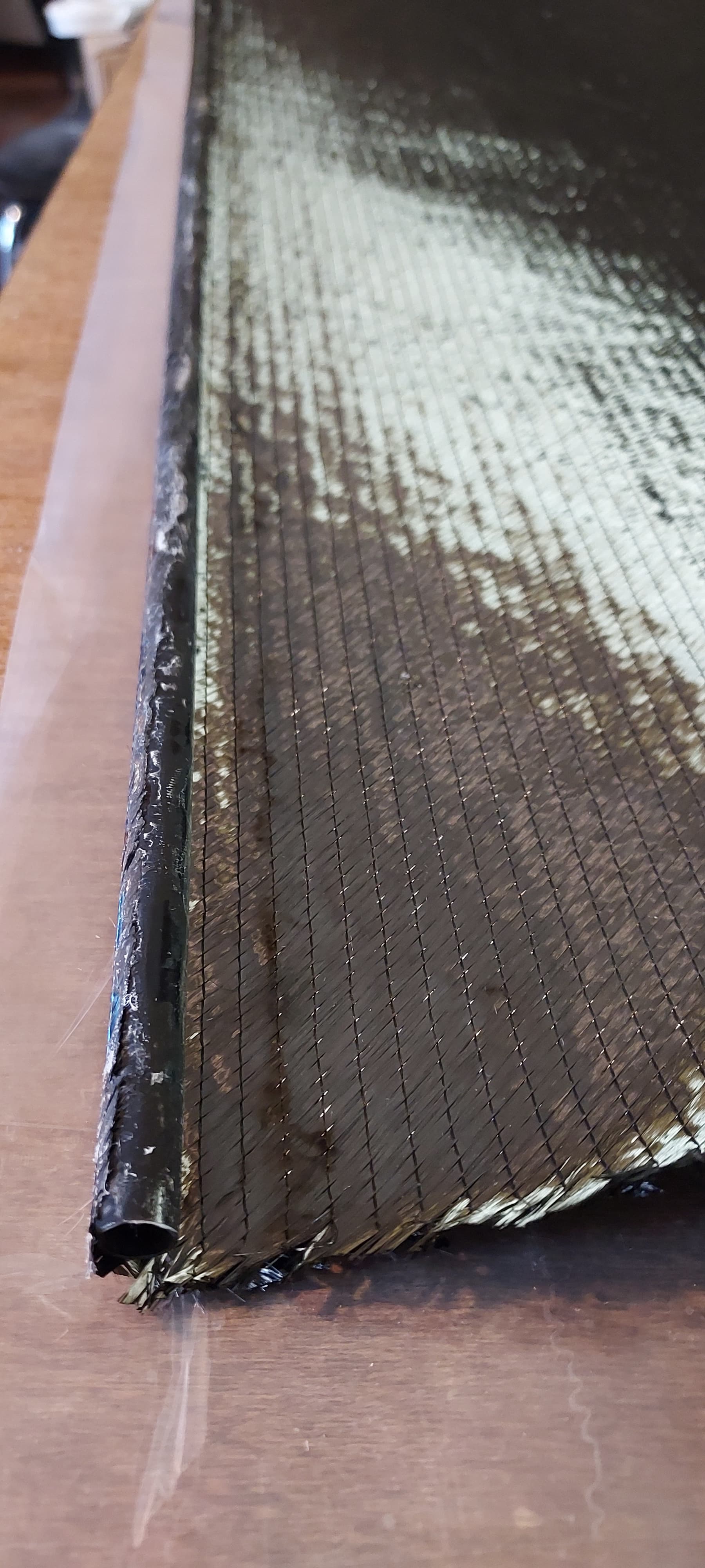

The torsion shaft that the footpad rides on starts off as a 9mm FG tube, glued to the edge of a +/- 45deg carbon fiber sheet.
I almost ended up scrapping the part, since rolling it up by pushing from the top kept introducing voids between the layers. I eventually glued dowels into each end of the mandrel so I could torque it backwards from the inside as i rolled, which kept it in tension. Each end got a little messed up, but most of it got to the target dimension of 20mm without going over.
