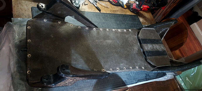

Work has been busy for the last couple weeks, and it probably won’t clear up till end of month. But i did some maintenance on my commuter board and broke the torsion shaft for this build out of the peel ply.
Since the ends of the layup got kind of bunched up, there was two or three millimeters of extra diameter to take down from them on top of the fact that the whole thing needed to be smoothed out a little. So I duct taped it to a hole saw and headed for the shower. Drywall sanding screens worked amazing for this, the removal rate was surprisingly good and i only went through one sheet.
Rate my setup.
She rotary grind on my torsion shaft until I shed abrasive microparticles
6/10
11/10 :ok_hand:
Hallo, folks. I was out of town for work a lot last month and was feeling pretty burnt out for a while, but I’m starting to get back in the saddle. The past couple weeks I’ve been grinding (often literally) through the fitment issues I’ve been putting off.
I put a zillion holes and threaded inserts into the deck plate, since bolting that sucker on tight is how the frame will get its torsional stiffness. Still waiting on a hardware order to get screws of the right length. I also JB welded inserts into the torsion shaft to attach the footplate.
The torsion shaft came out slightly bowed, so I warmed it up until I was able to straighten it out, and it’s free spinning in its channel now. The plywood plate underneath the footplate also needed some gouging out since the height/thickness came out a few mm off of plan. It still needs bushings under the standing area, and front/rear thrust bearings to keep it in place under acceleration.
All the carbon forgings to this point didn’t have quite correct tolerances for the bearings and shafts, so I got 10mm precision ground steel bars to form exact fits for the 10mm shoulder bolts. Just a coat of wax, prep the inside of the bores, and a bit of epoxy. You can also see the deckplate getting its carbon pinstripes back there.
22mm precision steel bars are pricier, so I grabbed a length of 3/4" steel bar from the trash at work and printed a couple more mm of diameter for it. Sanded, then wrapped in packing tape, then waxed before used as another positive mold.

At last, no slop! There’s a bunch more parts to forge for the steering mechanism, and before I start assembling the front fork and rear triangle, I need some laser cut metal parts to act as hardpoints for mounting the axles.
So all these parts will be real soon! Before this decade is out. Not because they are easy, but because I’m too dumb to know how much work and money a project will take before I sunk-cost-fallacy my way through it.

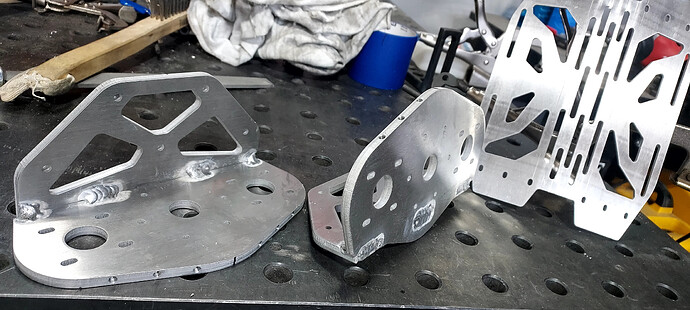

Laser parts have arrived!
That’s some really weird looking carbon fiber
That’s a good point. Do you think it’s expired, should I send it back?
I’m a professional welder, in the sense that sometimes I weld at work, and in no other sense. I’m not showing you the welds i contaminated on the other side lol

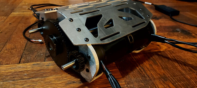

Dry fit for the gearbox looks good
