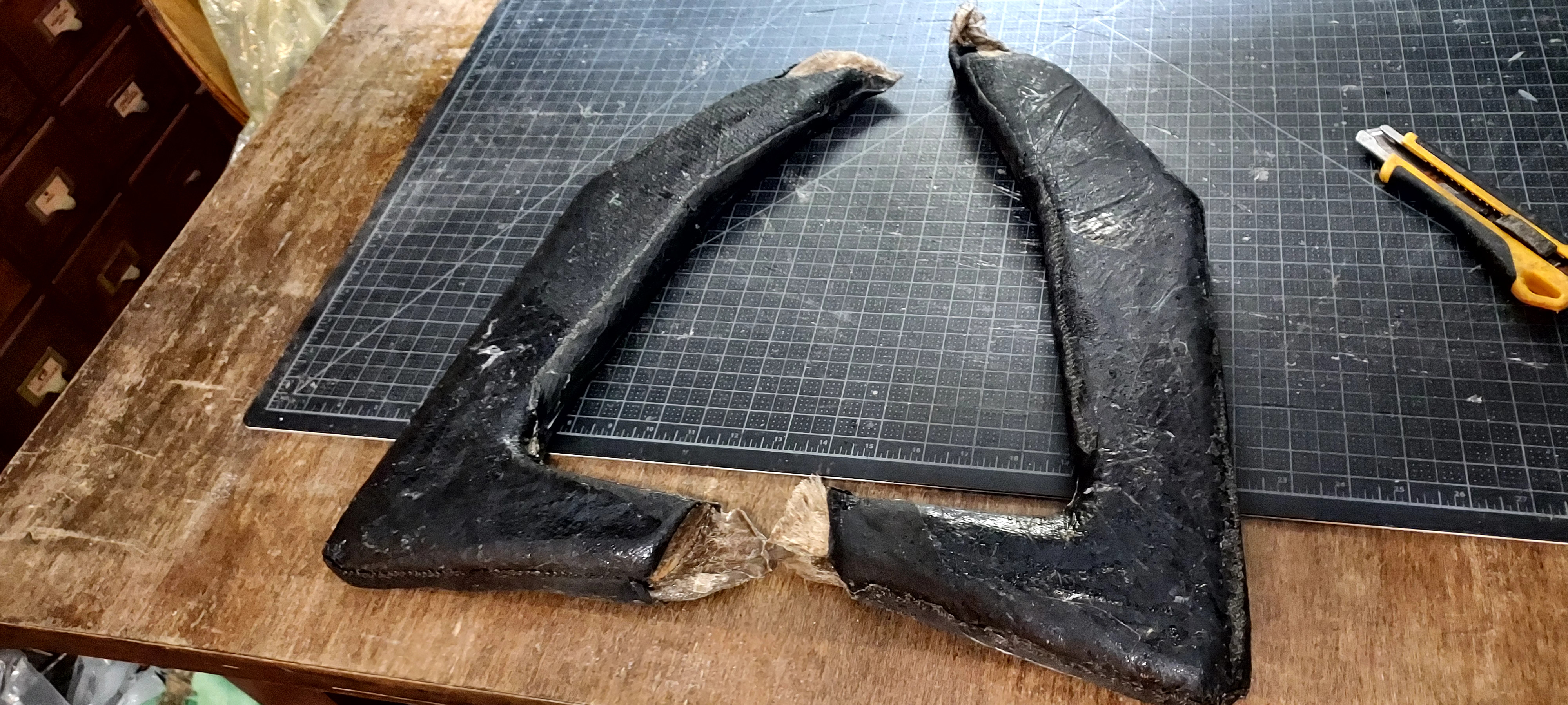

The fork pieces fresh outta the bag. These are the last structural components :muscle:

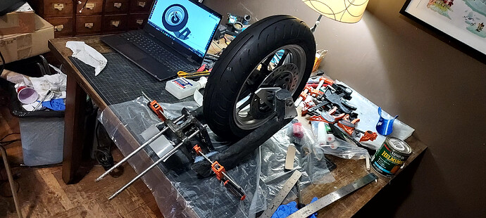

The crown forging is united to the fork arms with my patended method of bolting the wheel on, slapping some levels and straightedges on there, and poking the parts around for about 90 minutes until the glue starts to harden and then you say “ehhhh good enough”
