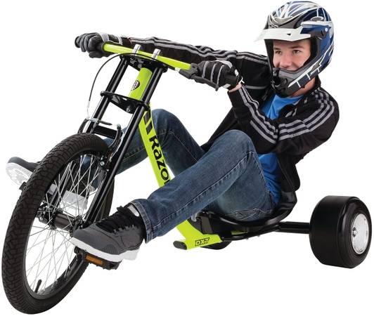

If anyone planned on using the razor as a platform for a drift bike DONT nothing is standard bike stuff, motor don’t fit in forks, head set is non existent it’s a couple bearings, I won’t go on but y’all get the point.
My quick project is not looking so quick now but I’m gonna tread through and make it work.
Edit. After reading nulls write up, if you can get the motor to fit in the front hub none of the issue I am having will be there.

Did you use the frame that @nullblox used? He had a drift trike parts list somewhere but I couldn’t find it earlier.
He linked the razor, that’s the one I had from a long time ago. But the one he build on was a triad which has all standard BMX style front set up.

@Paul77 is this the one you got that didn’t work with the hub?
@NullBlox did you have to widen the fork of the razor frame you used?
Thats the one i have, thats also the one he has, i talked to @NullBlox about it and his motor just slipped in. i checked the description of mine and it states 100MM drop out will work but it does not.
I made an edit to my OG post that states it if your motor dosnt fit like mine then it will be a challange. i tried to strectch mine open a bit but i dont have the right tools.
id say if you want it to work, buy the kit he has linked as its proven it fits. I was just trying to get individual componets when i just should just bought the whole damn kit, i just wanted to try out that flipsky 75100 esc i got.

No need to widen, maybe a little tight fit but nothing where you have to actually
bend things permanently. I cant remember if it was hard to put on but its on and looks
nice.
The Razor fits the Hub I listed, but I believe the true correct size is 110mm drop out.
The Amazon links to a 100mm drop out hub that will directly fit with
the Edrifttrike torque mounts.
We have purchased two of these Ebike Kits.
One is connected to a TRIAD fits fine no issues.
Two is connect to a RAZOR fits fine no issues.
