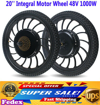

Parts are starting to come in, ESC should be here soon along with hub motor :call_me_hand::call_me_hand:
What is this going into?
The drift trike behind the wheels, getting the rubber tires allows me to either have good traction or throw the PVC sleeves on and have a lot of fun.
